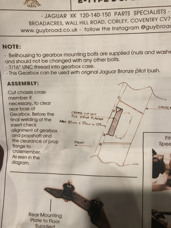

Interesting how the cutout in the Guy Broad instructions is different to the one Joey made.....the infill piece is at an angle rather than 90deg......giveing triangualr "mouse hole" infills.......Steve

Ggjoey1314
The cut out is exactly how they said

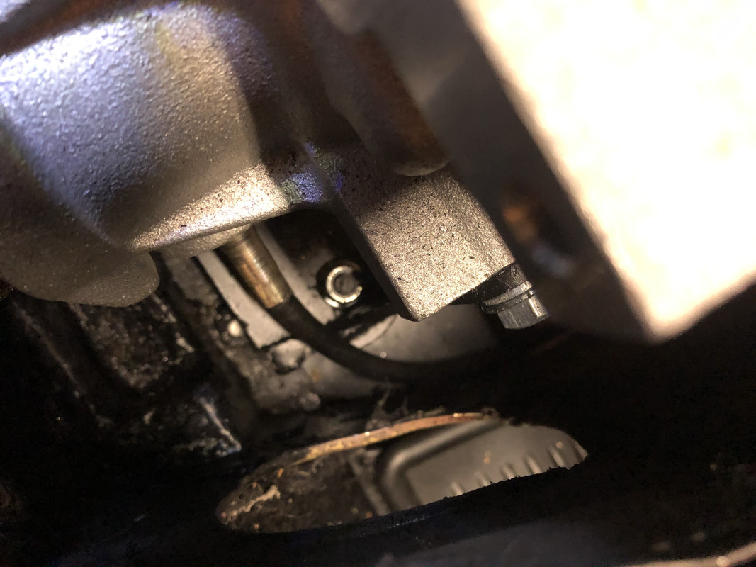

#356 Re: The 5 Speed is here……..
Post by gtjoey » Tue Sep 27, 2022 7:56 pm

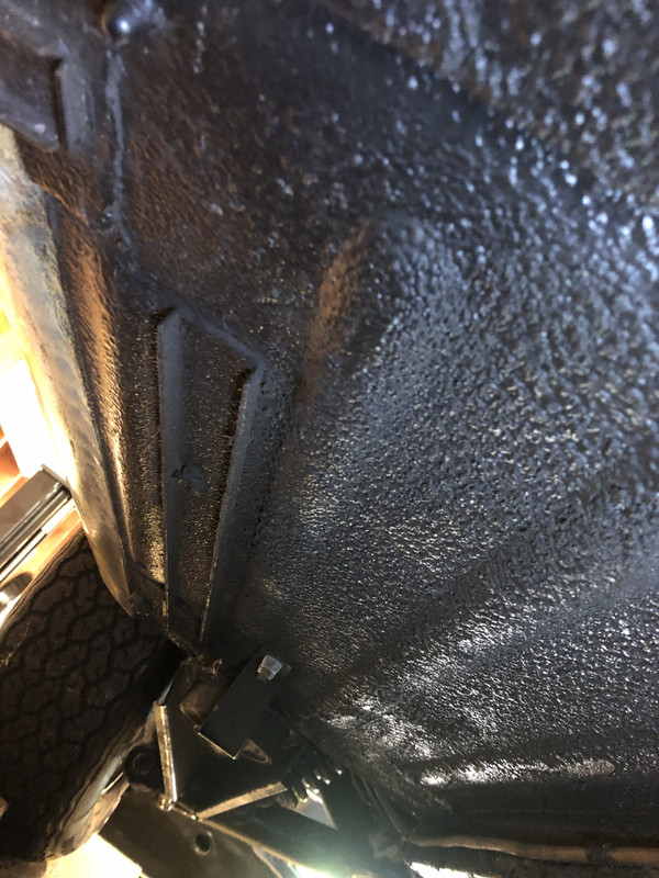

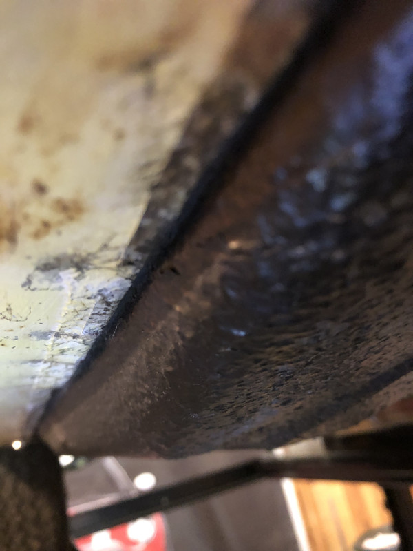

Okay
Let’s go slow
On our Etype coupes we have a
1.Crossmember, It goes from driver to passenger side all the ways across
2.In the center there is a THICK lower steel plate which it is welded to and where your nuts are for the transmission mount
3.above the crossmember in the center is a secondary overlap frame which goes
Side to Side Inside the tunnel area only
4 That is welded Over the first cross member in the middle and to the side of the body inside the tunnel
5 The new improved by a mile Guy Broad lower mounting bracket bolts into the same welded nuts BUT the load is spread to 2 solid rubber mounts on the left and right side of the transmission and plate
6 not that CHEAP terrible center spring bouncing around like a trampoline like the original
So I really do understand Integrity of the metal
But all I’m
Asking is I have a solid cross brace
I have a double lap center brace
I have complete solid outer braces
What situation could make my center section fold with all of the above
I’m never to cautious when I do my projects
As we can see but this car if not rusted is overkill on the structure and that’s why I like it!
These pics make sense?
Those are original floors and seems! I just add undercoating for the snow😀
