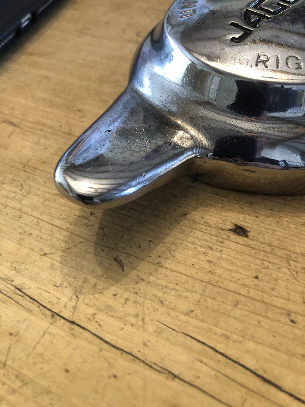

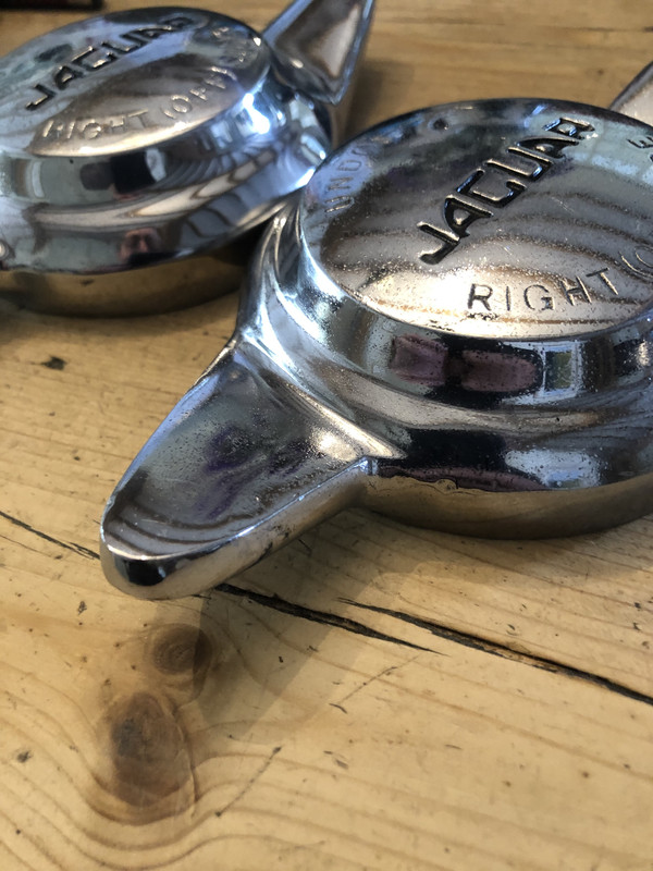

I need advice on spinners for my ‘62 OTS
I have a collection of original spinners which I plan to sort through and have the knocks taken out and rechromed
I am a little unsure as the profiles do vary
They are all 1466/7 AB but some are more “defined” in the profile of the spinner ears and sharper angled where the ears connect to the body
Which is correct?
It would seem that the sharper, better defined ears would be earlier (maybe whilst the moulds were newer)
Any views
See attached photos

The spinner dies wore out over time so expect some variation over the many years of production. Choose a matching set and if you are still concerned measure the weight of each. The specification are:
Height - 38mm (1.5")
Diameter - 101.6mm (4")
Outer wall thickness - 6.5mm (1/4")
Inner wall thickness - 5.4mm (7/32")
Depth from top of wall to bottom of casting - 31.6mm (1 1/4")
Weight - 885gms (31oz)

Thanks David
I think I’m sorted
Bit of “dressing” and good chrominance next methinks

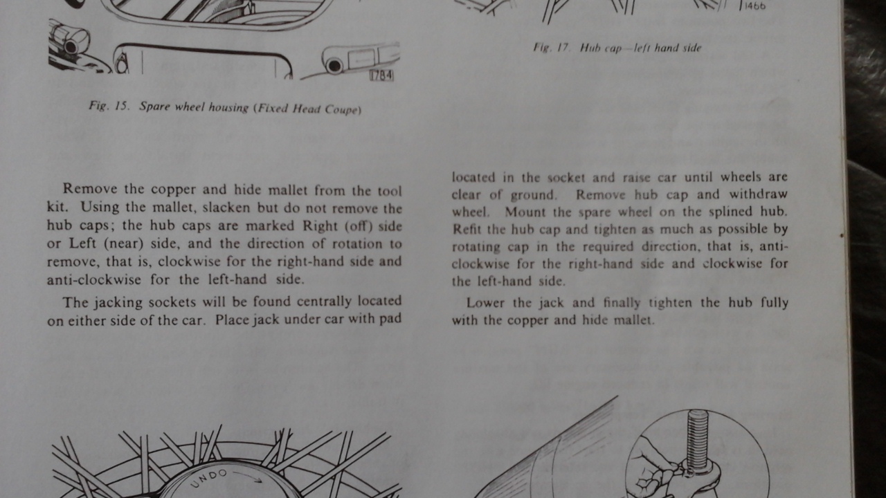

From the Jaguar service manual.....how to fit a wheel....no mention of self tightening or locking....page A15....Steve

As I said Steve, there will those who believe it and those who don’t. But it also does not state how many joules of energy are required to “tighten” the spinner….just some vague description….”tighten the hub fully”, whatever that means without some unit of measure. But as I’ve stated previously…..my bits are MWS and their literature states otherwise. Oh, and the fact that I proved it via experimentation.
I did apologise when I re started the post as I knew it would be controversial

There are a myriad of errors and or, omissions in the service manuals. Just one example is if you were to follow the S3 service manual instructions to the letter, regarding setting the Pre-load of the Pinion Bearings, you would end up with circa 0.5mm (0.020") end float. Then there is there is the shim adjustment of the Output Shaft Bearing retaining plate for compression of the seal. That just leads to the outer race of the bearing spinning in its bore.

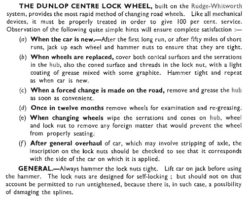

One question wrt greasing the hubs after a wheel replacement and refitting, as per the Dunlop instructions provided by David in the other thread:
The grease advised is "grease mixed with some graphite".
Does it mean that graphited grease is preferred and does it also mean that there would be substantial heat in the area produced by riding the car to justify it?
Why not alternatively simple grease or, better,lithium grease that would have some beneficial anti-corrosion effect in that area?

I just run a small amount of anti seize on the hub spines, nothing on the threads or hub taper. Has worked for three E types over 40 years. YMMV
