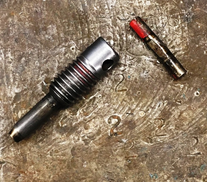

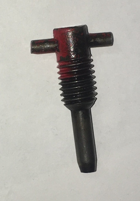

The most horrible aspect of these cheapo engine-cranes, and many other unspeakable hydraulic devices from the Far East, is the fact that the bleed or lowering valve is generally operated by the end of the operating arm.
I see that nothing much has changed in 40 years since my first jack ; you are expected to get this slotted tube over the T-piece, and adjust the bleed by rotating a bit of 20mm pipe two feet long.
They must really think we're stupid. Really stupid.
Here's an easy tweak.

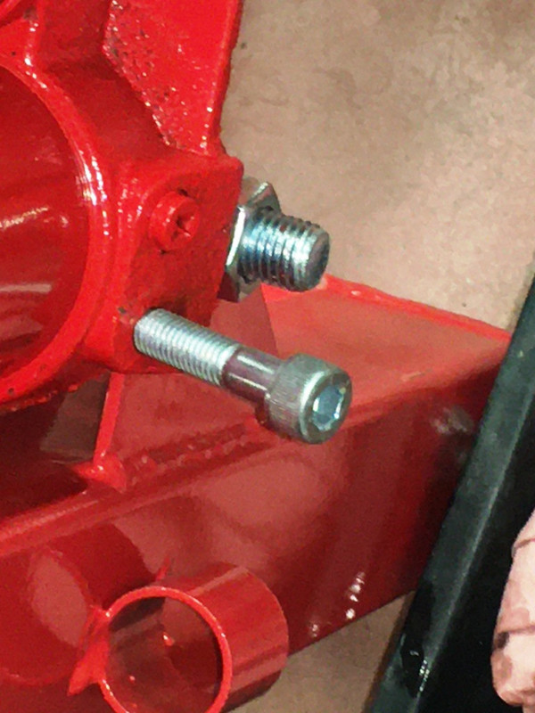

Remove the T-valve and put a bolt in its place to stem the leak.

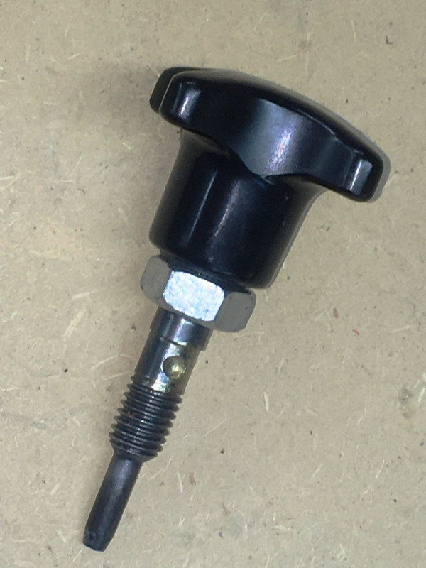

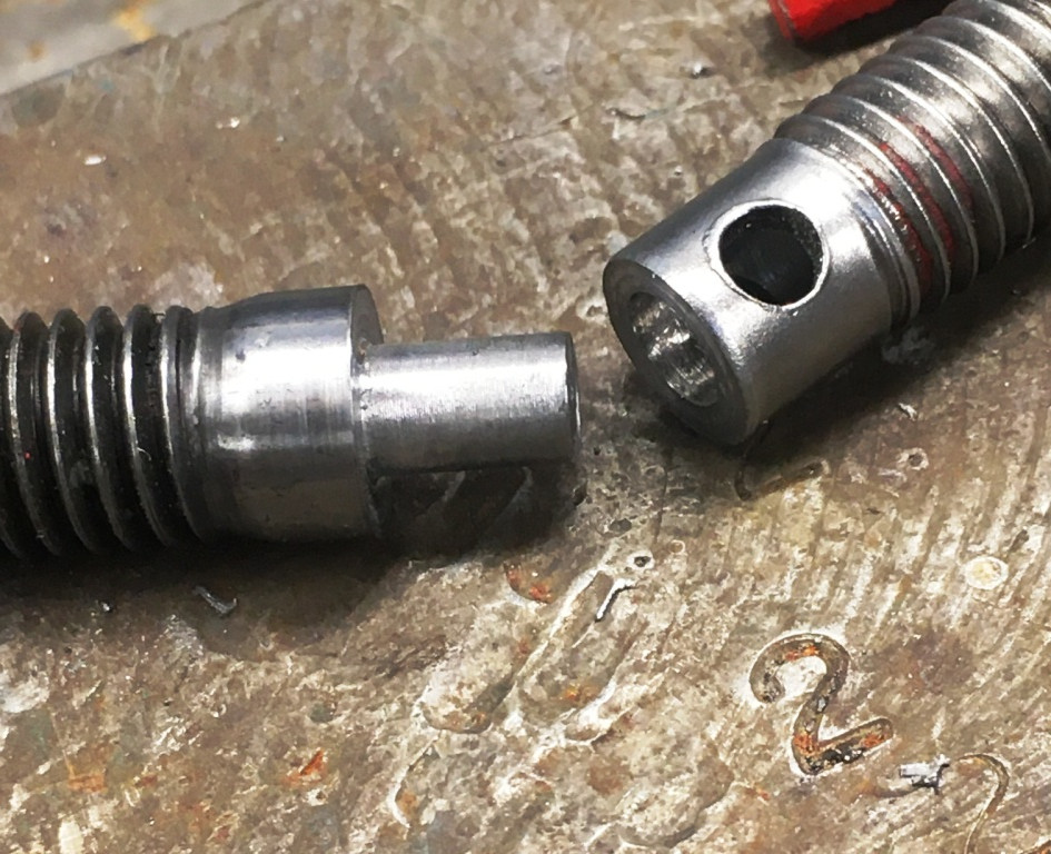

I wasn't wholly confident how the nose of this did the business, and it was surprisingly well machined in comparison with the rest of the junk construction, so I elected to modify it rather than make another, longer, one.
Knock out the cross-piece, and bore a 5mm hole down the valve about 6mm deep.
Turn a nose on a similar bolt - I used an M10 socket-screw with a bit of parallel shank.
Push the two together with a bit of flux and Sif-bronze them together.

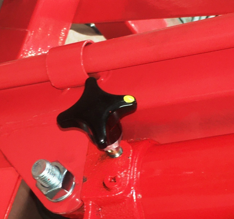

Add a suitable knob.
Should be a million times easier to operate, and also easier to dose more gently.
