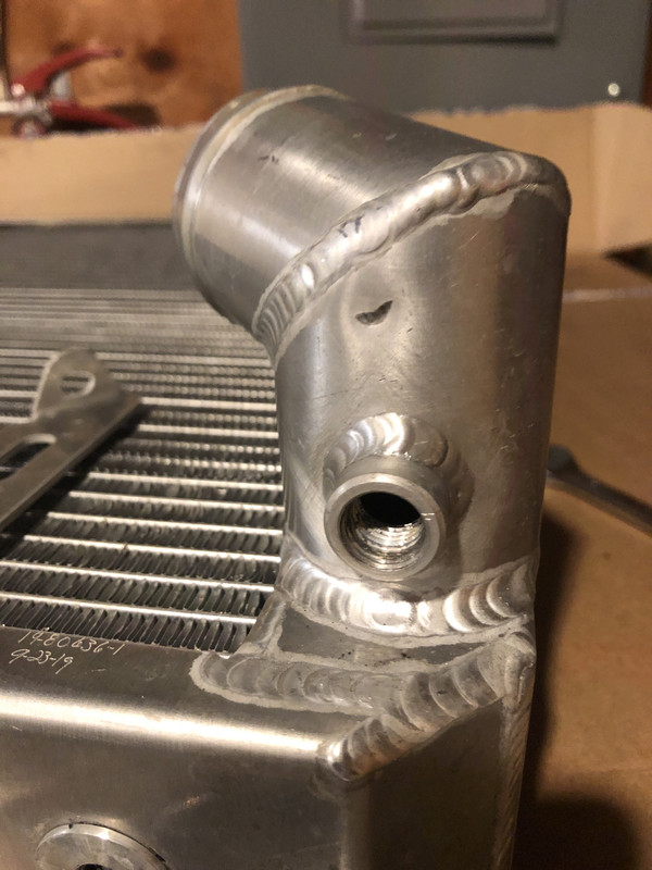

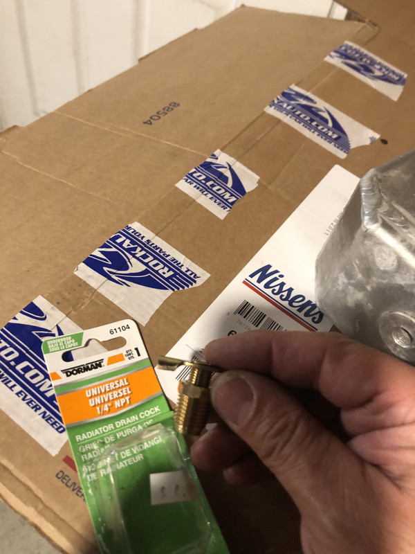

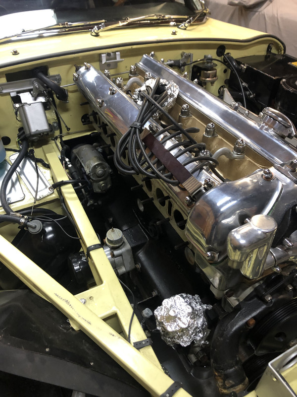

All I wanted to do today was drain the antifreeze so I could take the carbs and intake side out.
But the new Ron Davis radiator drain plug was so tight it stripped the inverted Plug!!!
So now everything had to come out and antifreeze was all over
Tomorrow we tackle the intake
Since my whole family is 300 pounds it’s hard keeping my 195
So even slender working day after day on the cars my hands swelled up and killing me so tomorrow I will be back in the groove!👍🏾
Damn fat Italians❤️
Ps all the nuts and bolts for the header tank, rad support we’re all 1/2
Tomorrow we start fresh after 2 hours clean up of the barn floor👍🏾

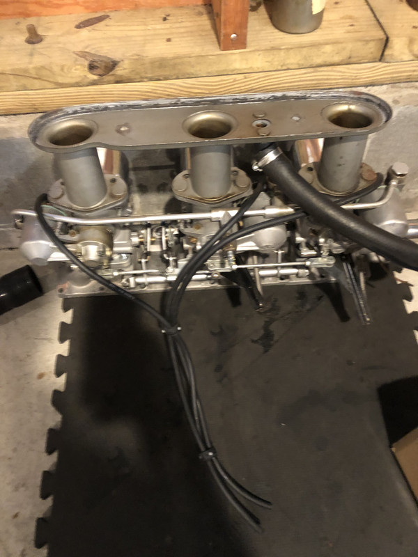

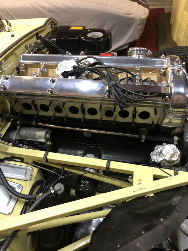

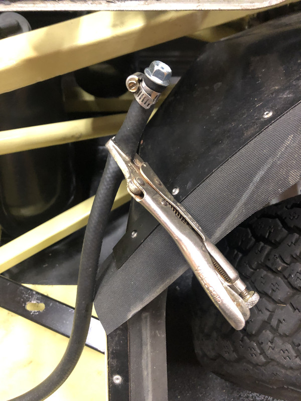

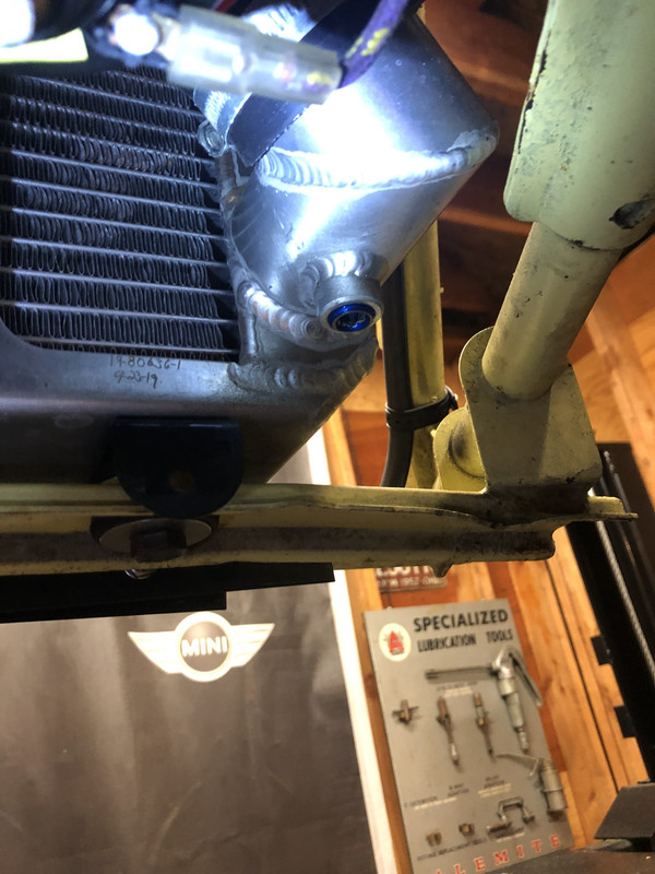

I removed the entire set up in one shot!
Again Thanks to the initial grunt work a year ago from Team CJ this would never have been so easy.
All nuts are half inch
Heater hose
Rad hose
Temp sending unit wire
Oil pressure sending unit wire
Dizzy connections and my special blow by rubber hose which cannot rattle or crack like the original set up!
Tomorrow will be Torsion bars reaction plate only!
Let’s see how that goes….

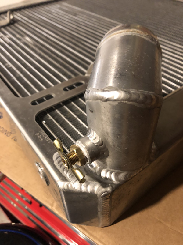

That a boy!
Now that’s how the pet coco should be on a $1,400 radiator !

Joey, where did you get the heatshield for the alternator?
Rob

It’s a series 2 !
All the big places have them
If you want a system that REALLY works
But you cover the glorious manifolds
Use series 2 manifolds with the bolt down and use a series 3 xj6 fuel injected shield
It works wonders

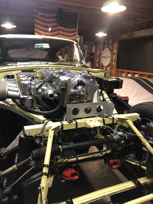

The torsion bars are a real bear.
Like last time I tried to release the sway bar link and shock to drop enough but no good
So I have to take the end link and break the upper ball joint to free up the top bolts!’
This job I hate….
I broke so many things today that I’m just going to rest a couple of days!
It will get done
Pics to follow!

Post by politeperson » Mon Jul 25, 2022 5:17 pm
Joey,
I have found the reaction plate can be difficult to remove unless you slide the whole engine and gearbox forward an inch or 2 to create some clearance.
Then its easy.
Same when refitting it. If the engine and gearbox are too far back, you will be whacking everything with hammers for ages with no result.
