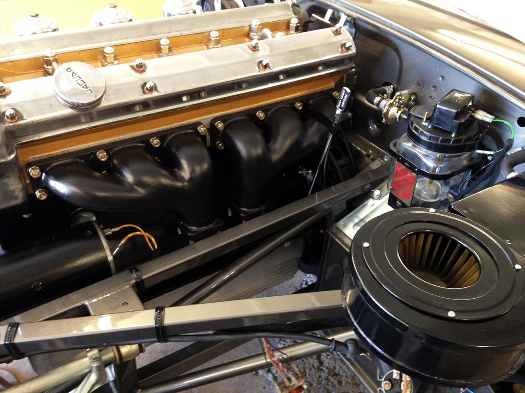

A bit bored, so I thought I'd give the manifolds a new coat of paint. I think they look even better now.

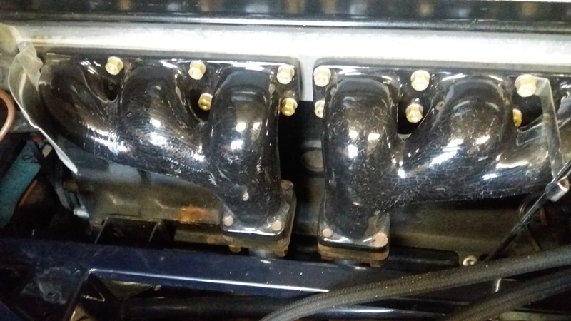

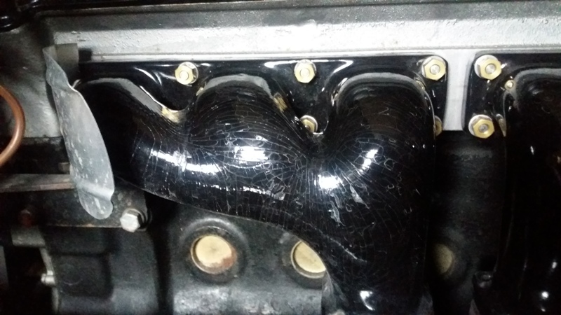

These are mine after about 2 years and 4,000 miles:

Thank you Jerome. Still shiny but quartered, isn’t?

#46 Re: re enamelling exhaust manifolds
Post by JerryL770 » Fri Aug 30, 2019 2:41 pm
Yes, they are quite crazed.
I'm not sure whether that is due to inadequate/incorrect conditioning when first used or water getting on the manifolds when hot - rain entering the louvres under braking, or what.
I suspect the latter is a strong candidate as this can have happened on a number of occasions.

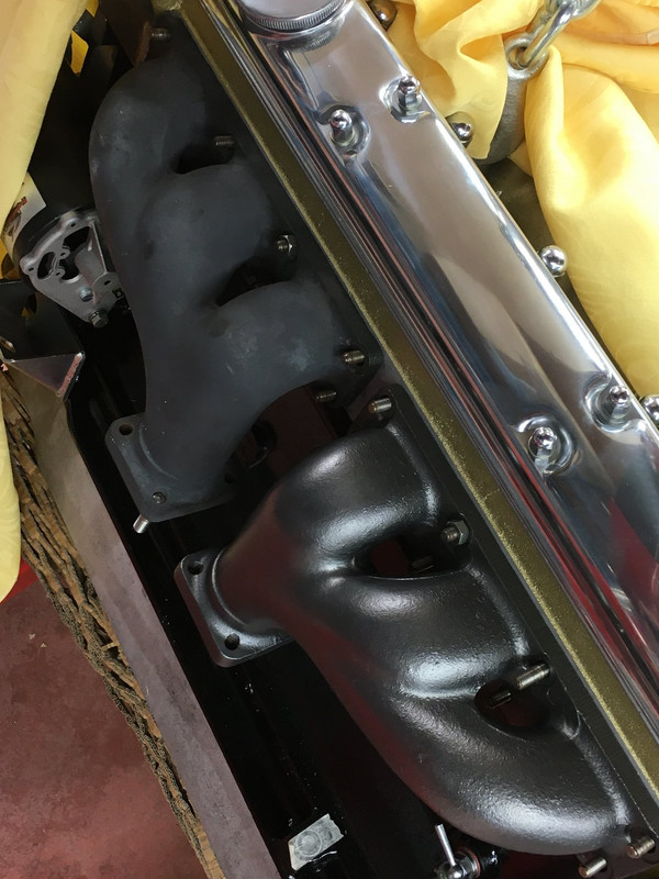

I have just had my exhaust manifolds re-enamelled in high gloss black by Unimet Enamellers in Reading.

Had mine coated in the Jet-Hot coating mentioned previously. Some rain driving.
Dull black but has held up 20 years and still look the same as when coated.

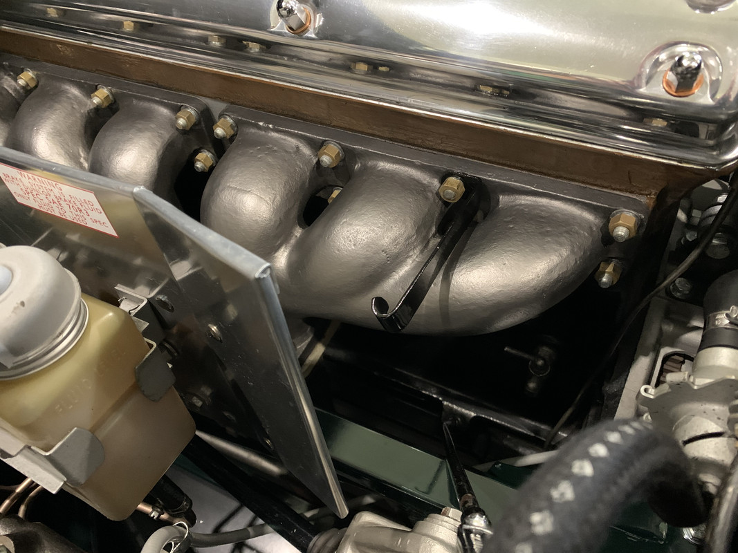

PS Please don't forget the Calyx silver tooth-paste option from Eastwood, via Frost.
https://www.frost.co.uk/eastwood-calyx- ... ating-3oz/
Angus has some on test.
Angus ?
Mine's only done bench-running so far .............
One uses so little of it that it probably works out at below BBQ paint price, and the great thing for the moment is that it's much less prone to show scuffs, marks, discolourations.

Calyx was also covered on an earlier thread (see http://forum.etypeuk.com/viewtopic.php? ... yx#p133177)
I've been very pleased with Calyx thus far. You have to accept that your car will have gun metal coloured manifolds afterwards (which do have a nice sheen to them) but, given many E-Type owners have stainless steel manifolds on their car, I don't think that is a particularly great issue. Certainly better (IMHO) than faded BBQ paint.
