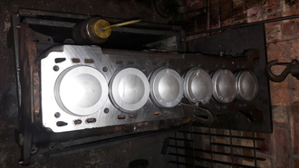

The block has now been crack tested, cleaned bored and decked.
The pistons were +20 8:1 Mahle assemblies. The bores need final honing.
Just bought oil pump, lock tabs, gaskets, seals, core plugs, a clutch, water pumps, dome nuts, valve guides, tappets, cam bearings, oil filter, copper washers, valves you name it.
So my £100 engine is now £1,800ish.

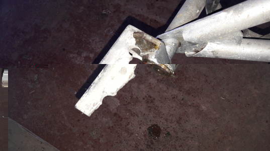

So it was battery off, bonnet off, Fosseway heat shield off, manifolds off, alternator off, 123 tune dizzy out, wheels off, radiator out, steering ball joints split, top ball joints split, anti roll bar links split, cooling pipes and loom off, reaction plate off.
Look at the state of this bonnet bracket. Best not over tighten them?
The reaction plate was tight, the bolts came out OK but on one side the plate interfered with an engine/gearbox bracket and would not clear the torsion bars.
When this bracket was removed it waggled out OK.

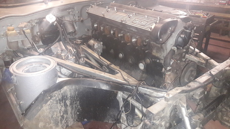

Topic author - Posts: 1388
- Location: Boston UK
#45 Re: £100 Mystery xk Engine Adventure

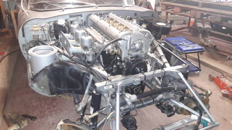

OK progress.
The temporary motor is nearing completion. I know it is a Series 1/1.5 engine in a Series 2, but I don't mind.
Here it is so far, and my frames that are nearly ready to accept it.

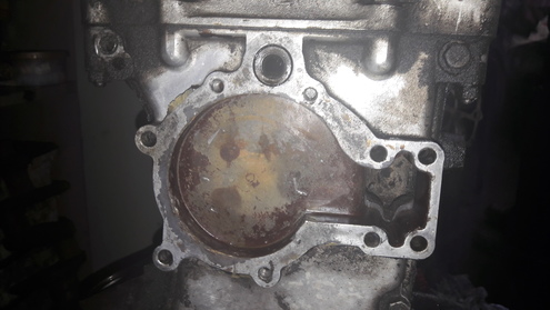

It looks like the correct E-type water pump is now tricky, so I am having to use my S2 timing case for now.
1966 4.2 timing cover So in summary, we have had a +20 rebore, new pistons, bearings, cams, followers, guides, valves, oil pump -10 crank grind.

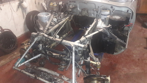

#46 Re: £100 Mystery xk Engine Adventure
A 1966 4.2 timing cover that will only take the appropriate water pump for comparison and a couple more pics.

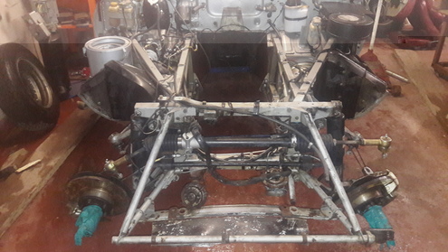

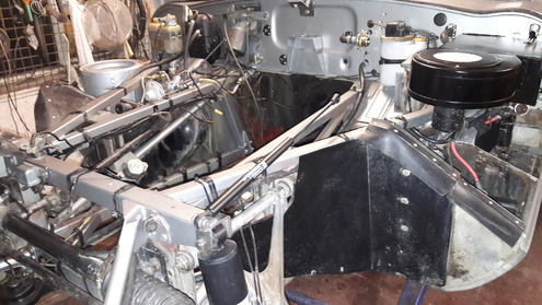

#49 Re: £100 Mystery xk Engine Adventure

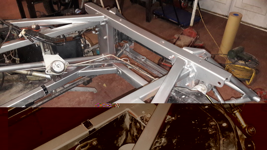

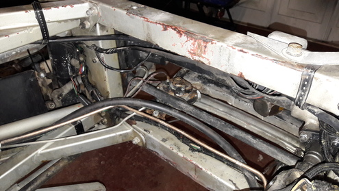

My frames before and after for comparison
Before
After
Before
After

#56 Re: £100 Mystery xk Engine Adventure
Merry Christmas.
I picked it up, and put it in.
On the way I fitted the starter, filled the gearbox, attached the clutch slave and the inlet manifold.
Quite a tight fit I would say.
All scratches avoided.
Not particularly easy. How they did 100,000 of them beggars belief.
James
James
