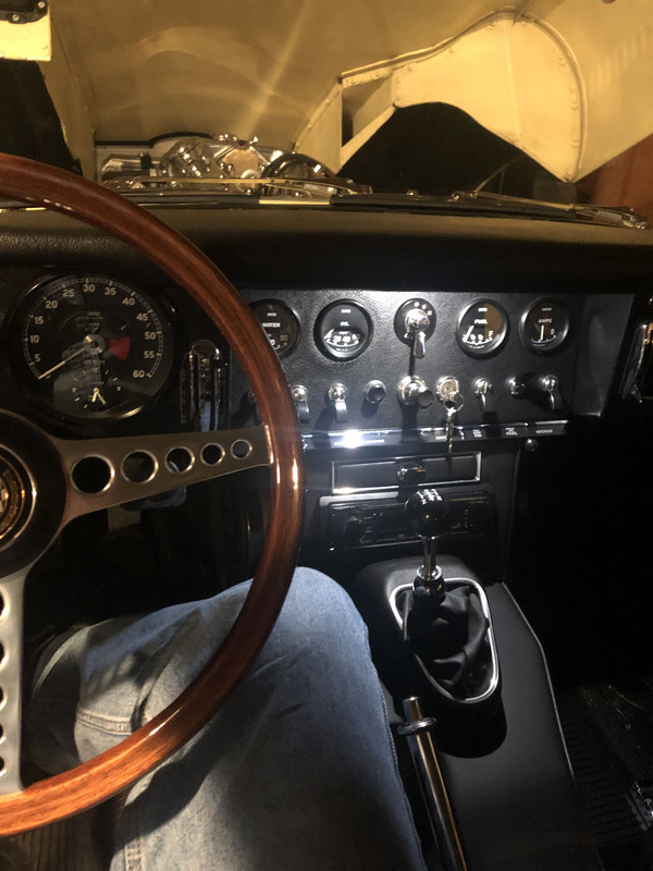

Now! It’s all done ….
LED lights , console in and the NEW , SNG ledger bar is ten times better then their last repro!
Enjoy guys! Videos soon!

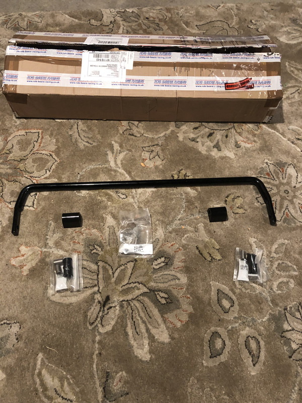

To Really button up the job
I have trusted Rob Beeres with many upgrades that never fail, SO far.
Here is one that should wrap up the suspension
7/8th front sway bar
Stock in the rear
Just to take out the float in the turns
Posts: 15204
#529 Re: The 5 Speed is here……..
Post by Heuer » Fri Oct 28, 2022 11:19 am

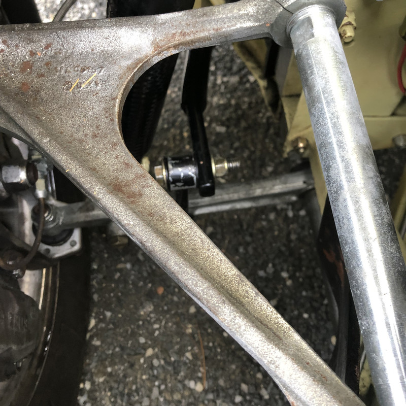

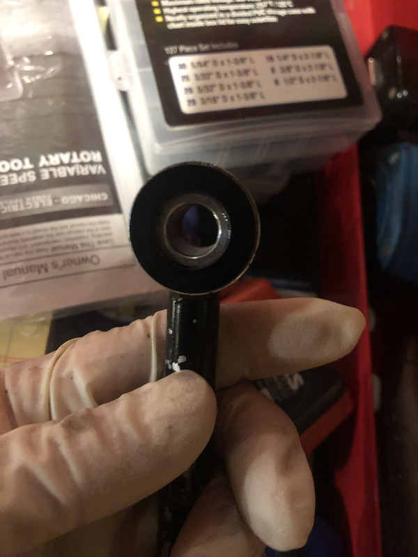

gtjoey
Posts: 604
#531 Re: The 5 Speed is here……..
Post by gtjoey » Fri Oct 28, 2022 7:36 pm
Well
Alpine passes maybe we go😃!!!
Just installed the bar.
With the gas adjustable bumped up one turn to 3.
The sway bar makes the turns soooooo flat.
Great Great Great addition!
It’s the quality of the parts once again
Poly bushes with a collar so now the bar and dog legs DONT clunk!
This thing might be going on a world trip!
The New sweet spot is 60 in 5th at 2,000 rpm on the nose
It’s a Lexus it’s so quiet but Strong not bogging.
Tomorrow I get the Mangoletsi kit but that’s another thread👍🏾
The transmission and full stats once the car is agligned
