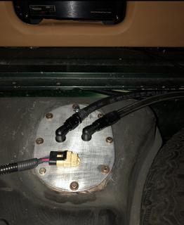

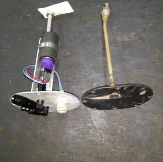

69E4.2FI
Posts: 9
Joined: Sat Nov 17, 2018 3:17 am
#67 Re: Fuel Injection Jenvey Throttle Bodies
Post by 69E4.2FI » Sat Nov 17, 2018 3:17 pm
No LP SU pump, no external HP pump, no swirl pot, just use one internal(in tank) high pressure pump.
Used the wiring and relay supplied by emerald for the HP pump. The HP Pump is in the tank its very small see above. The fuel pump is 255 racetronix’s pump. I also changed all the HP lines to black Vibrant performance braided race lines and fittings.

#68 Re: Fuel Injection Jenvey Throttle Bodies
Post by 69E4.2FI » Sat Nov 17, 2018 4:28 pm
Here's the cold start, before I changed the fuel pump delivery system
ianc9
Posts: 60
Joined: Wed Jun 22, 2022 7:55 am
Ireland
#69 Re: Fuel Injection Jenvey Throttle Bodies
Post by ianc9 » Thu Feb 02, 2023 11:02 am

Posts: 1387
Location: Boston UK
#70 Re: Fuel Injection Jenvey Throttle Bodies
Post by politeperson » Sat Feb 04, 2023 6:30 pm
Hello Ian,
I can try and get pictures of the return line.
It basically runs from the engine fuel regulator along with the main feed using the original route and P-clips.
It then goes over the IRS through a grommet or bulkhead union to the boot the into the tank through an additional hole in the fuel feed plate on top of the tank.
Modern submersible fuel pumps are often contained within a little "plastic bucket" so a swirl pot is not necessary. They are often also suspended from the top of the tank, sometimes on rods and springs. As long as it provides around 50 psi, any of them will do. The last one I used was for a Ford Galaxy. It was pretty easy to adapt it to fit the fuel feed plate that bolts into the top of the tank.
Forget the original fuel filter, the increase in fuel pressure would give it all sorts of problems.
