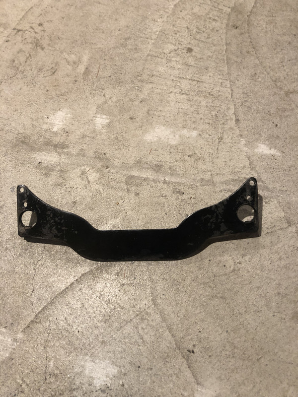

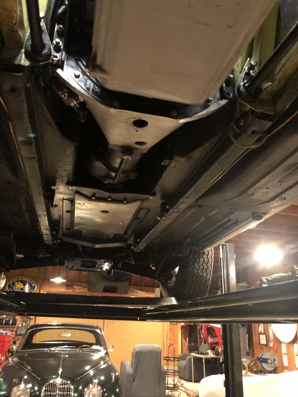

Post by gtjoey » Fri Jul 29, 2022 4:17 pm

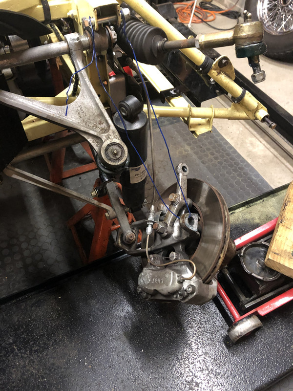

I always heard that the bolts just tap out with slight reverse pressure.
That’s never worked for me.
I want to sum up this step…..
It’s a total pain in the ask!

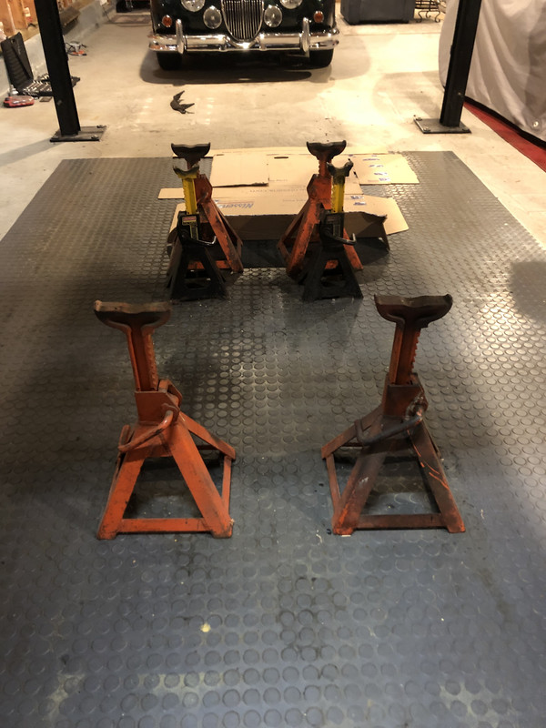

As I dreaded I raised both wheels then removed wheels
Broke both upper ball joints and tie rod ends with another support under the hub.
By breaking that pressure I was able to just slide the bolts back and forth
Then pound out the plate with the hammer.
Disclaimer ……..
I never suggest how to support or raise the car.
I get crazy as you will see I use 6 jacks plus the flat ramp plus a picture of Jesus on the wall just in case!
I’m having fun but if your not into blocking everything else out of your mind
Leave this to some one else
Now the fun begins
By tomorrow the engine should be stripped to be dropped😀👍🏾

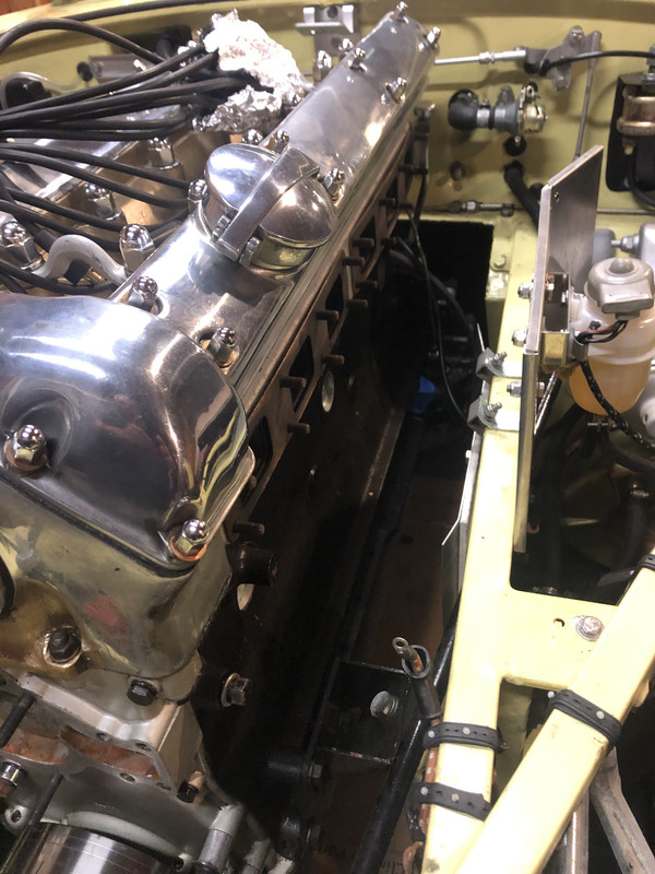

Is your rear main always so clean? What type of rear main seal are you running?

Thx Joey,four stands on the ground look interesting,I managed to get the passenger side bolts out using the tapered punch (drift) method,driver side not a chance,had to break all the joints so the lower control arm(wishbone) could swing down.Reassembled the drivers side so that the car can sit on all four wheels when I drop engine and transmission,I have the same four post lift as you Joey,having driven my car for 31yrs with the built in rust proofing system,I had a dirty oily mess to deal with under there,definitely the reaction plate from hell
Regards Gerry 62 Ots Ontario Canada.

The underneath is bone dry due to the cut crank and modern seal and a check to Classic Jaguar for a nice amount😀

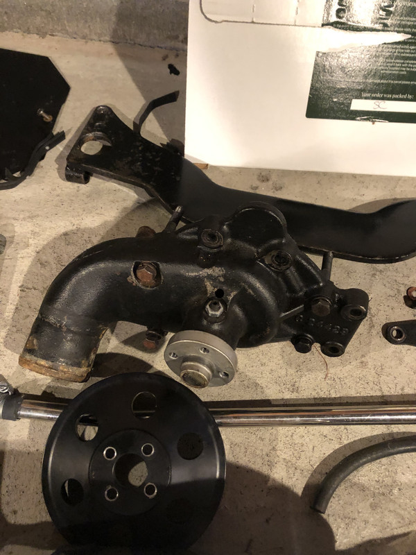

I’m going with the Rob Beeres bleed kit for the clutch.
His rear end kit is the best and the pulley kit!
With the pump out again has anyone gone aluminum?
Is there a high column water pump?
More to come!

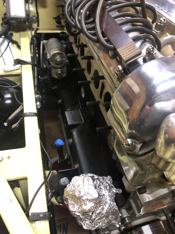

Post by gtjoey » Sat Jul 30, 2022 1:19 am
I will clean up
Get the interior out of the way
Then next weekend drop the motor.

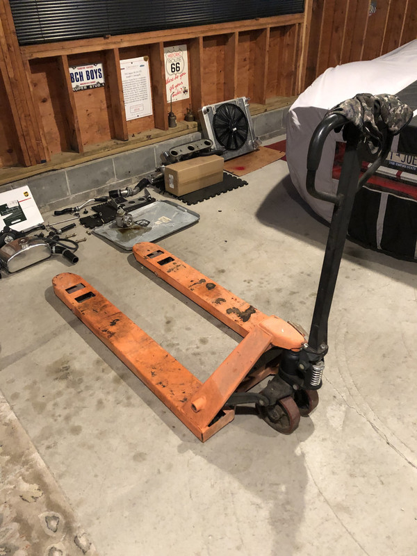

I have an old palate Jack
It will be fun pulling out my old wooden box😀
P.S. Boy all the crap on the floor is adding up! :bigrin:

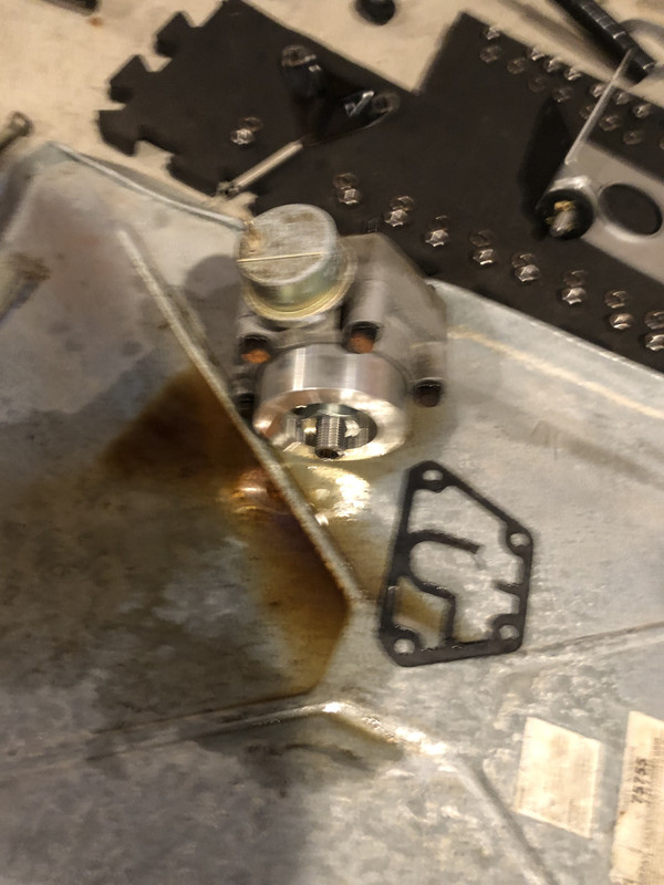

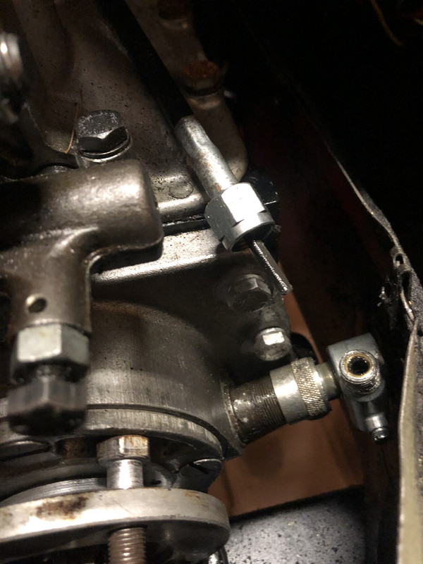

Recap before we tackle the interior today.

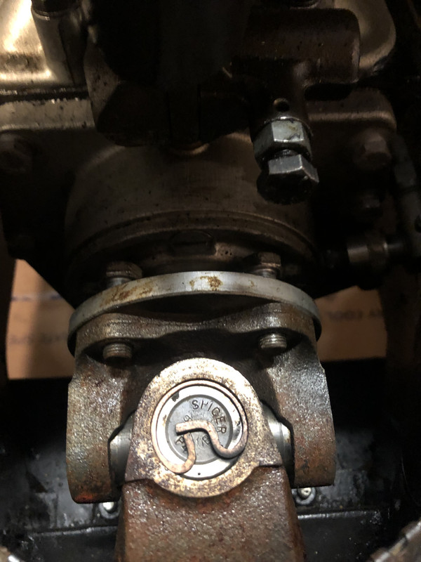

After the Reaction plate
The oil filter housing along with the clutch line ,oil temp wire are all cleared for engine removal.

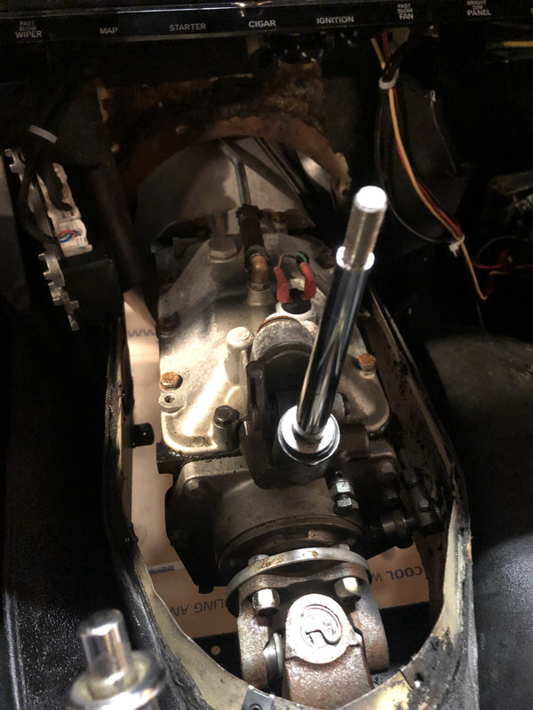

Today we take the center console
Take a break then take the prop shaft bolts out, push back the shaft from tail of transmission
Then next weekend we drop everything out
More pics to come today hopefully

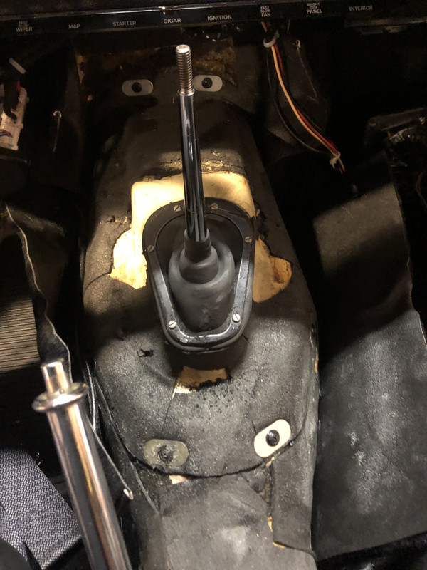

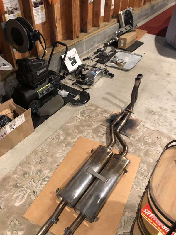

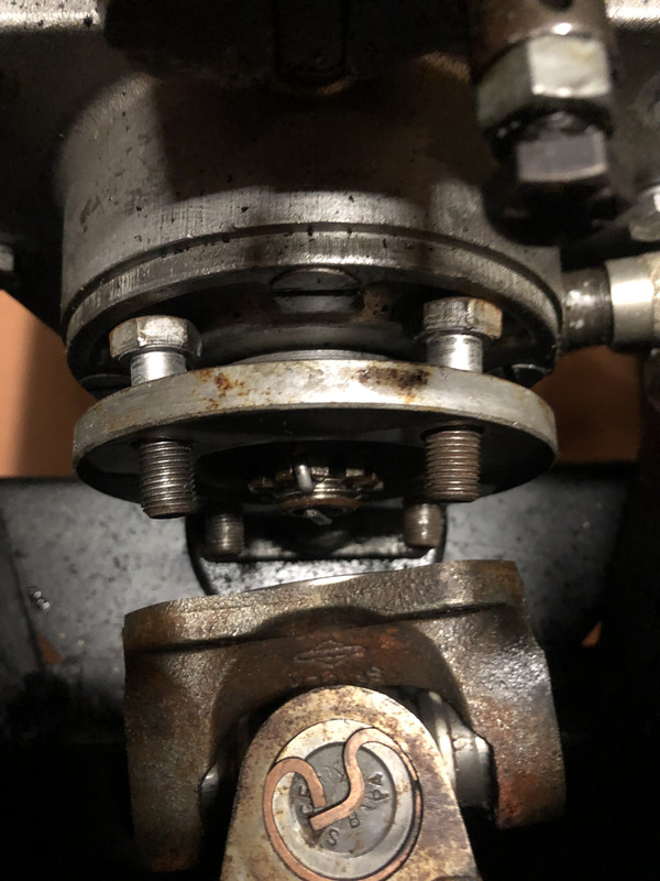

Post by gtjoey » Sat Jul 30, 2022 6:59 pm

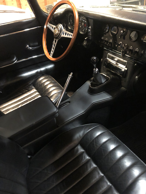

Today was great removing the…
Radio stack. 2 screws
Center console. 2 anchor bolts holding seat belts
Remove the tunnel cover
Remove the two reverse wires
Remove the speedo cable
Take off the 4 prop shaft nuts and push back the shaft
I’ll post more pictures of the above process to follow
Next week the whole unit is out!
