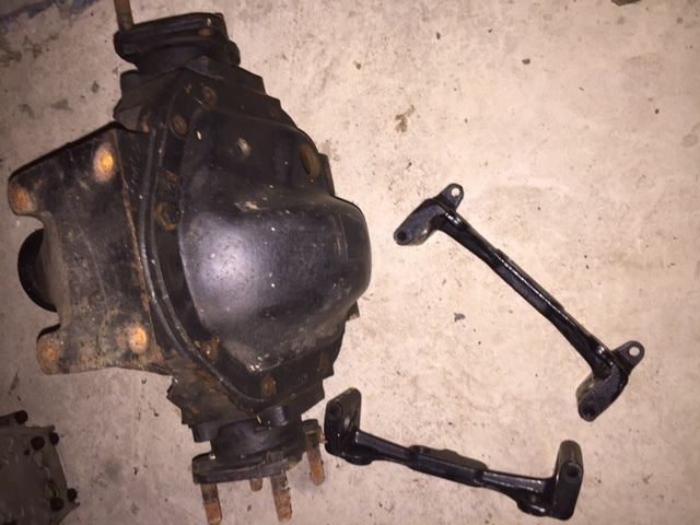

Maikel,
I am unsure of the part number for the early 3.8 Inner Fulcrum Mounting Brackets, but as you can see in the photo below, they are a more "delicate" casting with the addition of the extra lugs which bolt to the Lower Bracing Plate under the diff and are less "chunky" than the 4.2 Brackets. You believe you could use the later brackets once they are shimmed to suit the mounting cage, provided the mounting cage holes for the shafts can be aligned, but these don't have those extra lugs which I suspect Jaguar deleted as unnecessary on the later cars as the Bracing Plate is located with numerous bolts. Incidentally, I cribbed that photo from Ebay listing for a empty E type Diff, (but offered with the all important - and perhaps now much more valuable - mounting brackets), which finished this week - just type in "E Type Diff" and click on Sold Listings.
All the 3.8 and 4.2 E types used Salisbury Diffs and although I know about the internals on the later Dana diffs and their difference Pinion flange to the Propshaft, I'm uncertain on the external casing and would not expect a Dana to have the same external dimensions and mounting configuration to suit a 3.8 or 4.2 E type mounting cage.
As regards the Distance tubes, these do vary in length depending on what Fulcrum bracket is fitted in what vehicle application, and the correct tube needs to be matched to the bracket being used to keep the dirt out of the shafts, seals and bearings. For example the XJS uses a different bracket to produce a different angle for the pinion nose relative to the horizontal, so the tubes match the gap between the two pivot surfaces on the respective bracket design.

Dave,
Thanks very much for that info. I'm assuming that perhaps the casting was changed to enable them to be used in various models but with the locating holes machined in different positions to suite the car or cage they were going into.

Hello Dave,
I have seen that foto on Ebay. I am not sure but those brackets and diff. case are looking different to my.
The bracket seems to have one one hole near the center as the brackets I have seen do have two holes in order to use them on both sides. Those brackets on the pic can used only on one side each right?
Also the diff I have seen do have a little bit visible "platform" on each side where you mount the cage to the diff. On that pics it looks a bit different.
Am I wrong. The rest what you can will be right. I just wonder if those brackets would be correct for 3.8 and/or 4.2.
