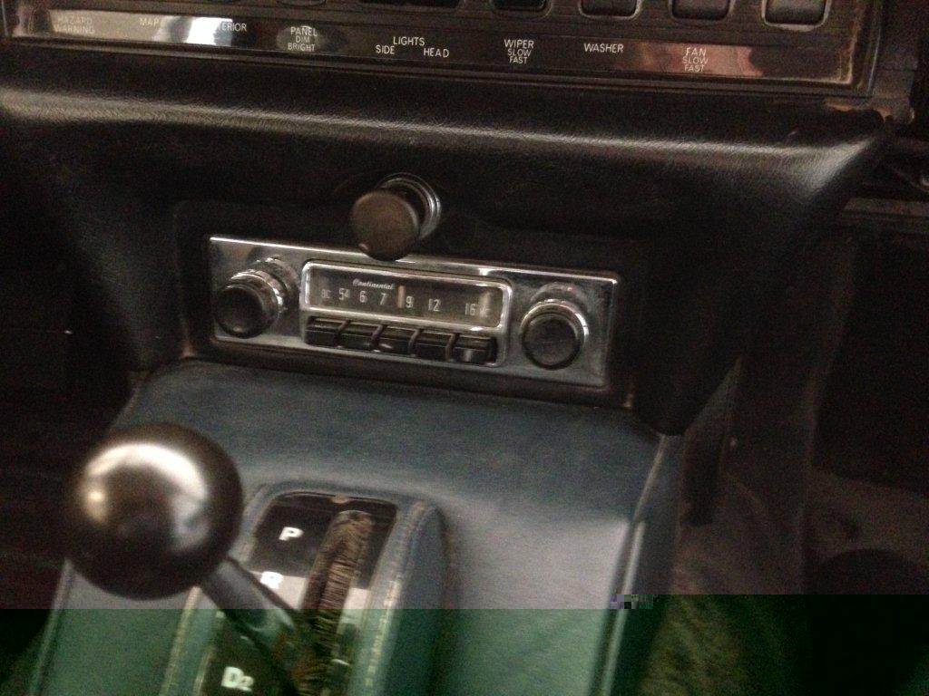

Does anyone have any advice on getting an old continental radio working or how to remove it please

Hi Bernie...you will have to remove the radio console.....not sure on an auto car but you may have to remove the center consol first.......once out pull off the black knobs and the silver retainers...then under them will be 2 nuts ..you may fave to pull off the facia....should be easy once the console is out....If your lucky the radio might just slide in....so pull tne knobs first and the facia and nuts and see if it comes out

Thanks Steve will try it later today
