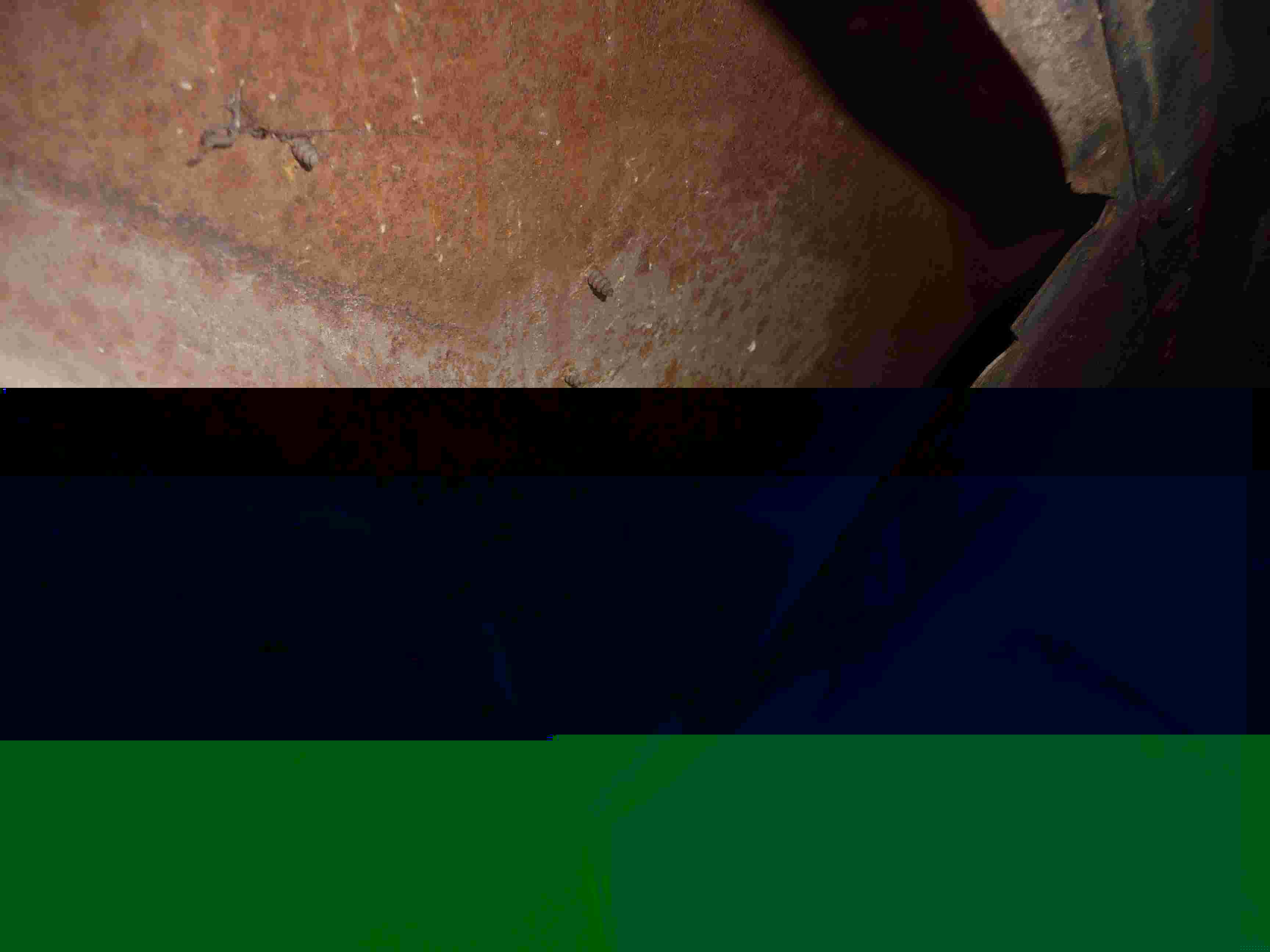

#14 Re: Surprise under bonnet: rubber air duct
Just checked how it stands behind the rubber.
Not too bad, fortunately:
It should be repairable by welding two metal sheets, a flat vertical one and another on the bottom closing the tunnel: there are still metal edges that should allow overlapping and welding of the new sheets.
The shape may not be perfect but I hope good enough.
Wait and see when the time of the new paint comes...

#18 Re: Surprise under bonnet: rubber air duct
Ralph and Steve, you are probably right, I don't see why it would have been cut otherwise.
Paul, thank you for the photos, the valance was unfortunately cut on an area where the lower metal sheet has a number of folds, not easy to form from a new flat sheet...
Here are detail photos showing how the metal was carelessly cut and bent.
It will have to be straightened (plyers, hammer?) to prepare for a correct welding.
I don't know if that work better requires putting off the whole inner valance from the bonnet or if it could be done in situ...
