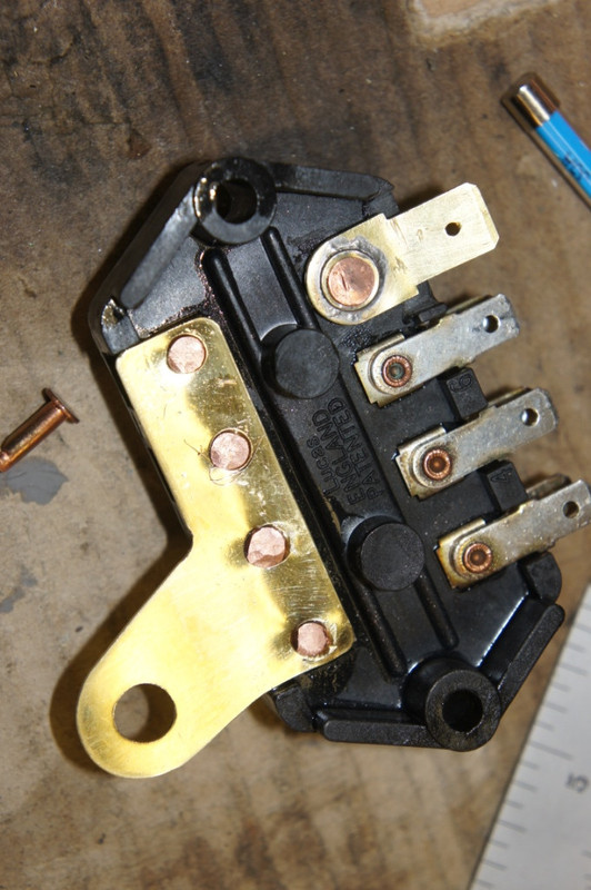

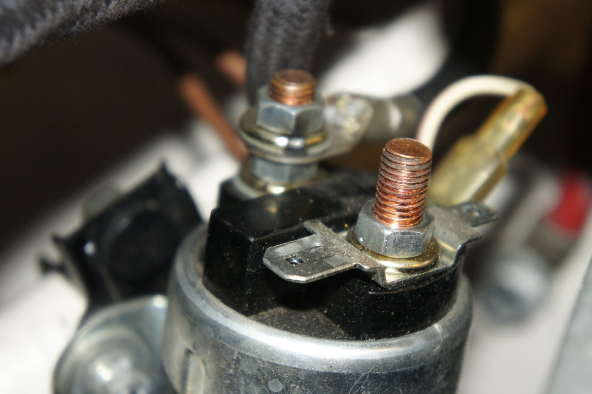

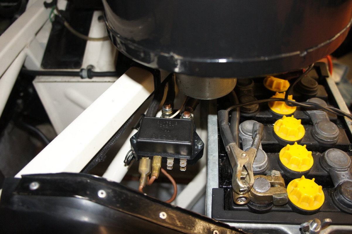

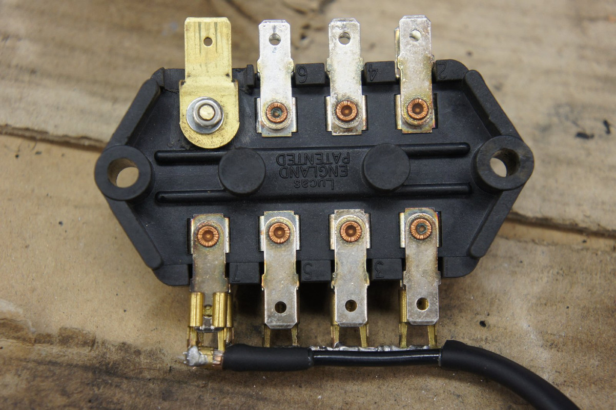

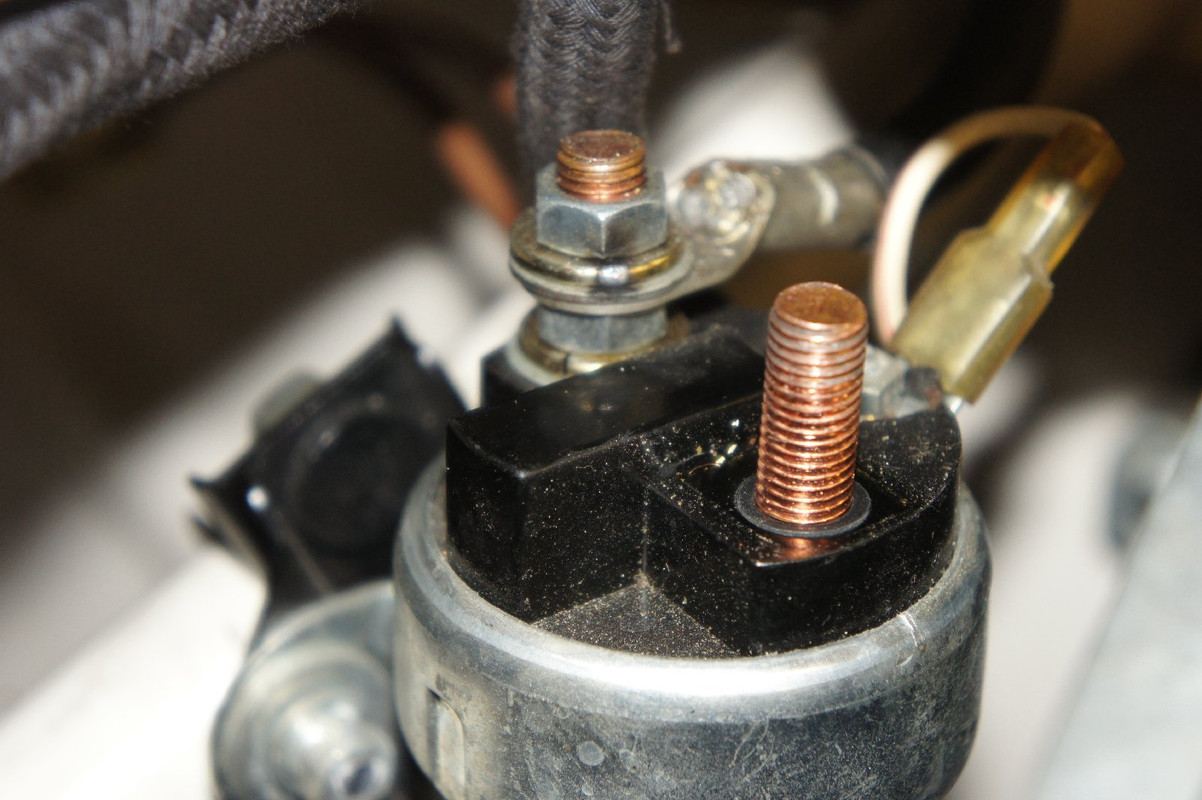

Fusing the feeds to the new headlamp relays was going to need 2 new fuses, so I went for a Lucas 7FJ 4-way fuse box (genuine original easily found on Ebay) and resolved to pass both of the non-fused brown main-feeds to the dash through the other two ; the best place (neat, discrete, accessible) to mount this seemed to be right on the solenoid terminal, by making a sort of bus-bar out of brass and riveting it behind the fuse junctions in place of the original spades.
In this way the feed to the fuses is as direct as possible, one fuse (35A)protecting the brown that goes to the ammeter, the second (10A) the brown that feeds the fuses ( N°3 and N°8 ) that don't go through the ammeter, neither of the standard brown cables or their terminals needing any modification, the third and fourth fuses (35A) being the main and dip relay feeds.
Initially I had run it for a couple of hundred km of testing with a jury-rigged bus-bar-cable, followed this with a mock-up out of thin zinc, then made the definitive version out of 15/10 brass sheet - trying to get the angle right so that the fuse-box sat square in relation to the battery and the rest of the car.
The ammeter feed needs a 3/8" flat spade riveting in place of the 1/4", although it would have been easier and probably better to just use 2BA brass screws throughout instead of rivets ??.. but I got shipwrights' disease.

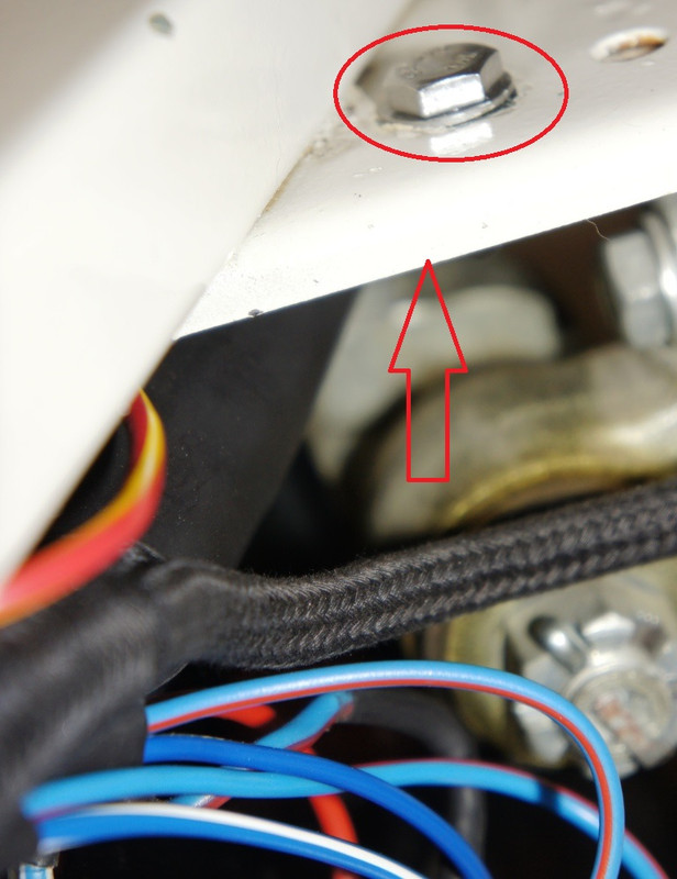

Better Bonnet Earth
Given that the earth connections run as largely invisible wires within the harness, I decided to belt-and-braces the earth to the bonnet by using the famous damaged red-yellow wire as an extra earth, whose routing I understood and could follow, and got a good earth-post into the front chassis-tubes via the bolt that holds the front valence bracket, after the requisite scraping and Waxoyl/WD40 application.This obviously involves cutting the red-yellow at this point, but the remaining section that goes within the harness up to the lighting-switch will come in useful another day for some added but discrete function.
