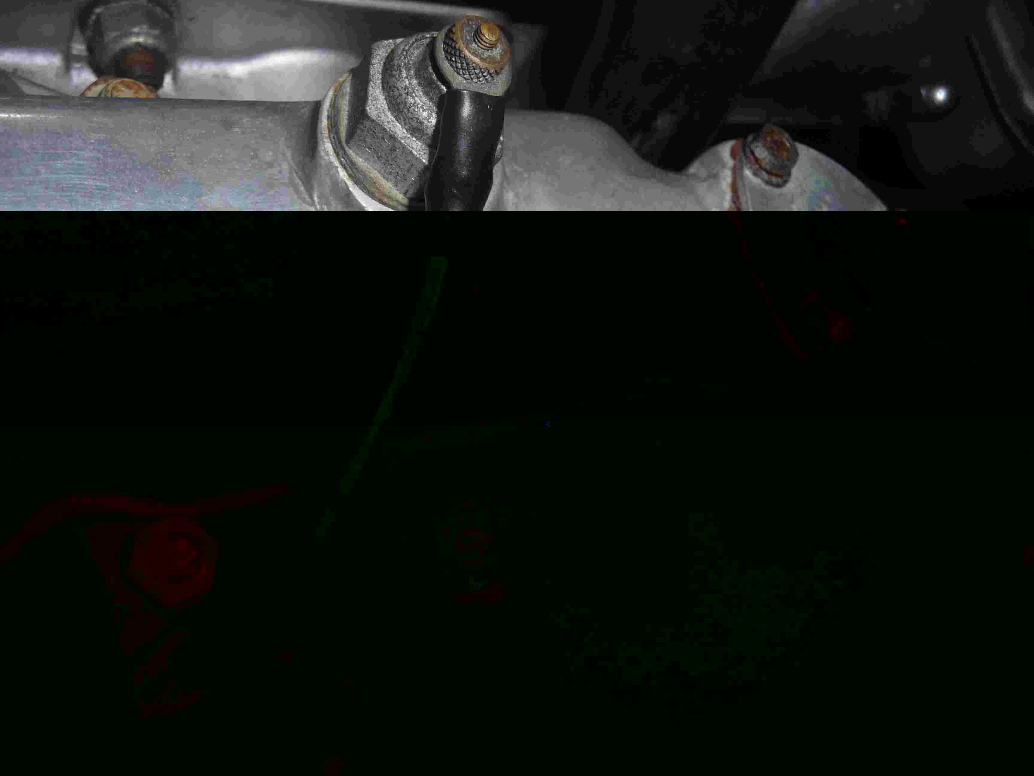

I also am confused with all these specs, models, OEM or repros.
I have an S1 3.8 and I intend to replace my thermostat while doing restoration works on my cooling system.
I have not yet opened the thermostat housng but it looks "standard" for the 3.8 engine.
When I look at what SNGB offers there are three different thermostat models for my car:
- C3731/1* which is presented as a repro 70-75°C;
- C27650 whisch is sold as "standard" 74°C; and
- C27650 which is the OEM 74°C.
Funnily, the OEM is the cheapest, then comes the standard and the most expensive is the repro!
I am tempted to purchase the OEM of course but can anyone confirm that it's the right one as all the models presented have a different look.
Please advise

#5 Re: Thermostat (again)
Post by mgcjag » Sat Feb 03, 2018 9:10 am
Hi Serge.....everything you need to know about thermostats including some good diagrams on how they work..viewtopic.php?f=3&t=8478

Post by ralphr1780 » Sat Feb 03, 2018 9:56 am
Serge, have you been facing heating issues or suspecting that your thermostat is not working properly?
The one I have fitted on the 3.8 to replace the wrong one found during resto is the waxstat C3731.
Car is not yet on the road, but static tests in the courtyard with IR gun lead to believe that system is working properly.
Ralph

Post by paydase » Sat Feb 03, 2018 12:52 pm
Tank you for the useful comments.
Steve, I had read the thread you linked but it is quite complex to understand what is what at the end...
I will read it again.
Ralph, thx for the advice and good idea making IR tests. Who knows, maybe my thermostat is still good ;)
