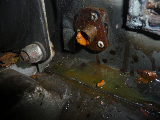

In parallel to my heater box restoration now being addressed, I observed during its removal that the ends of my metallic heater pipes behing the bulkhead are totally rotten (corroded and obstructed).
I need to consider what to do now, knowing that replacing these pipes with new ss pipes provided by the usuals is a pita.
I found a couple of previous threads on the issue but with no details on how to actually proceed.
Is this a feasible work on a car that is not an empty shell?
If so, what are the openings to be used to insert new pipes and having them aligned and rightly inserted in the holes for riveting?
(I wouldn't like to remove the windscreen and/or the whole dashboard)
As an alternative, is it easier to route new hoses or tubes behind the block in the engine bay and to have the heating valve suitably connected to the cable mechanism coming from the dashboard?
Any advice again welcome

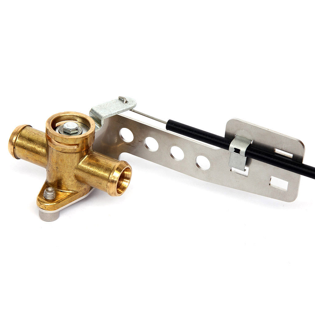

After having seen the following video on jaglovers, I don't feel confident to engage in that job:
John, thank you for the tips.
I have looked at the inline heater control valve model you refer to and have seen mixed feedbacks, maybe the plastic kind of construction.
I have however found a brass model that seems quite robust, with a possibility maybe to use the current valve attachment holes on the firewall, and a command by a bowden cable that I may suitably route with a 3/4 turn loop of the cable above the heater box to also use the existing command hole in the firewall.
This model exists in several diameters and push/pull configurations (pic attached)).
https://www.ebay.ie/itm/Brass-Heater-Va ... 2031068354
A few additional questions:
- seems to me that all the metal pipes of the heating circuit (from the exit of the inlet manifold back to the return rail to the water pump have a 12-13 mm external diameter, so would a 1/2" diameter valve (not 5/8") be the correct one?
- should I take the push to close or pull to close model (could not verify that yet)?
- do you recommend making preferably mostly a copper piping circuit in the engine bay or alternatively mostly using rubber hoses (this may be easier to route if flexible enough but I have not found that kind of hose sold by the meter by the usuals)?
Finally I do not understand why in your current system that loops the back of the inlet manifold to the rear of the water pump you need to use a heater valve to regulate the flow.
I thought that by making such a loop the thermostat would actually always be inline in the circuit and not bypassed at all? Am I totally wrong?

But John (johnetype) said in post n°7 that he included an in-line heater valve just behind the water pump to regulate the flow to avoid a full on permanent thermostat bypass.
Is a valve needed/preferable in the loop (or not) if I make a bypass or can I simply connect the pipes as you suggest?

#19 Re: 3.8 FHC: replacing metal heater pipes behind the bulkhead
Serge, you can connect the hose as Stuart has suggested and in the winter it would probably be no issue. However, if you do just loop the hose a proportion of the hot coolant exiting the inlet manifold will be fed straight back into the engine at the water pump having bypassed the thermostat and the radiator to be cooled and increasing the chance of overheating.
I don't know how significant a proportion would flow this way but given it will be a lower resistance path than out through the thermostat and the radiator it could be significant so that's why I included the heater valve to limit or turn off the flow.
The alternative is to plug off the outlet on the inlet manifold and plug off the return pipe going into the water pump. The challenge is that it's easier to join the two connections with a length of hose than it is to find something to cap them off.

#20 Re: 3.8 FHC: replacing metal heater pipes behind the bulkhead
Got it.
Thank you, John
Thank you, John
