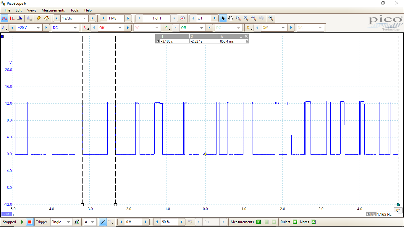

The temperature and fuel gauges on a '65 S1 I’ve been helping a friend with, were under reading. I measured the output of this voltage “de-stabiliser” with my Picoscope and it looked like this:
27 Ohm.png (79.31 KiB) Viewed 6857 times
This trace was taken with a 27Ohm load on the ouput of the voltage “de-stabiliser”. It can clearly be seen that the on vs off time is greatly biased towards the off cycles and thus the average voltage output was way below 10V.
I installed a LM7810 which gives a constant 10V DC ouptut and now both gauges read correctly.

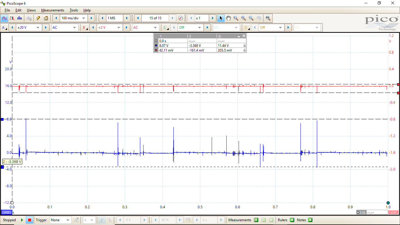

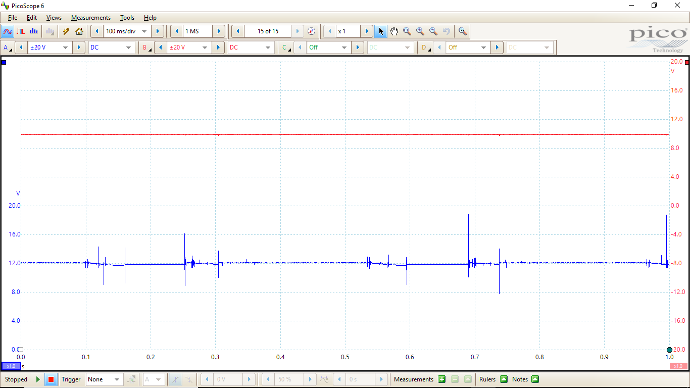

Here are the results measured on my S3 V12 with a 7810 installed inside the voltage stabiliser housing - without any smoothing caps on either input or output. Note that I had both channels set to DC, both channels unfiltered (i.e. high frequencies are not filtered out)
To see the traces really nice, click once on the pictures, then right-click on the picture and select "view immage" and then press F11 to make it go full screen.
12V input trace is blue, calibration on the left.
10V output trace is red, calibration on the right.
We can see the input voltage at 12V (ignition on, fuel pump running, engine not running) and the 10V output signal. One can see rather huge spikes on the 12V signal coming from the OEM fuel pump, but the 10V signal is clean, for all it matters.
10V unfiltered.png (58.51 KiB) Viewed 6745 times
Now we look at the two signals with both probes set to AC, so that we can only see the AC component in both signals. Amazingly the 12V input signal has spikes (very briefly) to 8V (ABOVE the 12V input) and to -3.4V ( very briefly pulling the 12V line down by that much)
10V AC unfiltered.png (67.86 KiB) Viewed 6745 times

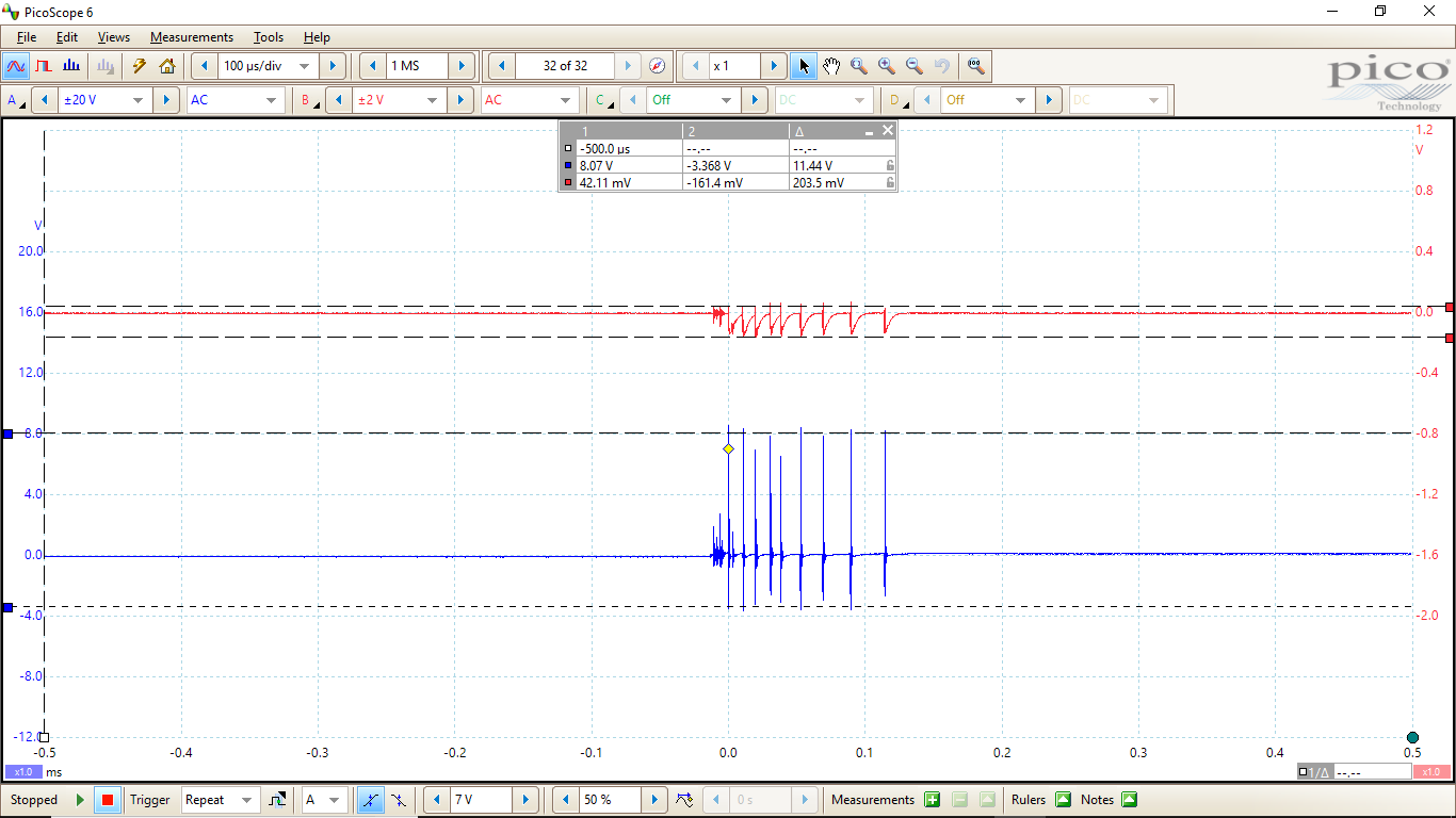

Finally, I zoom into one of those spikes (trace time base now at 100us/div) to see more detail of what happens there. Now we can see that each of those spikes is not not one spike but several!! I presume this is due to the mechanical contacts within the fuel pump "bouncing" (or arcing??) as it opens - making and breaking several times - before finally breaking.

Marek did invite me to look at how noisy the 12V input is. Now we can see, indeed it is. But we can also see how good a job the 7810 is doing at putting out a steady 10V despite that noisy input with a ripple of only 0.2V - and then, only during those spikes.
