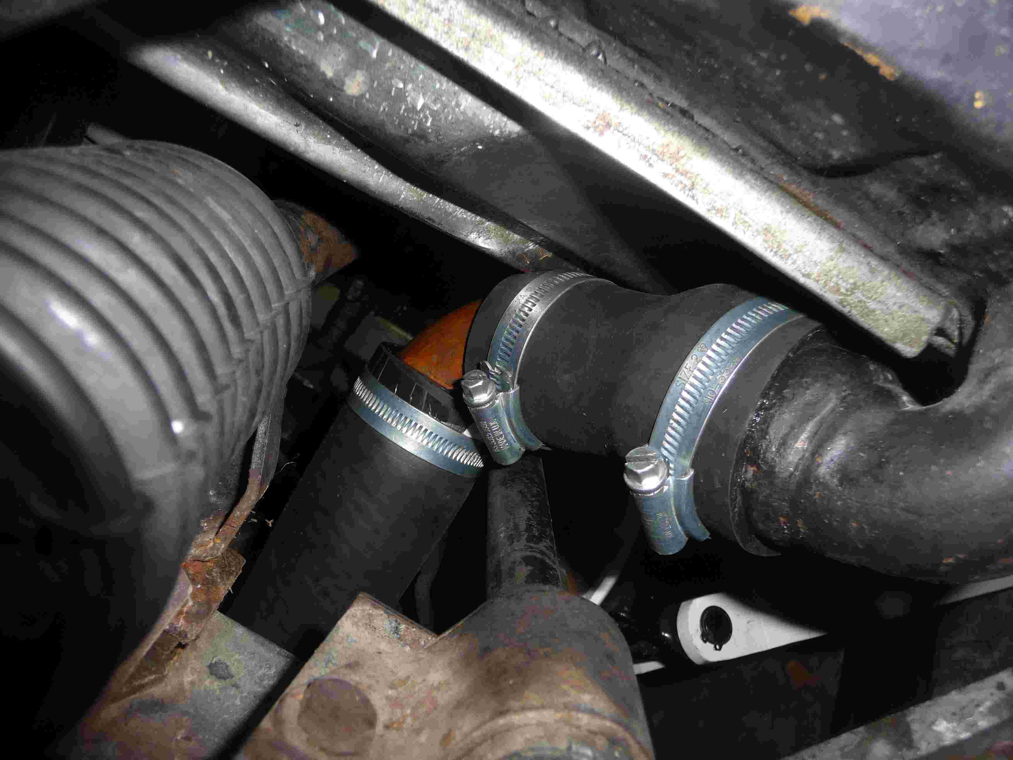

I am refurbishing my cooling circuit and I am stuck with this damned hose.
It will not accept being inserted as it cannot come axially into the rad inlet, being constrained by the rad.
I have tried silicone grease, heating it, no way!
Any tip?

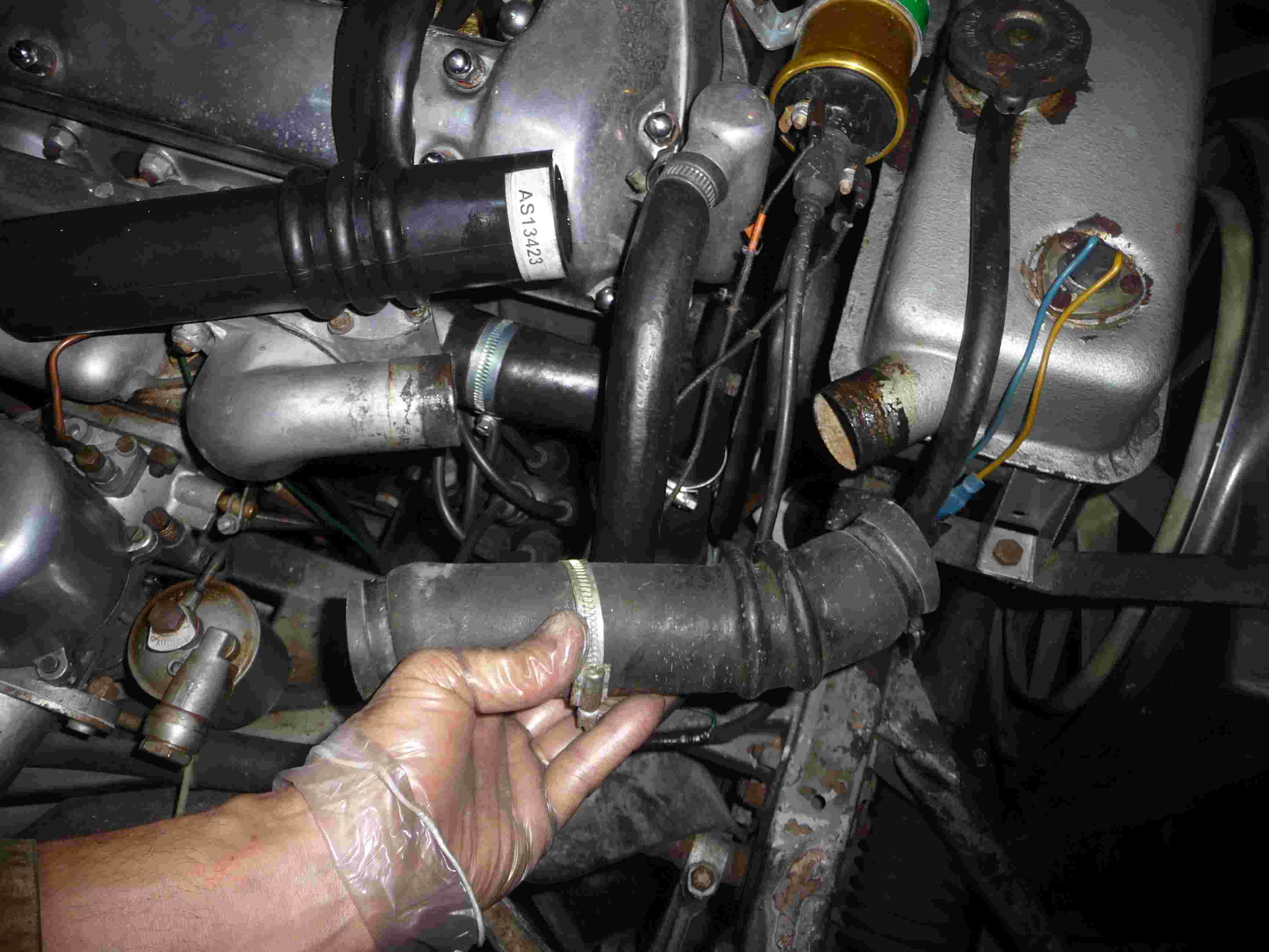

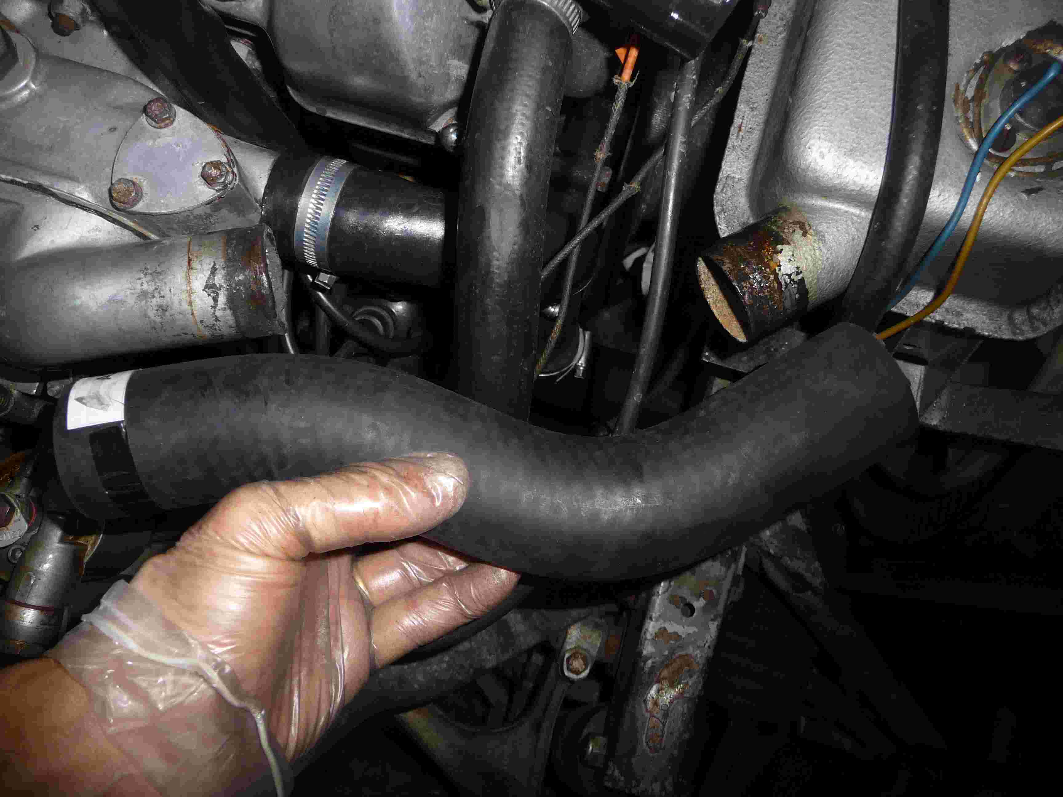

Problem solved.
I finally managed making it from underneath, but it was a pig!
Look how off-axis it looks after replacement.
Btw, the usuals provide an additional hose in the hose kit, which is very useful to replace the "accordion look" hose going from the carbs rail to the expansion tank.
Actually the accordion hose they deliver is not flexible enough to be easily inserted and the preformed hose they offer instead fits just right.
