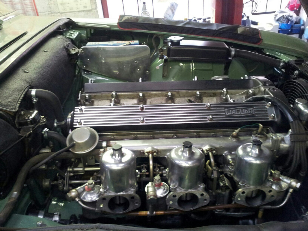

As above..look for the part number.....however the longer stud on the rear inlet side was used on 420 & xj6..they also had the rear lower 2 studs longer but on your head they are missing.....the longer studs held the throttle mechanism..also jag moulding on cam covers on 420 .....Also as you are looking for originality note that there are 4 different part numbers for S2 heads dependant on your engine number..details is S2 parts catalogue Knowledge base section.......Steve

Steve : your top photo is actually a 420G, but definitely not a 420 or Sovereign

Hi Christopher...thanks .......Just posting to point out to the o/p that it isnt only E types that had Jaguar moulded into the cam cover and to see the longer stud for the throttle mechanism.....Steve
