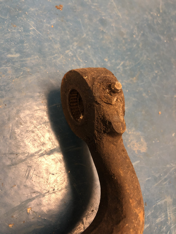

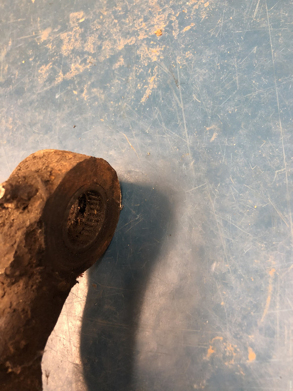

I am in the process rebuilding the IRS and diff and have the unit out of the car and dismantled. Most parts are not too bad, the diff is being sent off for rebuild, however the rear inner wishbone bearing seats are damaged on both wishbones, the photo shows the damage. My question is what can be done? My initial thoughts are to have bearing seats professionally bored and sleeved, I would think all four would have to be done in order to ensure the correct alignment.
Any thoughts, alternative ideas and any recommended companies who could carry the repair work would be much appreciated.

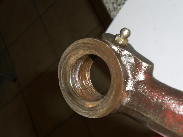

An alternative solution is to go for phosphor bronze bushes. The arm could be machined out and bushes made to fit. I have them in my car and after about 30k miles, they still work well.

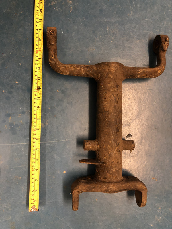

Hi Simon
I might have a pair in my garage you can have
I’ll photo them and send a picture
Roy

Angus - are these bushes available 'off the shelf' and as over sized or would they have to be custom made?

Post by 1954Etype » Fri Jan 25, 2019 10:28 am
Hi SImon, the standard ones are off the shelf. Yours would have to be custom made.

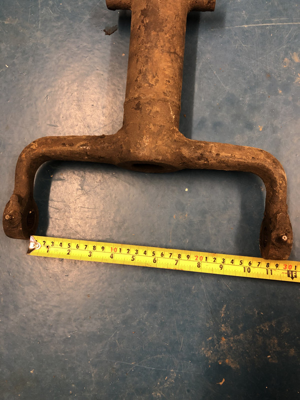

#7 Re: Rear wishbone seat damage
Post by Robbiee » Fri Jan 25, 2019 2:20 pm
Hi Simon
I’m not sure they’re the correct type/dimension for you
I’ve stuck a tape measure next to them to see
You can have them for £50
If they’re the correct size I’ll press out the bearings and see if they’re ok

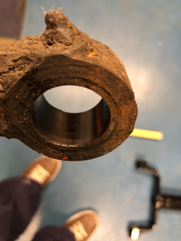

Post by Robbiee » Fri Jan 25, 2019 3:07 pm
I’ve pressed out the bushes and the bore looks pristine(see photo)
Don’t be put off by apparent rust/mud/oil..the wishbones are fine

#9 Re: Rear wishbone seat damage
Post by simong » Fri Jan 25, 2019 3:44 pm
Hi Robbie,
They are the same size as mine and will be fine after a good clean! I will drop you a PM to arrange pick up etc, I am based in Notts so not too away.
