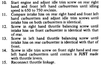

The issue I've ran in to when balancing the carbs following the service manual procedure (all idle trim and balance screws slackened off, set idle to 650-750 using RR and FL carbs idle trim screws, then balance FR and RL using balance screws). All ok up until step 13 of procedure, 'screw in left balance screw until RL carb hiss matches FL.' Tightening the screw doesn't actually rotate the throttle spindle in the direction required to open the throttle, so I'm wondering if the linkages have been wrongly fitted, which brings me to my question/request, does anyone have a picture of the left bank balance screw setup please?
Also something that doesn't seem to be mentioned, when adjusting the balance screws obviously the idle is increasing above the initial 650 RPM base setting. Do you ignore this and match all the carbs perfectly, then reduce the idle speed by backing off the RR and FL carbs equally?

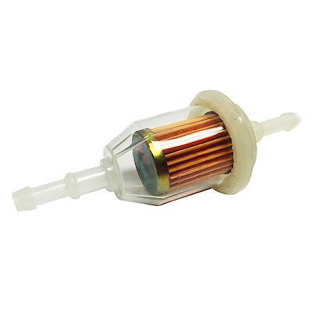

One other thought regarding distributors. Jaguar, after a couple of distributor cap explosions, due to vapours leaking into the cap, changed the cap to a vented one.
These are available thru the usuals, and have two ports on them, one is connected to the rear of the air filter canister to provide a small positive suction, and the other one goes to a small air filter to allow fresh air into the distributor. I used a small ride on mower filter for this purpose, and just tied it to one of the engine mount frames.
#8 Re: S3 V12 Stromberg/Dizzy vacuum pipes
Posted: Sun May 12, 2019 3:03 am
by Geoff Green
The distributor air inlet filter was a push on small fuel filter connected to the distributor with vacuum hose, no clamps used. The filter was loose in the v of the engine.

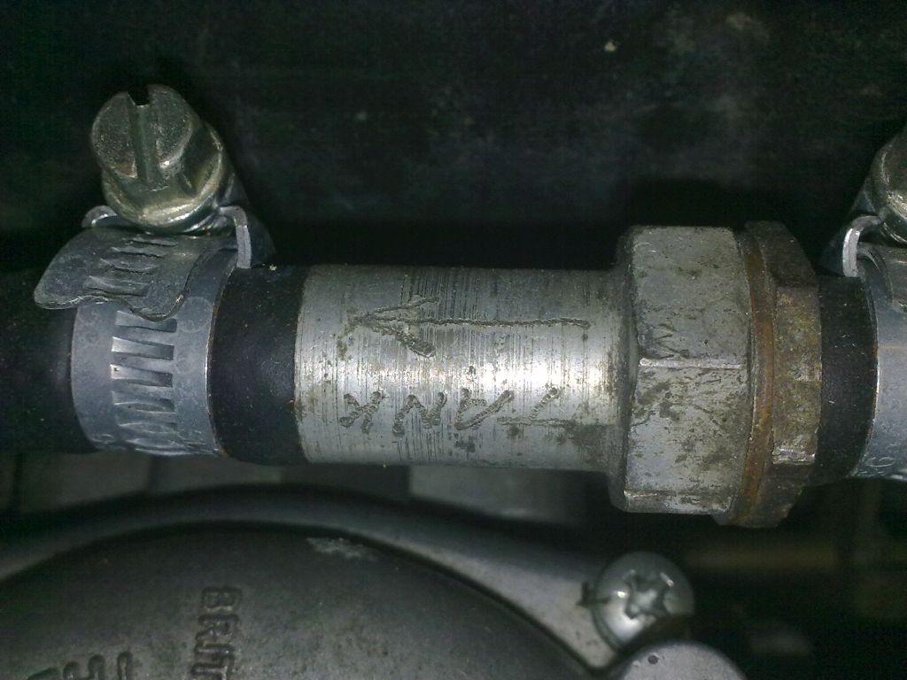

Check the fuel pressure - should be 1.5psi. Burlen quote a minimum fuel flow rate of 30gph (Imperial) for the pump.
Check that the fuel pressure sustaining/relief valve located in the return line by the LH front carb has the scribed arrow pointing in the direction of flow and is "sizzling" continuously. If it is intermittent or silent the return line might be blocked allowing over pressurization and flooding of one or more carbs.
Let us know how you get on.

I honestly don't recall ever seeing a FP sustain/relief valve, should all V12's have one? Wonder if it has been scrapped by a previous workshop? I'm assuming fuel 1.5 bar is ignition on (not idle)?

My understanding is that the design operating fuel pressure is 1.5psi (not 1.5bar as you mentioned) and that sustaining that pressure at all operating conditions is the function of the valve which is located behind the front left carb in the fuel return line. It is a simple ball bearing and spring device and can be easily dismantled and inspected/cleaned.
I don't know what pressure the fuel pump will achieve with the return line blocked but from experience know that with a new pump it can overcome a new carb float valve.
