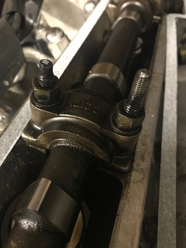

Hi Brian....can you see any of the stud..where has it sheared off...can you see any of it....do you now have the cam cover removed..a photo would help...Steve

Stud is just proud of the cam cover (so the bit that sheared is the upper threaded part).
Picture attached.

Looking your photo I think you have enought thread to do waht I explained you with the broken stud.

Brian, just have a Look at closely to something.
Compare the lenght of the stud when the can cover is in place and the depth of your dome nuts.
I don't think you broke the stud with a too hight torque but rather the stud was at the bottom of the nut and not yet flush to the cam cover. Hope it could help you for tomorrow... :fingerscrossed:

What Mich suggests will work fine.
Try cleaning out the bottom of the hole with a bit of wire and some WD40. If you think the stud is sitting a little high run a tap down the thread in the head; it is 5/16" /UNC. If you are still unhappy grind a little off the top of the stud where the domed nut fits.
Retorque the cam bearing cap to 15 lbft. You may need a long 1/2"AF socket to do this properly. It is important that the cap is properly torqued down as this affects the valve clearance.

Ok, well that was easier than I thought...
2 nut idea worked a treat and in fact the stud was quite easy to remove so I do wonder if maybe it wasn't seated fully in the first place and that the chrome dome nut did indeed 'bottom out'.
