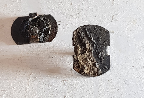

I would like some ideas to replace these steel plug (
Sealing Redundant Holes In Floor )
#2 Re: Steel plug - holes in floor
Posted: Fri Feb 15, 2019 1:15 pm
by Moeregaard
I used 1/2" knockout plugs for electrical junction boxes, available at most hardware stores.
#3 Re: Steel plug - holes in floor
Posted: Fri Feb 15, 2019 6:17 pm
by Mich7920
Moe, the size I need is more 3/8 than 1/2
I found this on ebay.co.uk 9mm-3/8-50-PCS-RUBBER-SNAP-IN-BLANKING-PLUG-BODY-HOLE-BUNGS-STOPPER-GROMMETS
It's ok now.
