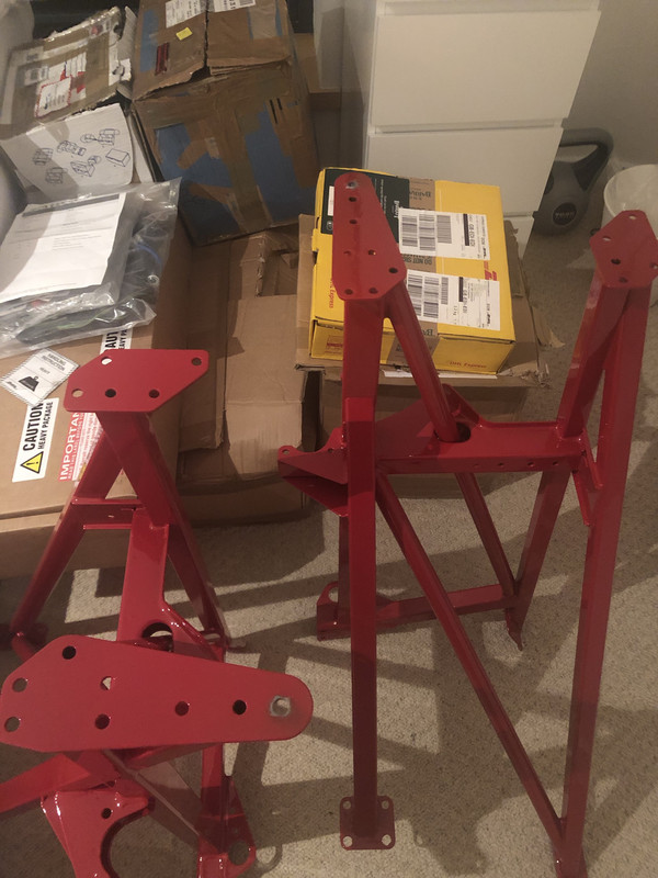

Here are my beautifully painted original engine frames ready for re-fitting. Before I do I would like to apply Dynax internally.
As can be seen, only some of the tubing have access holes in the end plates so I should only worry about sealing those tubes? My thinking being that the tubes without holes are vacuums and therefore cannot rust internally.
Alternatively I could drill small access holes for the Dynax tube and do all of the tubes.
As always, value your views.
cheers
Ash

Whatever you do, don't drill holes in any of the tubes themselves, as this a.weakens them mechanically , even if not by much, and more significantly can create stress concentrations from which fatigue fractures can propagate. I suppose it might just be permissible to drill the endplates which I suspect are mild steel, but I think most of these have holes already so there's not much point

The only way of doing it is a few more holes in the endplates Ash.
10mm for the probe.

Holes in the endplates is the only way.
I did this with no problems.

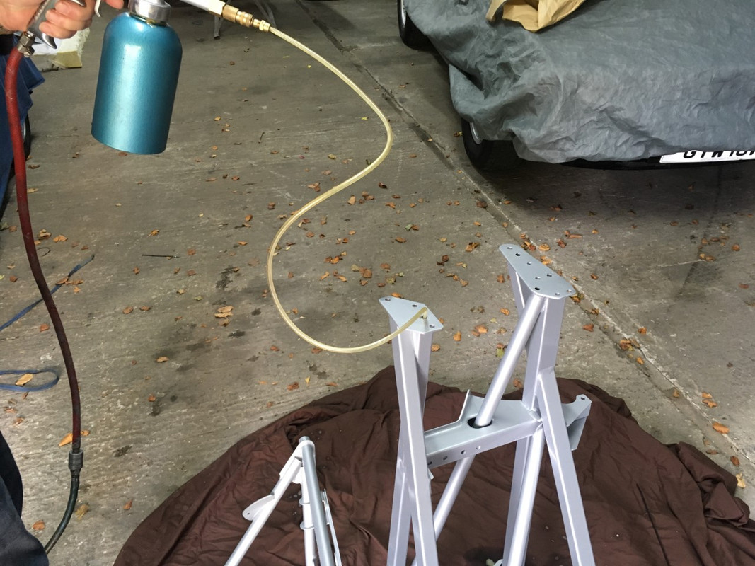

If you're confident you've got a good and consistent 360° spray out of a probe then pulling it through the length of the tubes will be fine.
My probe and spray-gun from RustBusters, who couldn't be bothered to supply advice/instructions/guidance, has never filled me with consistent delivery and 360° confidence, so what I will do with my frames - when they're ready for treating - is to do what I did with the Mini rear-doors, much as John suggests above.

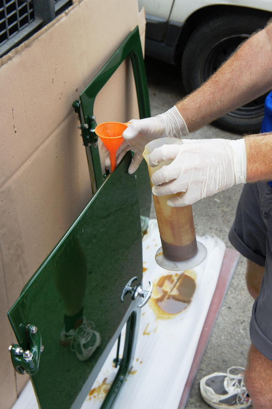

I blocked off all the holes but one, then poured half a litre of warmed and thinned Waxoyl (maybe 10% white-spirit, can't remember) into the door.
Turning the door around and over in all directions gives a wonderful sloshing to everything and then you pull out the hole-bungs and let the excess drip out.
(And like our friend E600 says, if you park it in the sun in August you still get the occasional burp - note, this may be harder to reproduce in Edinburgh !)
