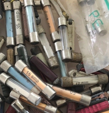

I`m trying to find the correct lucas fuses for my car in various amps but I can only find the agc style fuses. If I understand correctly theese are not comparable both in size and blow rating.
Where can the correct ones be found, or any tips for finding the correct ones?

The ratings (amps) are different on modern glass fuses though the physical sizes are usually the same. Basically if Jaguar specified a 50 amp fuse you need to use a 25 amp modern one. The original fuses have markings with "continuous" or "maximum" amp ratings on them - Jaguar used the Lucas the continuous fusing current rating for the 5 amp (3.8 cars), 35 amp and 50 amp fuses fitted to the E-Type.
You can find them on eBay, used and NOS and there are also reproduction ones produced:
Lucas fuses can have three ratings; the continuous current they are designed to carry, the instantaneous current at which they will fuse, and the continuous current at which they will also fuse. The figure found on Lucas fuses is the continuous fusing current which is twice the continuous ampere rating that the system should be using; this can be a source of confusion when replacing Lucas fuses with non Lucas fuses. The UK Lucas 1/4" diameter glass tube fuse have a different length as compared to the standard US item. The Lucas 1/4" diameter glass tube fuse is 1 5/32" [~29 mm] long, while the US standard 1/4" glass tube fuse is 1 1/4" [~32.0 mm] long. However many Lucas fuse holders permit the longer U.S. version to be installed without problem.
So unless you can find NOS Lucas fuses you need 3 amp (3.8 cars), 25 amp and 30 amp modern or US glass fuses.
