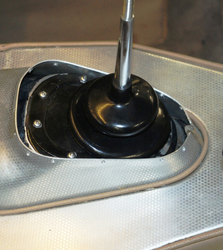

Post by Jeremy » Sun Feb 24, 2019 5:10 pm

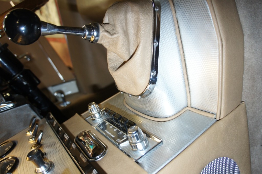

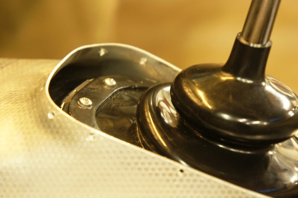

GB did a superb job on mine but it was Angus who told me they had fitted the wrong (fat) rubber gaiter (top photo below) underneath the leather gaiter - which made the gear change very stuff, esp getting into second. Assuming you also have a later 4.2 like mine (with the leather or leatherette gaiter on top) you need the slimmer version (bottom photo):

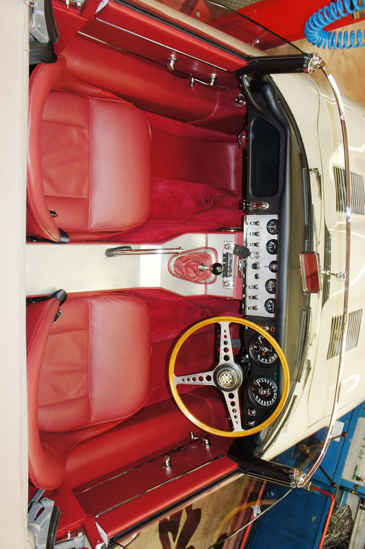

The S1 shiny rubber-bellows part was surely always under a leather gaiter, never visible ?
My car (1962) uses that type,
and whether with the beige version of the trim that the car came with,
or the red re-trim that I did in 2017,
the issue of the leather gaiter was never an issue.
I'm surprised that the type of rubber gaiter could make any difference to the gearchange as on my car the bellows is never near anything that could cause it to foul or reduce the travel.
(It may be 5-speed but the lever exits in exactly the same place, and the bellows is mounted as per original even if the cover-mouth has been modified ...............)

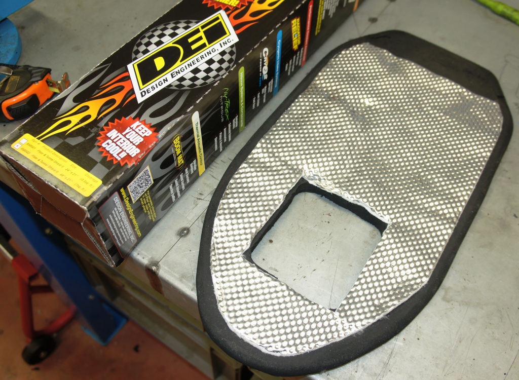

Regarding the foam noise-reduction pad, anyone having to make one of these could do worse than this, which has worked successfully for many years.
Details towards the end of this :
http://forum.etypeuk.com/viewtopic.php? ... eed#p42324

For a couple of years starting 1E20103/1E30350) Jag used a subtly different trim piece with an approximately round hole through which the upper round ball part of a thick rubber grommet protruded (BD27500). The base of that moulding is held to the transmission cover by a flat steel trapezoid ring and screws in the normal way. Most people prefer a leather or vinyl gaiter and sometimes you see them just fitted over this bulbous type of rubber gaiter (part 36 in plate 49 of the S1 4.2 spares book), which then looks like a pregnant woman in a late-term frock, and can affect gearchanges.
To fit the leather boot you should use a thinner, low profile rubber gaiter on the tunnel and open up the round hole to the trapezoidal edges of the trim piece and fit the leather to that. Then fit a thin chrome trim around the enlarged hole and the round chrime bezel to fit the top of the ‘wigwam’ to the gearstick. All shown in period pictures.
