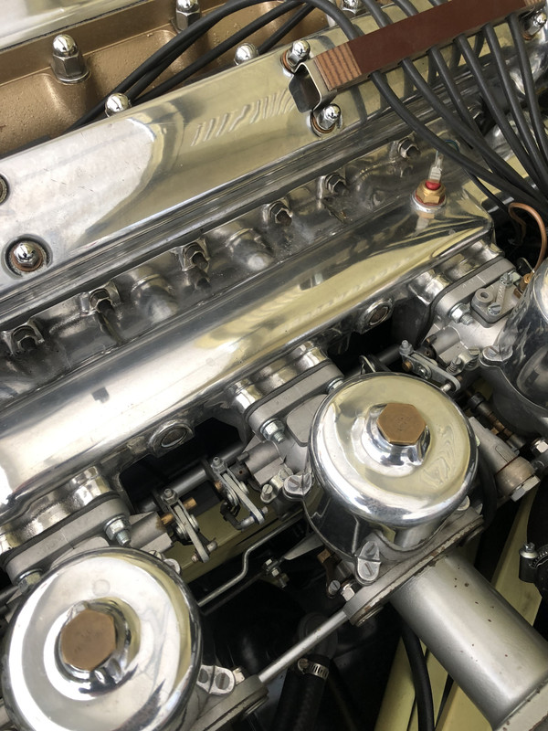

#3 Re: Mangoletsi ITG Air Filter from SNG
Thanks Mark, most grateful - did you try both sets of UO and UE needles? If so I’ll go for your recommendation. Also did you just bolt on or are you using pancakes inside to smooth the airflow? James

This is going to a stupid question James, but, erm, what happened to your carburettors?

Morning Jeremy
The carbs are tucked up in a box with the intake, air filter and plenum, 123 tune distributor and linkages ready to go back on my next project.
I was going to reuse the whole lot (they were rebuilt in 2016), but I had in mind one of those foam filters that dangle off the plenum, occupying the same space as the original cylinder. However, i might just go in this ITG direction and do the jetting at the same time.
I think both options wold sound good and help make more power.

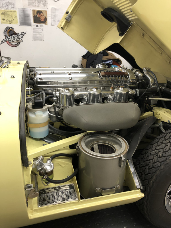

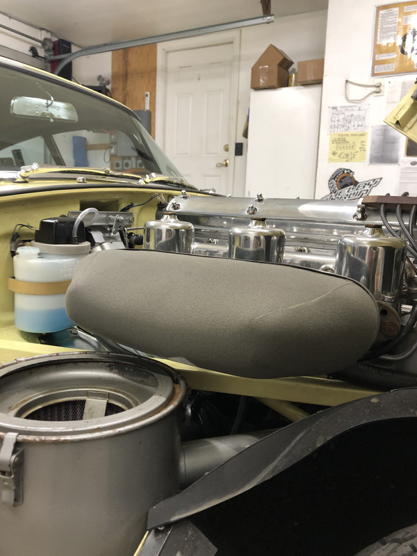

#11 Re: Mangoletsi ITG Air Filter from SNG
Guys I just put this filter on the car as I’m always trying new and improved ideas. Some work , some don’t.
ILOVE the Rob Beeres pulley set up
What a pleasure!
So with 7,000 break in miles on my 4.2 1967 coupe
I tried the filter!
I’ll keep the barrel underneath for now
But it looks like soon it will be gone!
Overall
1. I’m getting a lot more air
2. With more air my BELL exhaust got throatier!
Not as vacuum cleaner sound!
3. At a LONG light the needle creeps up only slightly after twice the amount of time at a light!
4. Going through the gears it has an extra umph.
5. You can tell it was strangled before even with a kn filter!
I just did 80 miles today in 55 degree weather
No gas smell no blow by smell no hiss
I. Like. It!!!!
So easy to switch back too
But I probably won’t
Thank you SNG
Ps these motors get a little loud when running hot
Running cool is the sweat spot
Well that’s my opinion
Good luck

#12 Re: Mangoletsi ITG Air Filter from SNG
Did you change the SU needles Joey? The extra air flow will make the engine run lean with UM needles so you might want to try UE. Jaguar tests showed the "air silencer" reduced power by 6% and the baffles silencers reduced power by 10%. So what you are saying about the driving experience confirms that.

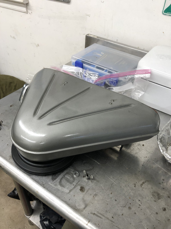

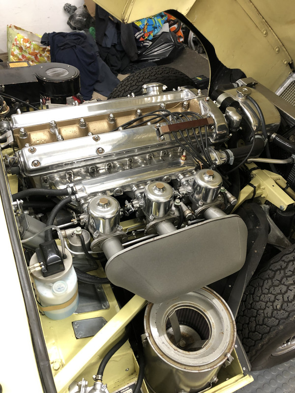

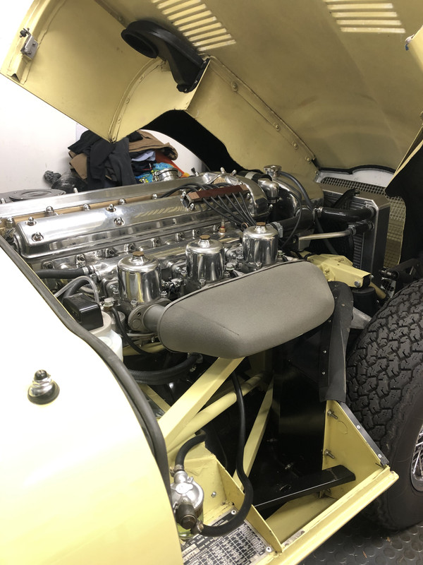

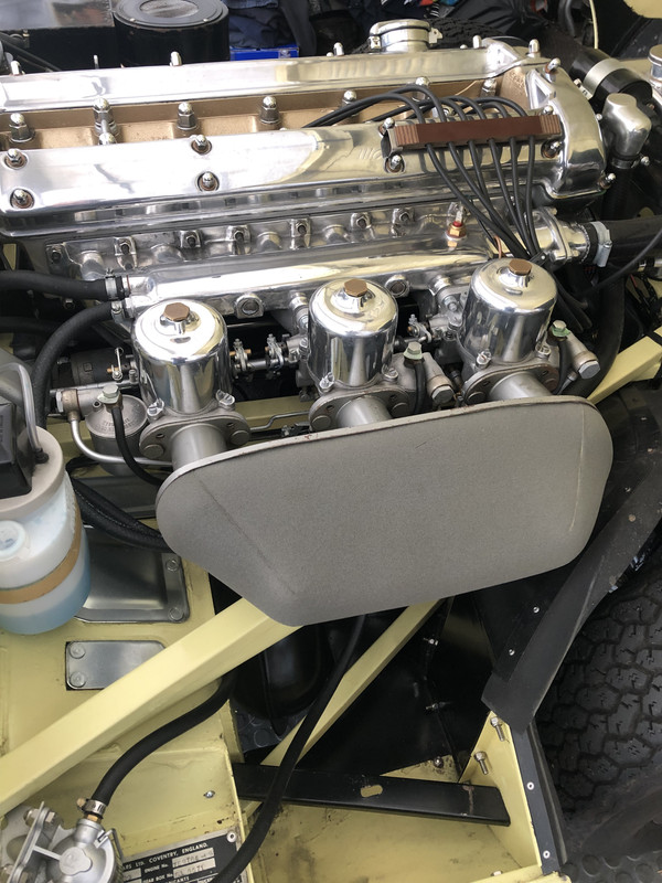

#13 Re: Mangoletsi ITG Air Filter from SNG
Here’s what I’ve got
I already pulled the canister!
Look how lovely!
I kept the UM for now as I feel the response but not the leanness .
The temps outside was 55 and dropped to 46.
So I’ll run it all week as changing needles takes me about 10 minutes
It’s sooooo fluid through out the range
I also treat myself to 100 octane unleaded NO ethanol
So maybe that’s why I don’t feel the pull back or leanness?
Let me drive it through all temp ranges first.
I really like it!
All I need is a 5 speed OR if someone makes me one a 6 speed auto! That fits!!!
I’m game
This filter was a great easy and easily reversible treat!
Gtjoey1314
Plus the tone is a bit deeper out the back!

The latest mangoletsi ITG air filter shown on the SNG site is a dark charcoal/black colour rather than the light grey shown above - is there any difference in design, and do we know if the grey is still available?

I’ve got one which is now taking space in my overcrowded garage.
Fitted it for a short while but frankly I found it a poorly made fragile rubbish item. Despite what others have said all I noted was an increase in noise (and yes I did change the needles).
I’ve gone back to the standard canister until I find some of better quality.

Tim, Each his own, it was on my wall as well.
Ill drive for awhile , I like the response AND the throat sound out the exhaust.
We shall see, like my EZ STEERING, Once it was in, it transformed the car.
I have noticed that the upgrades I have done over the past 30 years.I never break down. !
So will report back.

#18 Re: Mangoletsi ITG Air Filter from SNG
Update…..
Note that carb base spacer does not sweat.
Also the top hats and filter are all ice cold
Where the original trapped in heat.
So at lights my needle does not bump up till a long while
The gain is wonderful
I love it
