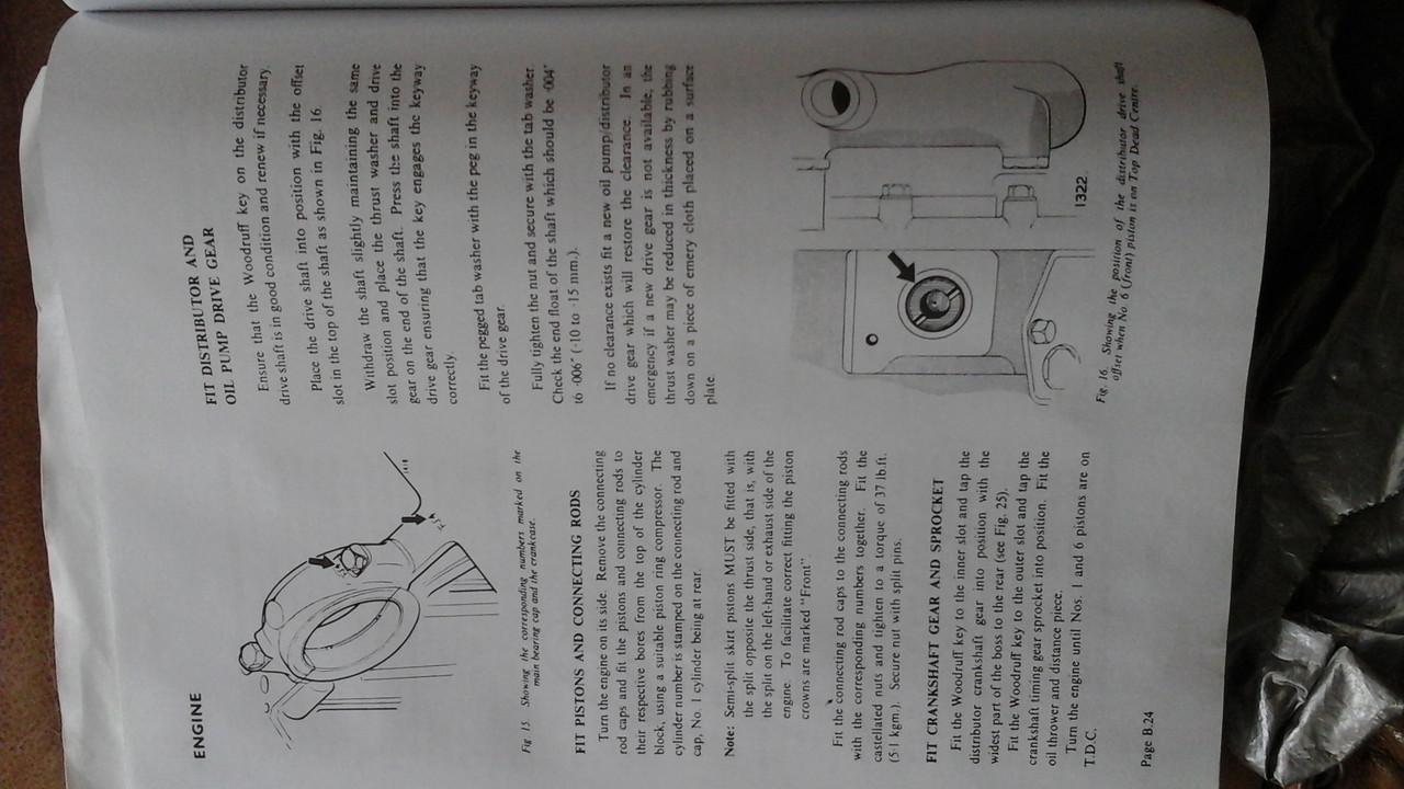

Hi Mich...this is the page your after from the service manual.....dont forget that 1 or 6 will come to tdc twice....once for compresion and once for exhaust..Steve

Jerry, Steve,
I remember very well this page of course. It's important.
45° angle, the small half is on the left the largeur on the right. You check this without the head on the engine so it's really easy to see that the 6 and 1 are at their DTC.
I think my mistake came purhaps from the nuts hole on the bloc. I took it as a ref for the the top of the 45°.
It can't came from an other reason...

I suspect that your distributor drive is incorrectly aligned.
This usually happens when on assembly you fail to turn back the drive cog 3 teeth to allow for rotation of the distributor drive shaft as the crank drive cog is tapped in.
See http://www.projectetype.com/index.php/t ... 6-eb2.html for an explanation; go down to the 3rd last picture.
As Peter says it really doesn't matter. As long as you correctly allign #6 at TDC you're good to go.
