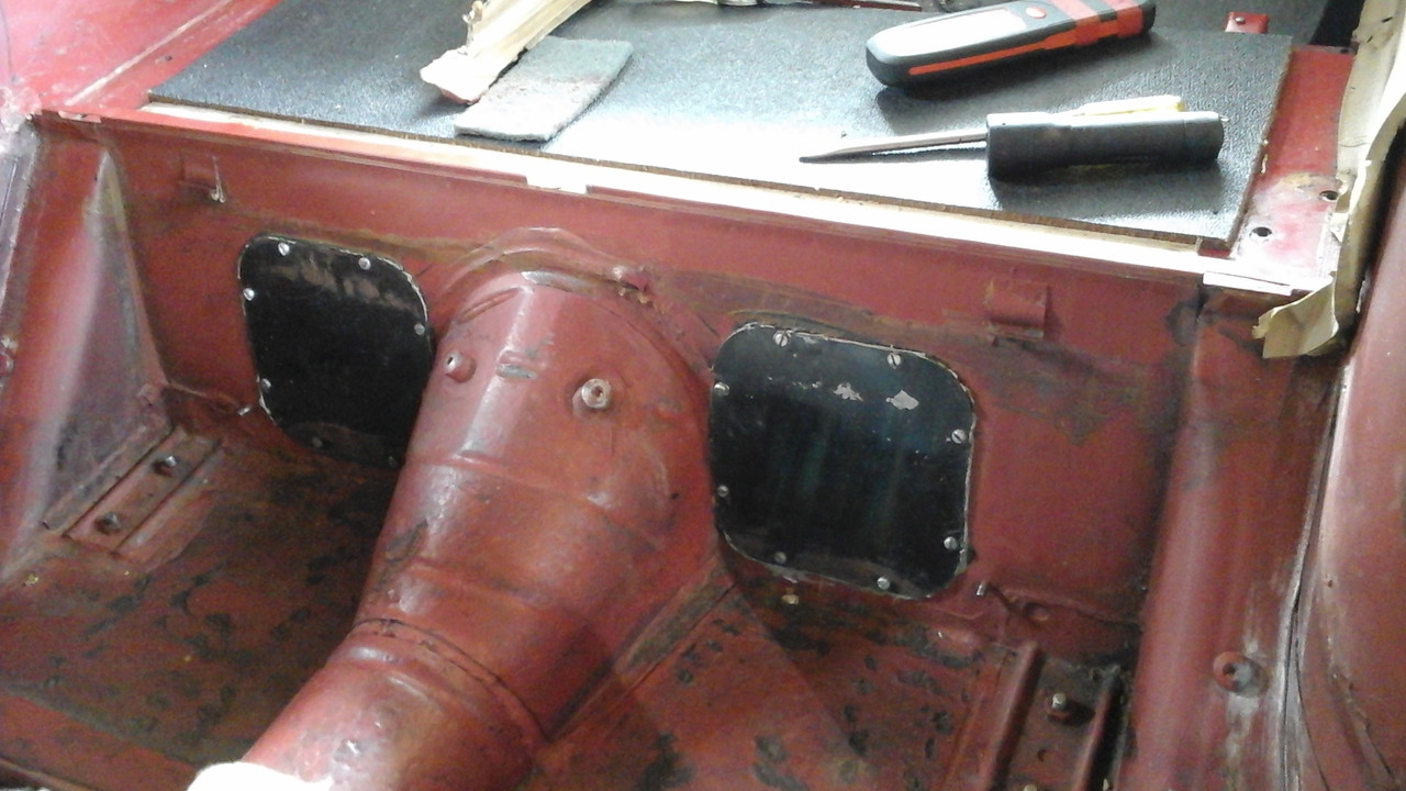

Hi Ian....my 69 2+2 already has access plates..think yours should.....remove the lower part of the back of the rear seats....2 vertical panels....Steve

Hi Ian....the panels give access to bleed nipples and to replace brake pads.......you can undo the handbrake calipers and take them out over the top of the discs and out the rear of the irs....its not easy.....some models have an acccess panel above the irs as you mention.....personaly i wouldnt cut the body just to access brakes....you could drop the IRS and fit remote bleed nipples........the hole /panel you refer to would be on top of the irs....where the tools are in my photo above...under the hardura cover are 2 moulded panels..that i think you refer to that some have cut out.....Steve

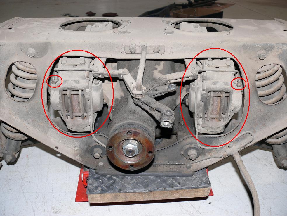

We're definitely on the same page. Not that cutting the access hole in the panel above the IRS Cage has anything to do with accessing the Brake Caliper Bleed Nipples, but the time required to do the job properly and not finish with the Dog's Breakfast of a hole shown in the following picture, as well as making the correct looking cover plate, you could have had the IRS out an back in more than once. Part of my brief for the restoration of the car this hole has been cut in, is to take it back to how it was originally.
I just don't get it when rather time consuming modifications are made, to supposedly make a task easier that is only carried out once in a Blue Moon.
To Ian:
The following picture shows what is given access to when the hole is cut in the panel above the IRS. No help whatsoever getting to the Bleed Nipples.

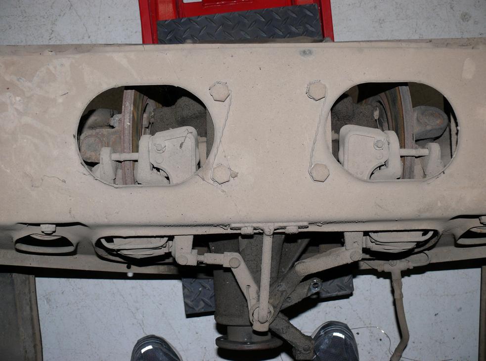

The following picture shows what is given access to through the holes with the cover plates, shown in Steve's Post, removed.
