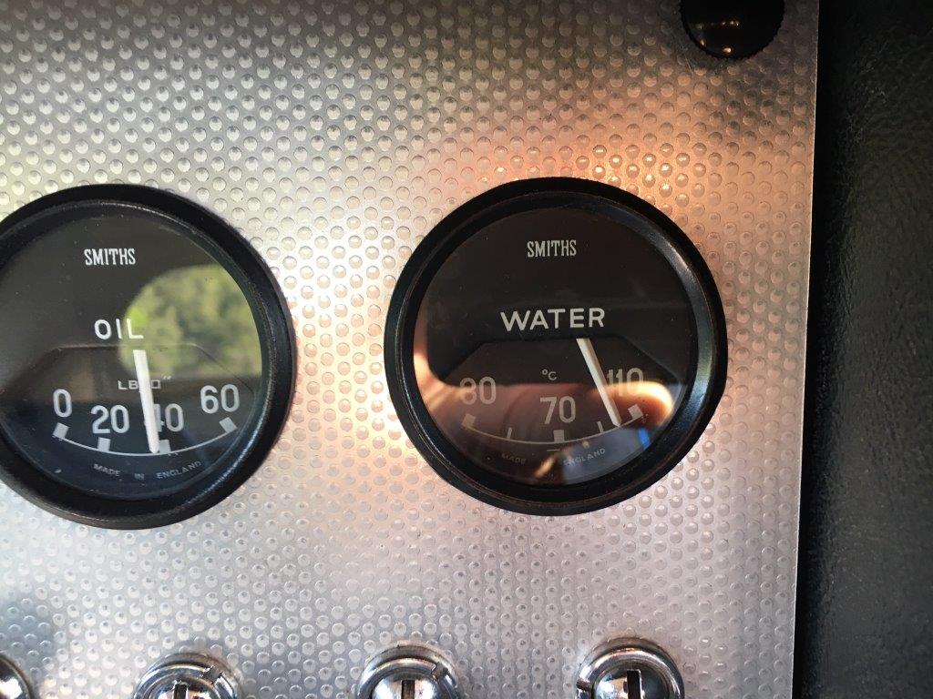

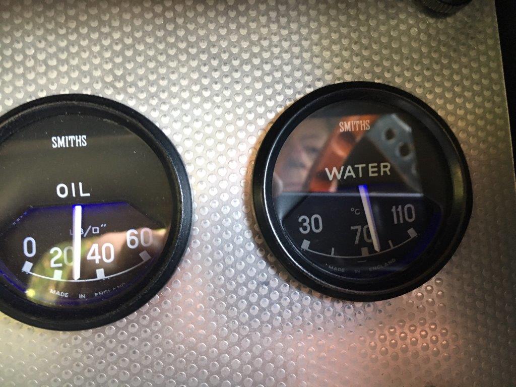

Ever since I have had my car, the temperature gauge every now and again has crept up as shown in the first picture, which to be honest was worrying. I did all the usual checks and could not find anything obvious.
In the end I purchased an infrared laser thermometer which I carried in the car, when the temperature crept up I would pull over and check the temperatures around the engine. All was reading normal.

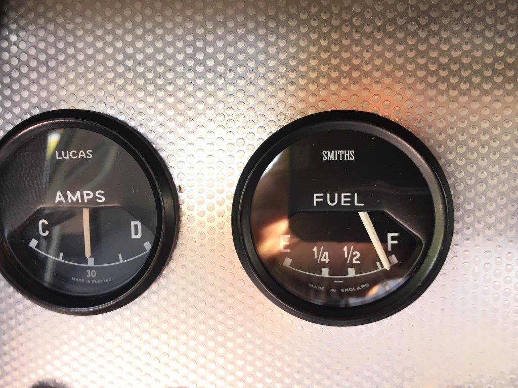

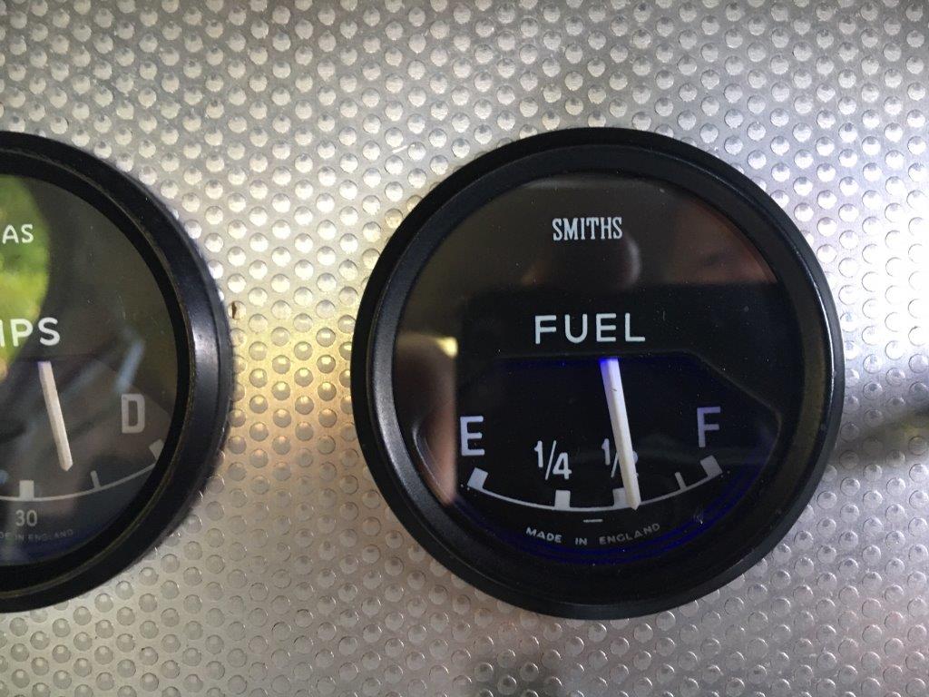

In time I noticed that when the temperature gauge went up so to did the fuel level in my tank... I wish!!!! but the gauge did. That's when I thought, maybe it was the voltage regulator, I replace the regulator and it is still the same.
Although I know it is not overheating it still is worrying when it happens. Not sure if it would make any difference but it has a dynamator fitted in place of the dynamo.
Could anyone offer any help to overcome this problem or have had similar experiences.
The 2 pictures were taken last night on my way back home from its Mot test. The next 2 pictures were taken a few minutes later, I was sat in traffic and the Ammeter was reading - charge

Last year I fitted an electronic voltage stabiliser after the intermittent high readings I was experiencing.
Everything was fine until Sunday when I took my car out for a run.
As soon as I started the engine the temperature gauge went straight to hot. I drove a 105 miles and only once for a few minutes did the temperature drop to normal whilst driving.
Last night I switched the ignition on and the temperature gauge went straight to High, I removed the wire to the sender and no change. I removed the wire from the temperature gauge and still no change. Only when I remove the wire from the gauge, ( the one from the voltage stabiliser) did the gauge drops to zero which is what you would expect.
Does anyone have any ideas before I go any further.
#12 Re: fuel & temp gauge reading to high.
Posted: Tue Jun 02, 2020 9:53 pm
by Paul Jorgensen
After pondering about the possible cause of my gauge going straight to hot when the ignition is switched on, Tonight I removed the Gauge from the dash, reconnected the wires and with the gauge in my hand I switched on the ignition and the needle didn’t move, I then earthed the body to the dash and the needle went straight to hot.
Long story short... the wire between the posts in the gauge was touching the body.
All now working properly again 😁
