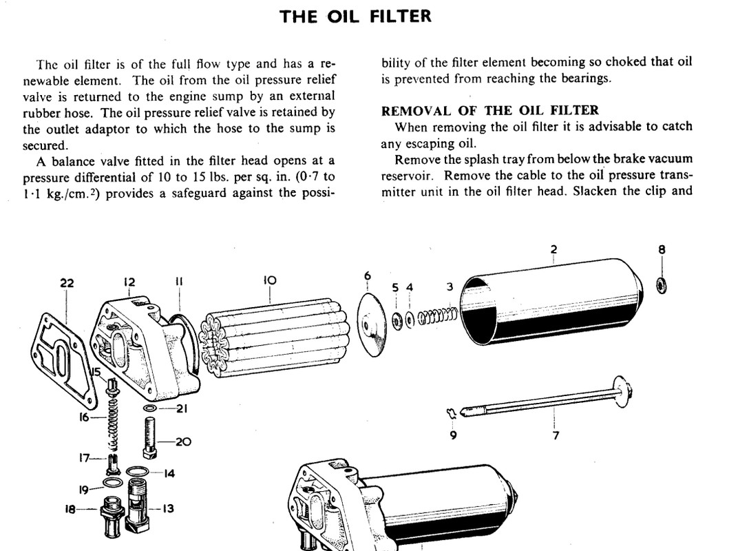

Malcolm : the dissassembled filter head is shown at B.47 or the workshop manual . The PRV assembly is nos 15 - PRV , 16 - spring , and 17 - spider ; the balance valve , which is the by-pass valve, is 13 and again from recollection is a spring loaded valve, in this case a ball. You need to make sure that all of these are undamaged, have no breakages , burrs or the like which would make them jam, and that there is no particle of swarf etc which would interfere with movement. My guess would be that somewhere in these, there has been a foreign body which has blocked one or other orifices, thus leading to a sharp rise in pressure in one of the chambers which has blown the gasket
PS This crossed with David's post which says much the same
