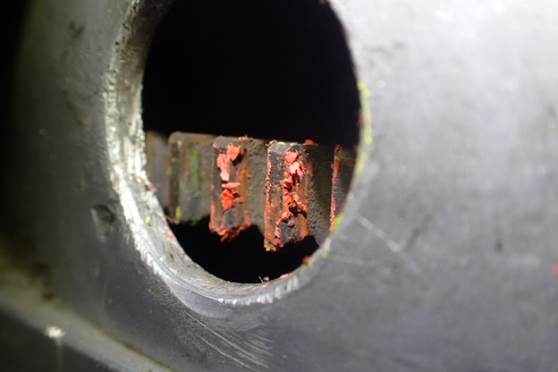

Yes, that's what I found.
I have a gear reduction high torque starter. A 3.8 with a 4.2 trans/bellhousing/flywheel/clutch.
Works well now without the spigot plate.
The supplier said I was to use the plate.

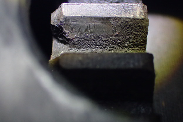

I used the plate when initially fitted as I had with the previous standard Bosch starter and experienced what you are describing, too little contact.
I removed the plate and tried it and note contact of over 1/2 the ring gear, about what the old one was.
No damage is occurring to the ring gear and it's been 4 years and a lot of cranking.
Viewed through the inspection hole.
Picture with crayon/with spigot plate, has starter pinion impression mark on left side of ring gear.
Picture without crayon/without spigot plate, starter pinion mark over half way across ring gear.

Thanks so much for those photos. i too had installed my hi torque starter with the spigot plate in , as there was no instructions to remove it . I called Moss and their tech dept. did not know what to do either. I had taken measurements prior to installation and after considerable head scratching and double checking, decided to remove the spigot plate.
Thanks for confirming that I made the right decision.

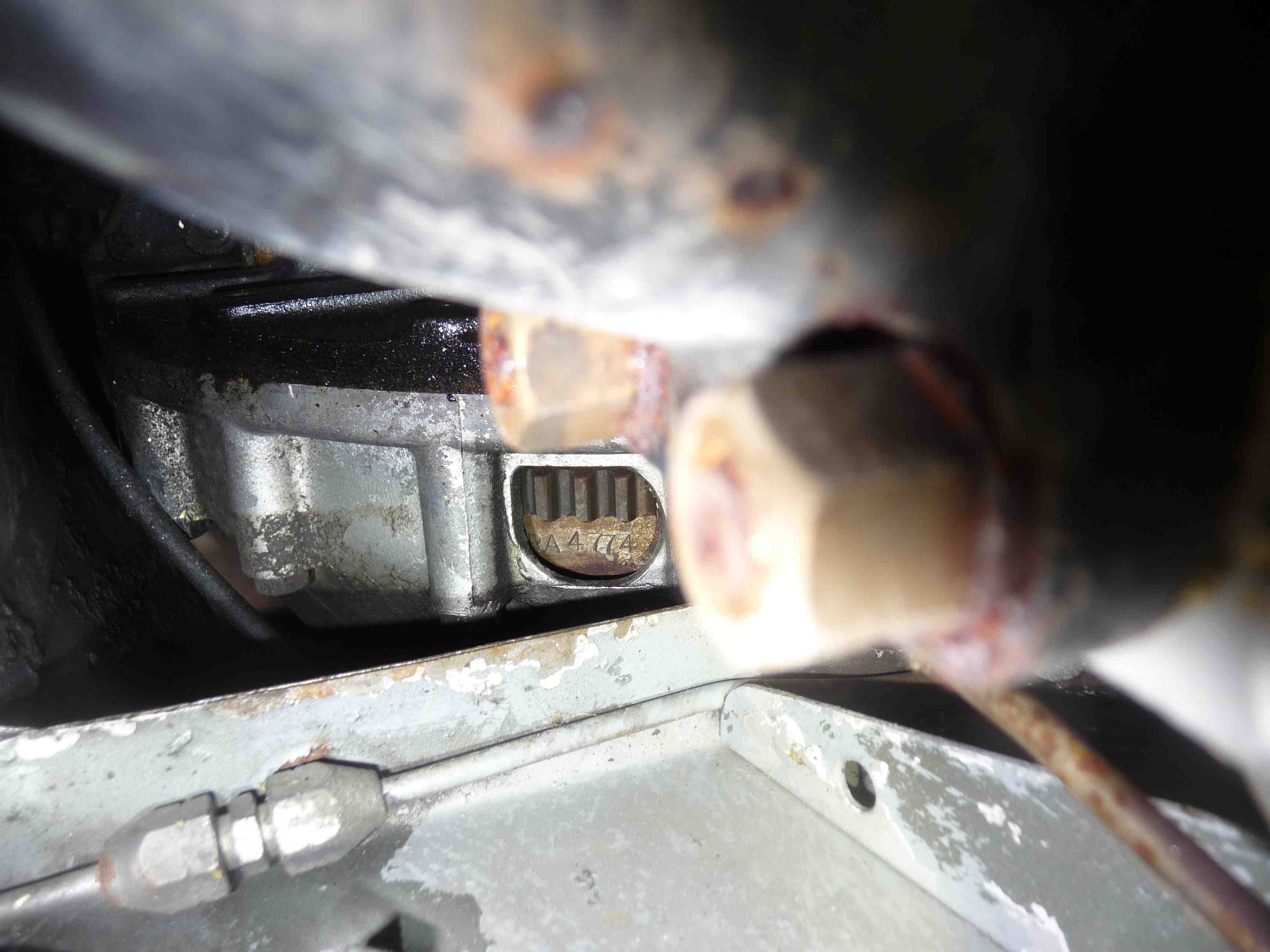

My 3.8 FHC has had fitted by the previous owner such a hight torque starter from Powerlite (positive ground) sourced from SNGB before 2012.
Up to now there was nos starting issues but I confess that I did not check for any positioning issues except that the flywheel teeth look normal (picture here under also showing engine number on the flywheel):
Could it be that there was an evolution in the design or that such a starter has no issue on 3.8 engines?
Serge

Hi Serge in my first post I specifically mentioned 4.2...I havent checked 3.8....3.8 use a different starter and the bellhouseing and flywheel are different and i dont think there is a spacer like in the 4.2 cars....but as per any modification measure and check is the best option..Steve
