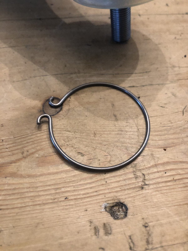

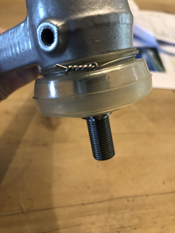

Just fixing the “boots” onto my old upper wishbones which have Angus’s new cups fitted ...I had the wishbones powder coated as this as worked well on my coupe
The metal ring tha came with pinged off v easily so I used safety wire which seems to take twisting and tension very well..this seems to work very well

Good idea - the steering rack bellows was secured to the pinion end housing by tie wire C15211 so it is in keeping. More info here: http://forum.etypeuk.com/viewtopic.php?p=65653#p65653
