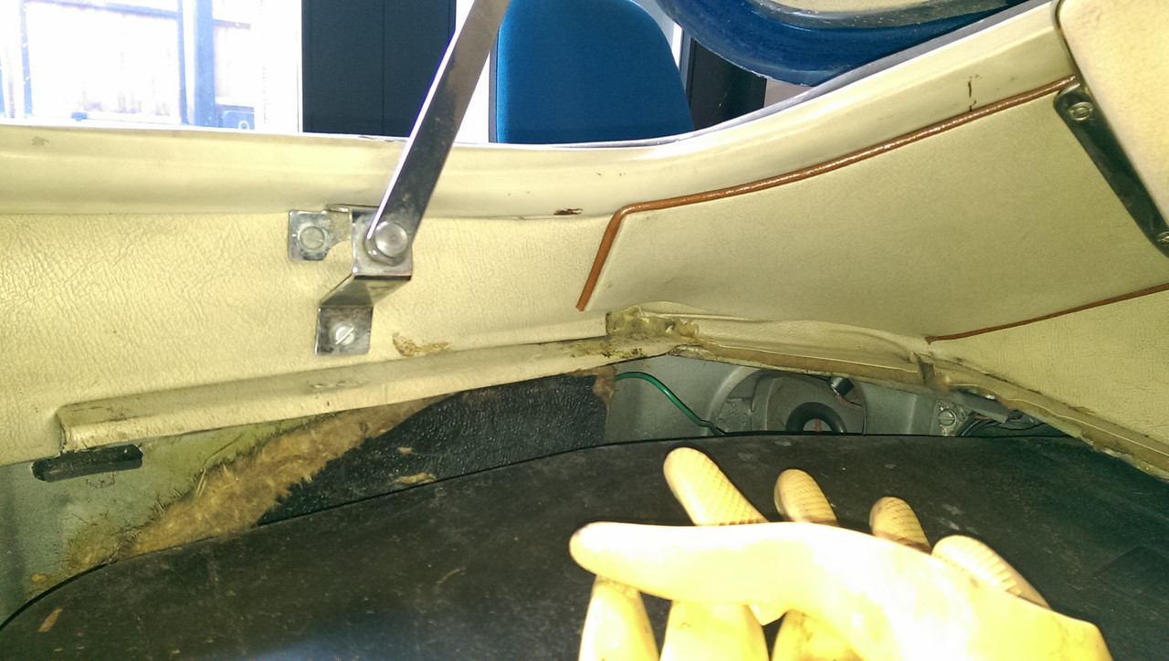

Malc, I believe yours is the same as mine, i.e. the later hinged prop.....here's mine as it was originally before dismantling:
But that rear section of bodywork below the hatch opening was completely rotten so was replaced...and the hatch support didn't line up any more when I got to reassembling. So rather than trying to bend the support, I made up a wedge-profile shim from finest beech for that lower bracket to get it to sit at the right angle, and that now sits behind the trim panel. Sorry, no pic of the shim...
