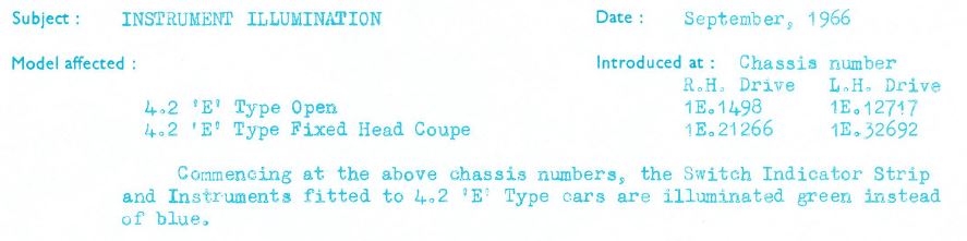

Depending on your car's production date in 1966, it would have either have had blue or green instrument lighting. The cutover chassis numbers are set out in the following extract from the relevant Jaguar Spares Bulletin:
