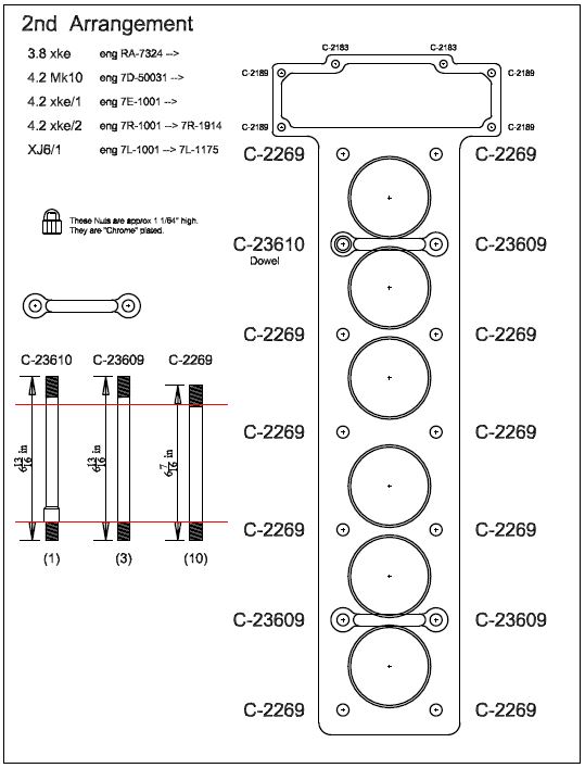

I'm sure you know this and have fitted it correctly, but just checking :bigrin: This is the dowel stud that positively locates the head. So it goes in with the fat bit down on the block surface.
That said I agree something's wrong there. It is by no means unheard of for all of the usuals to sell substandard parts from time to time. I'd ring SNGB and ask them first. They might be able to help. The problem then is that all the retailers probably get their stock from the same manufacturer in China so you may run into problems there too.
XKS in the US sell ARP studs, and I have used them on engines before. They are of really high quality but I'm not sure that mixing and matching is necessarily a good idea.
Given that you're using C2270 I'm assuming you're taking about an early 3.8 engine? One option if you're not super concerned with originality is to fit the later long studs with the 2 aluminium engine lifting brackets.

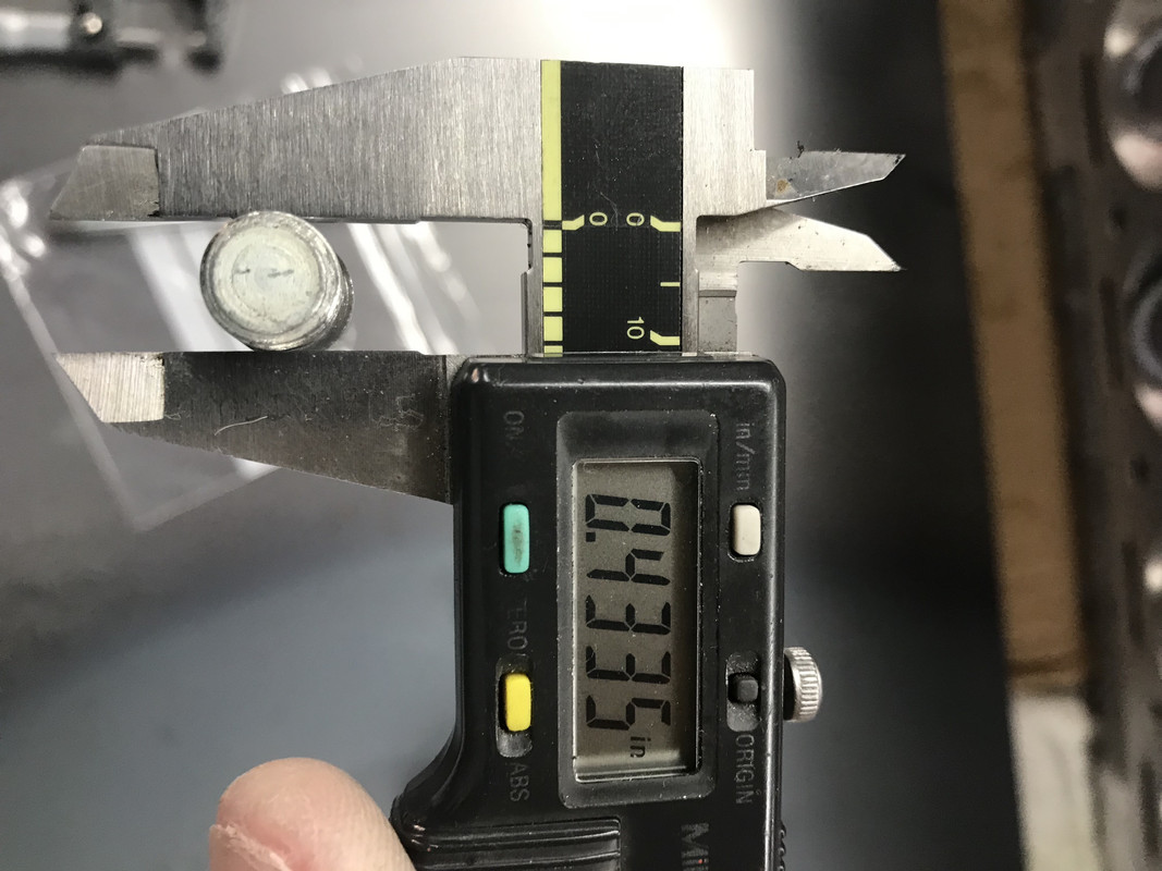

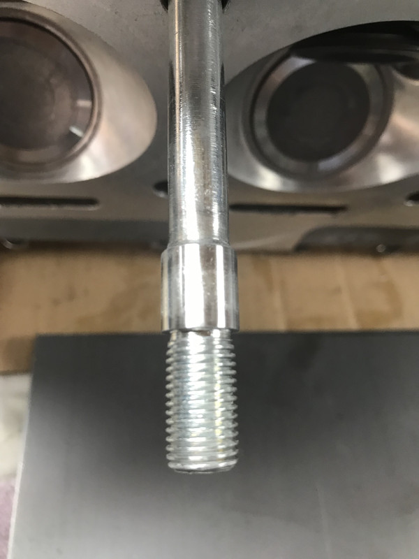

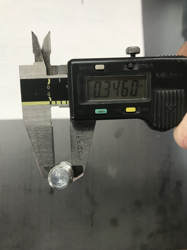

Spoke to SNGB and they are going to get their quality control to inspect the "C2270" cylinder head stud.
However, I have had success and after discovering Coventry Auto Components and speaking to Stuart there yesterday. He measured up both the shouldered studs that he stocks and we decided to go for his "8203" XK Cylinder Head Stud.
It arrived first thing this morning and after cleaning up the plating with some p2000 grade paper it is a perfect fit into the cylinder head.
Also, The thread for locating into the block is perfect too. The following photos show the proof....
Coventry Auto Components "8203" stud.
Stud "8203" after cleaning off the plating with P2000 paper and now a snug fit.
C2270 stud on the left and notice the tapered waist, with "8203" on the right. Surely this tapered waist will affect the studs strength ??
waist measurement of Stud "8203"
against tapered waist diameter of Stud C2270
Outside thread dia of Stud "8203"
against Outside thread dia of Stud C2270
and to which the Stud "8203" is now a perfect fit into the engine block, so hopefully this little episode for me is now over. :salute:
