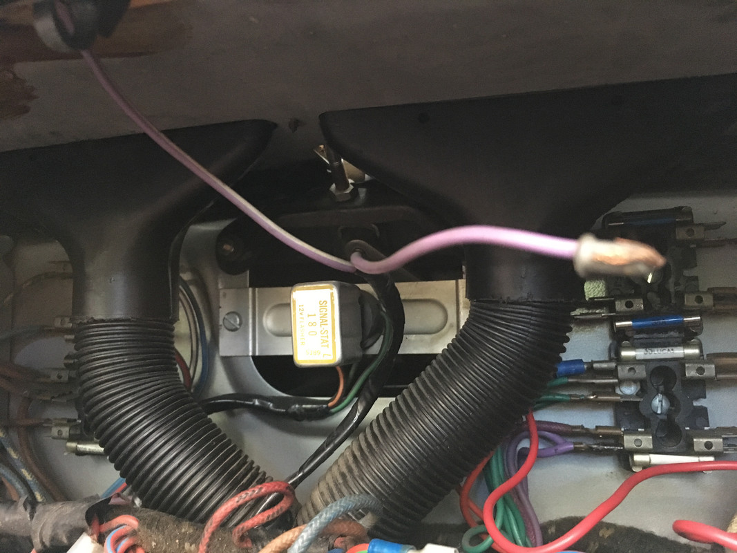

Still trying to figure out "glitches" on my 69.

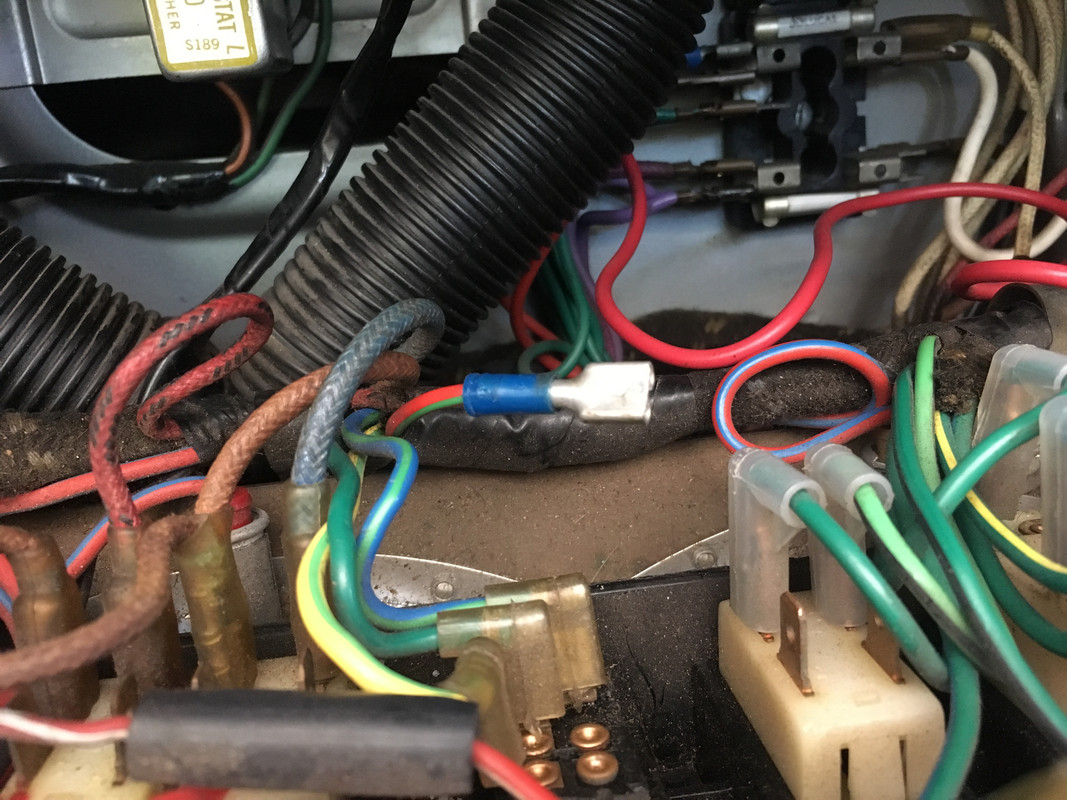

Can't figure out where the red wire with the green stripe is supposed to hook up (center of photo). It is clearly part of the wiring harness but it is not long enough to reach anything but the back of the wiper toggle switch. Also their is a purple wire (with a metal end that looks like it should plug in somewhere) that seems to be paired to a purple wire with a white stripe that is connected to the dash (see picture) - have no idea where it attaches.

Red/Light Green goes to the wiper switch terminal 4. Purple is the map light switch paired with Purple/White. So Purple goes to the map light bulb assembly, Purple/White goes from the other side of the bulb to the map light switch.
You can download coloured wiring diagrams from the Forum Knowledge Base.
