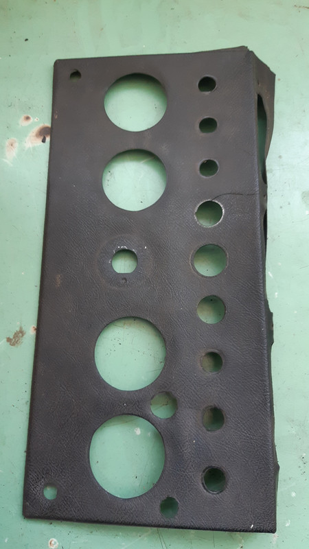

I need to replace the plastic covering of central instruments panel. It's like black vinyl but I don't found It. Does anyone know where I can find it?

I had to remove the original covering because a switch was installed on the panel. In fact you can see the not original hole in the shoot. I then removed the instruments, removed the coating and welded the hole.
I bought the vinyle from Aldridge but it wasn't good. On the back it had fabric that made it very thick and not able to be glued to the metal.
I wish I could use the original cover but it has a hole and I don't think it's a good result to fix it.

Hello, Is that a tear in the covering about mid panel? My covers were intact. I refinished the left and right dash panels on my 70 FHC. The original material had pulled away from the metal backing in several areas. It was very stiff. I used a heat gun and it became very pliable, even around the curved portions. I cleaned the surfaces with 3M adhesive remover; coated both the metal and back of the covering with DAP Wildwood contact cement and let set for about 15 minutes; heated with heat gun; pressed together and held tight with several clothes pins as clamps. This secured the cover to the panels very nicely.
Then I washed the covers with SEM Soap 39362. I deep cleaned and softened the vinyl with SEM Vinyl Prep 38343. Next SEM Plastic Adhesion Promoter 39863, then applied 3 light coats of SEM Color Coat Flexible Coating 15242 Satin Black. 3 coats were enough to provide good hiding. More or less may be needed.
I understand you are going with new cover material. Maybe this information will help you put it together and others who are repairing the original covering.
