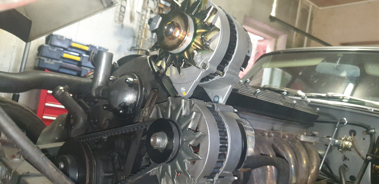

A picture search of the offending noisy alternator produced many alternatives, So I thought I would take the plunge. Look what arrived for £50 all in from Hella (Timefit remanufactured) (below).
Spot the difference, the dimensions are identical. The one on the top £50, one at the bottom £250. It was the one at the bottom that packed up.
The wiring on self regulating alternators requires you to bypass the regulator. This is two minutes work for the novice with insulation tape and a spade connector. No wires need to be cut, it is simpler.

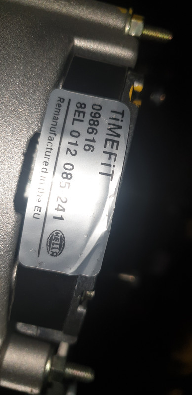

It is a Hella 8EL 012 085 241
098616
To fit it requires the center black block wire in the ACR plug to be pushed out, disconnected and insulated safely.
I also requires the two large spade plugs on the back of the alternator to be safely tucked away like this.
It bolts straight onto the e type brackets, you do need to check the pulley alignment with a straight edge as normal as they seem to vary. This is a case of using a straight edge on the drive pulley out to the alternator and making the adjustment with washers. It is pretty basic stuff, but worth checking.
