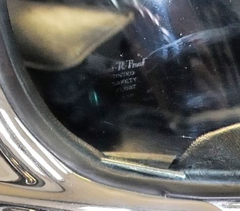

It's amazing how something will crop up on one of the forum posts that triggers something in your brain.... This is the etching on my front windscreen..... there's more than one of us out there with a tinted Shatt-R-Proof windscreen! This is on our '64 3.8 OTS.
I'm wondering if these could have been a dealer fit "upgrade" in export warmer climates. My side windows are not tinted but, being a California car, having the windscreen upgraded would make a lot of sense. It's certainly old since I can see the beginnings of delamination at the top edge. I'll have a closer look at it next time to see what the fainter markings say.

#10 Re: Decoding Triplex glass numbers ?
Post by Durango2k » Tue Apr 02, 2019 8:22 pm
My car lived in Georgia. Would that qualify for a tinted front screen ?
I can however hardly see a Dealer Upgrade. Any dealer would have asked whilst taking the order, so that the factory would deliver as requested.
Maybe another way round:
option a- only full tinted was available, all 6 glasses or it was clear all round otherwise. Then, if changing just the front screen would have been a lot cheaper, they might have done it that way.
option b- after a shattering OR after the owner‘s missus was angry enough because the damned british thing was sooo lousy hot in summer, the windshield was later exchanged on special order.
Carsten

#11 Re: Decoding Triplex glass numbers ?
Post by Philk » Tue Apr 02, 2019 9:20 pm
Georgia would probably qualify!
Mine is a roadster with two original clear side windows so it was not a factory order with tinted glass. If it needed replacement due to breakage, I would have expected the replacement to have been clear too. As such, I wonder whether this was a local US upgrade (either with its first owner or a subsequent one) which would tie in to your "option a" above.
