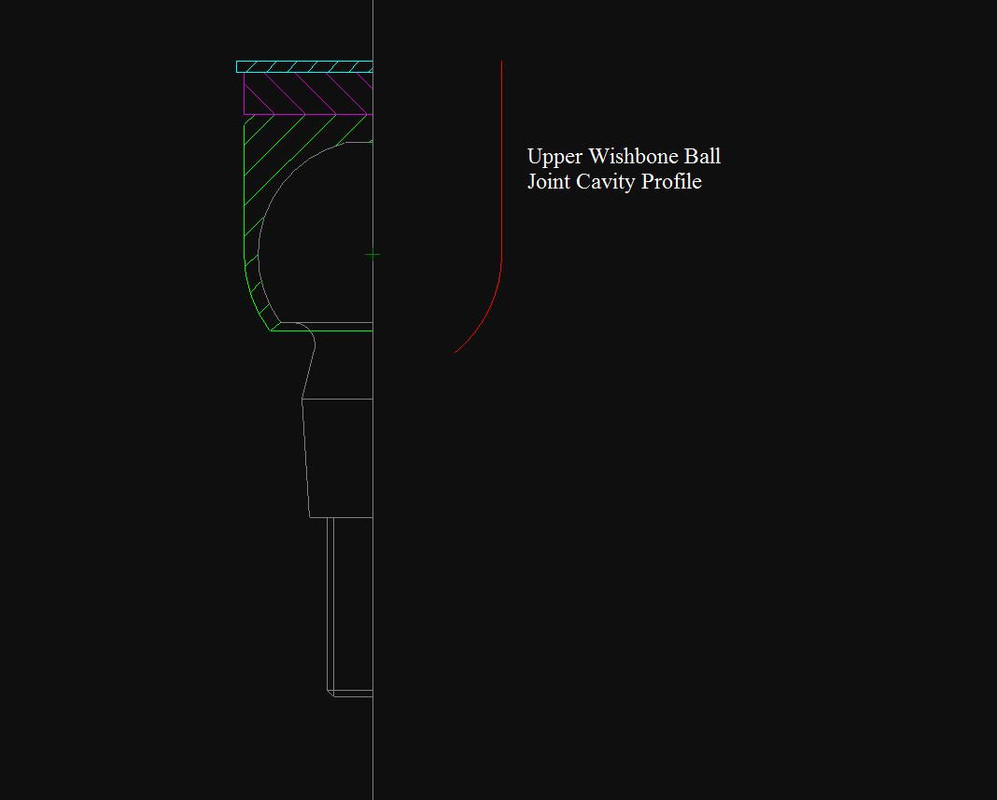

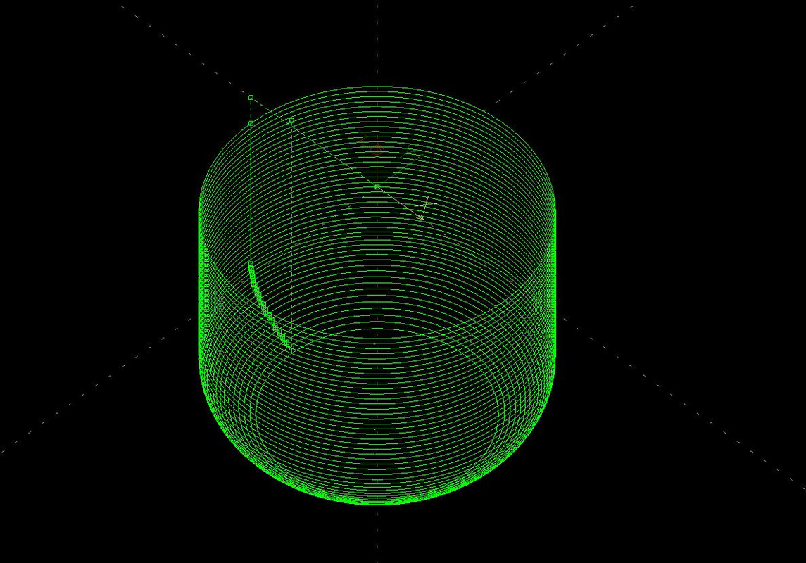

No amount of shimming will rectify the Top Ball joint system if the spherical pocket is severely worn (often the case). SNG Barratt (and I suspect others) supply an upgraded Top Wishbone that utilizes a Nylon Bearing sabot and a larger diameter Ball Pin. There are firms that will machine your original Wishbones to accept the Nylon Bearing system and supply them back to you with the new system fitted. I provide this service, but I'm quite a long way from you. The attached pictures shows the general layout of the Ball Joint/Sabot arrangement and a CNC Toolpath model of the machining required.
