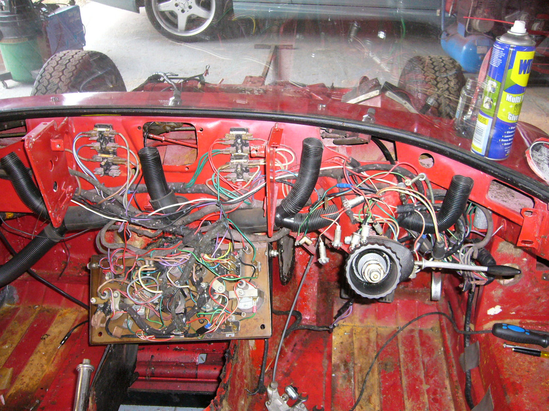

Tony : the screen is not all that difficult to remove, particularly on an open car ; however, refitting it can be more troublesome, and it is probably worth getting someone like autoglass to do it, which they will usually do for a relatively modest fee . The screen washers are a bit if a bugger to get at, and from memory you will at the very least need to remove the dashtop , disconnect and probably remove the wiper linkage, in order to reach them
This pic illustrates the problem for you
