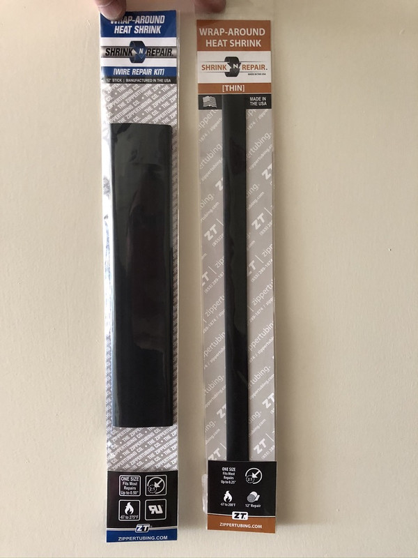

This might work - I have been using a wrap-around electrical heat shrink tubing that can be applied to a wire (or in this case the metal strap) while it is in place. The shrink-wrap has an adhesive edge which adheres to itself after application.
In this instance, if you cut some pieces of rubber or some other material to produce the needed thickness, apply the shrink wrap tubing and then give it some heat; this should shrink down and look good. It's worth a try. The product is called Zippertubing (photo attached), available online and comes in different widths.
Good luck and report back,
James
