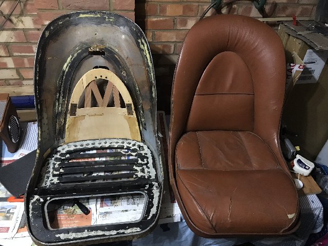

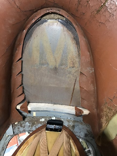

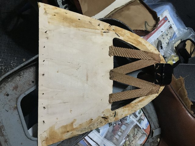

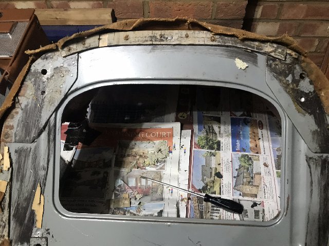

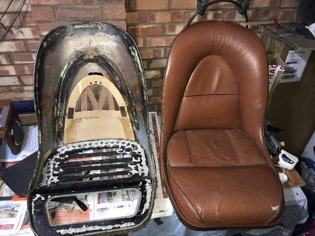

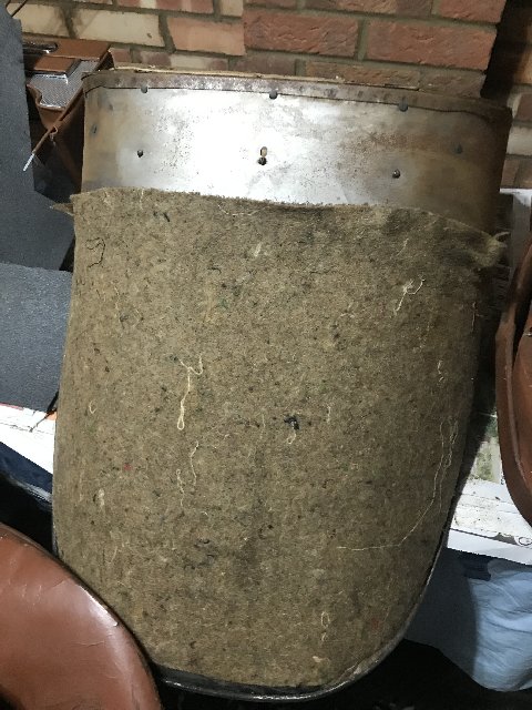

noli383 wrote:
Sat Feb 15, 2020 9:00 am
Incidentally I believe the factory only painted the lower area which is visible under the seat cushion & underside of the seat if removed. The “vertical” backrest behind the moquette etc. was left raw steel .... well, that’s what I found when I removed the trim on mine. I suspect this is factory correct as I also found the body number in crayon on the backside of the leather panels. Of course, I chose to paint the whole shell prior to re-trimming.
Noli, could you post some photos you have taken during dismantling? Originality is always interesting, even if one does not always follow this path.

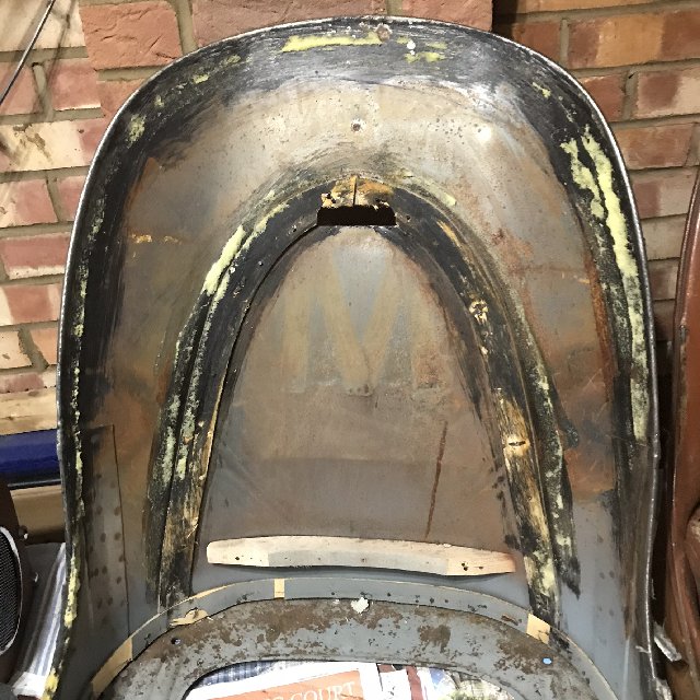

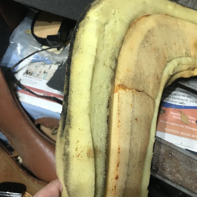

#9 Re: 3.8 seat frame colour
Post by rswaffie » Mon Feb 17, 2020 3:49 pm
MarkRado
Posts: 350
Location: Graz
Austria
#10 Re: 3.8 seat frame colour
Post by MarkRado » Tue Feb 18, 2020 5:09 am
Thank you Richard, perfect documentation!
1963 OTS 880436
Posts: 1655
#11 Re: 3.8 seat frame colour
Post by rswaffie » Tue Feb 18, 2020 7:15 am
No problem. There’s quite a few more if you need them - I photographed the entire strip down as I went along.
