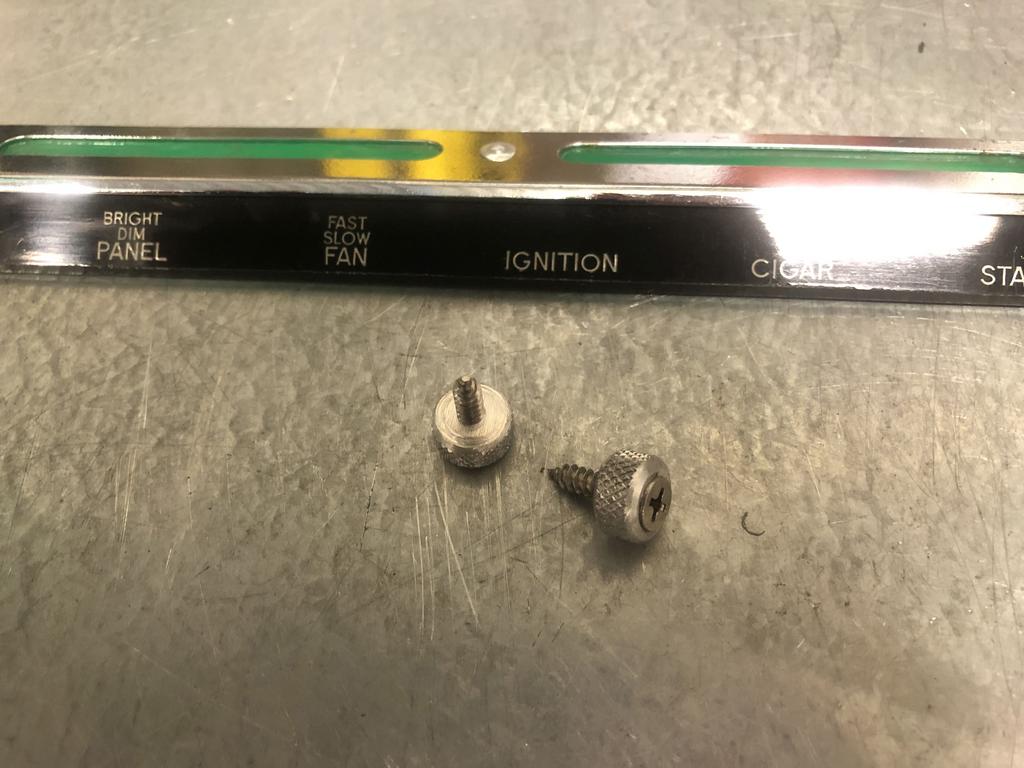

My trimmer may have been sniffing glue for over 30 years but he still has a few tricks.
To make folding down the centre dash panel easier, he puts rivets through the 2 central holes between the legend and the chrome strip and only fits the 2 outside screws. Remove these screws, remove the legend and you can fold the panel down without having to remove the whole centre console.
I have embellished this idea by making knurled heads for the two screws so they can be removed by hand. Works a treat!

I have used these very successfully for some time:
http://www.shear-loc.com/8thumbscrew.htm
I tapped the holes and put rubber washers on to make sure they did not vibrate loose.

Like David, I too have used the knurled thumbscrews . No need to drill or rivet the plastic, and the whole thing is off within 15 seconds, and can be replaced in about 30 seconds

I used plumbing washers with a selftapper, good grip and vibration proof.
After retriming my radio consol, I need to remove the strip, no worries.
