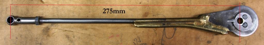

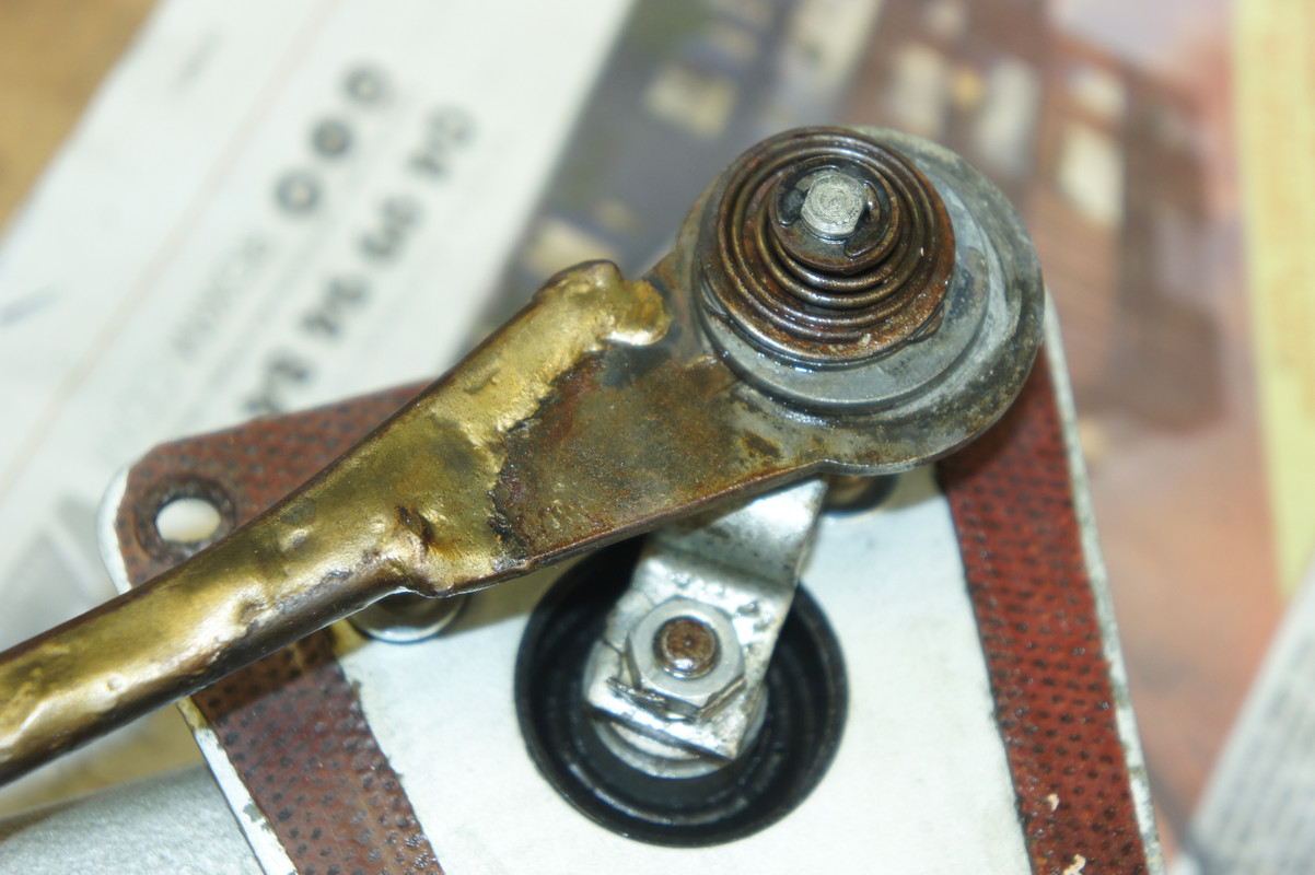

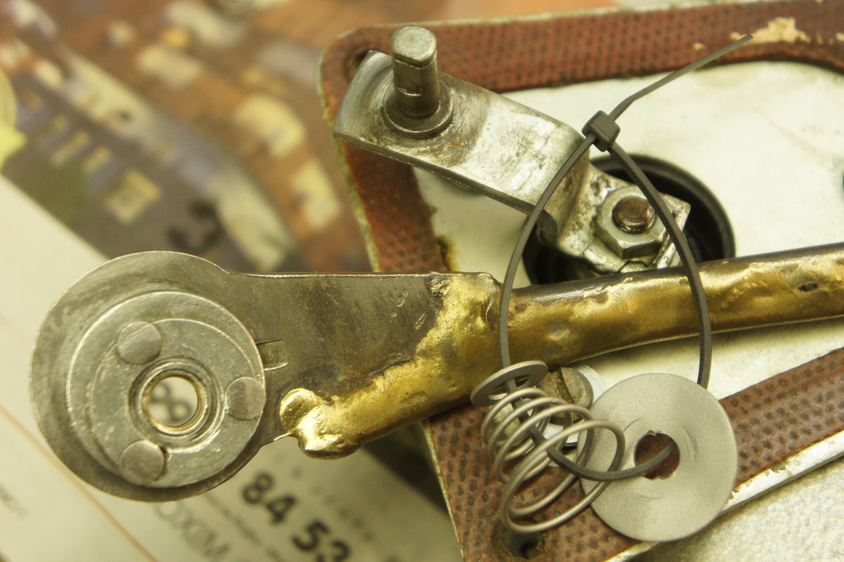

I have the guts of the windscreen-wipers in bits, motor works fine, so does all the mechanism as I overhauled most of it a few years ago, BUT I'd never had the primary linkage off, the first rod that is driven by the motor crank, until now.
Could anyone tell me quite what has been botched here, and suggest why ?
Is there an easy way (replacement part from another car ? available new ?) to get rid of the slop and wear that's present both in the centre bronze bush (which would be a bit of bitch to make/replace as the core is hard to get hold of) and in the interface between the eccentric core and the operating arm ?
Are these even E-Type parts ?!
It would make everything a lot quieter if I could improve this.

I'm inclined to think these are original parts, and that the brazed reinforcement is just a repair rather than an adaptation ?

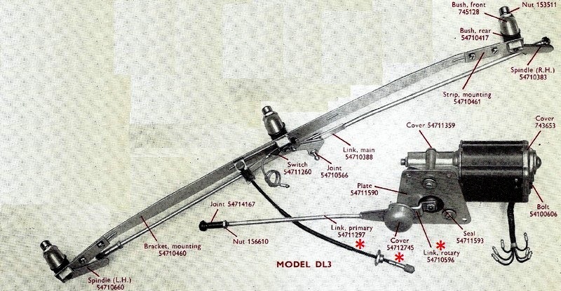

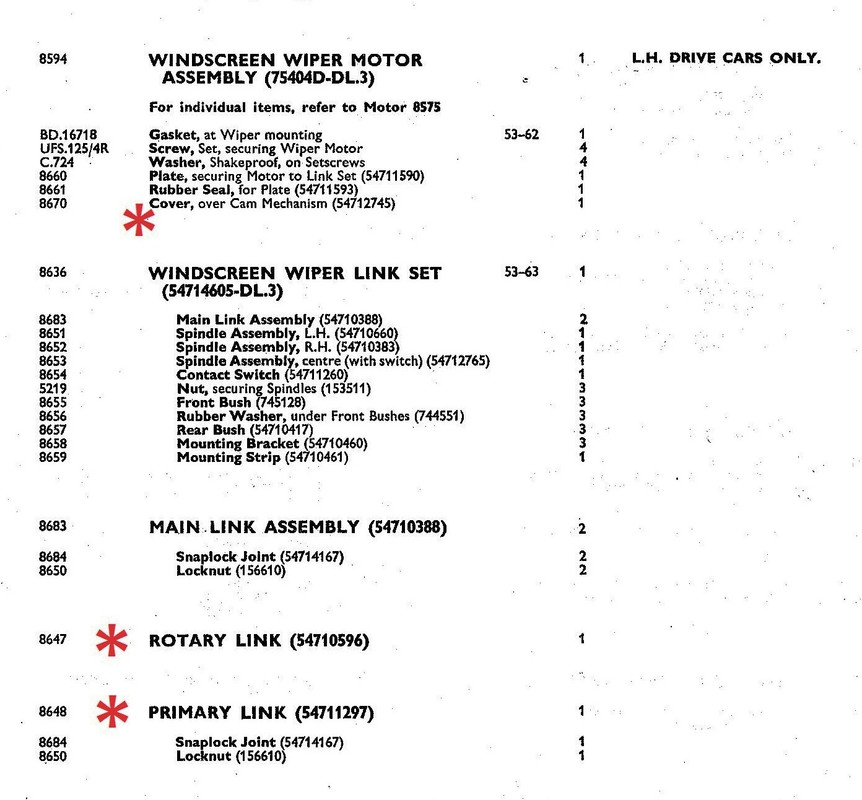

This picture
from the Factory Fit string suggests plausibly similar parts, complete with a cover 54712745 that would have protected the "eccentric" and its spring, and that I don't have ?
The "Link.primary" is 54711297, and the Link.rotary 54710596, all referred to in the J30 parts manual.
Has anyone ever overhauled / repaired /rebushed one of those Link.Primary, and do we know how many cars used this arrangement before it was replaced by something else ? I can't find any pictures of this mechanism, with the exception of Angus' shot when helping with a recent clip identification.
Furthermore, can anyone work out what this complexity was for, even ?!

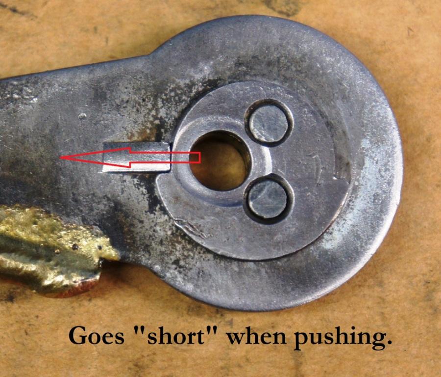

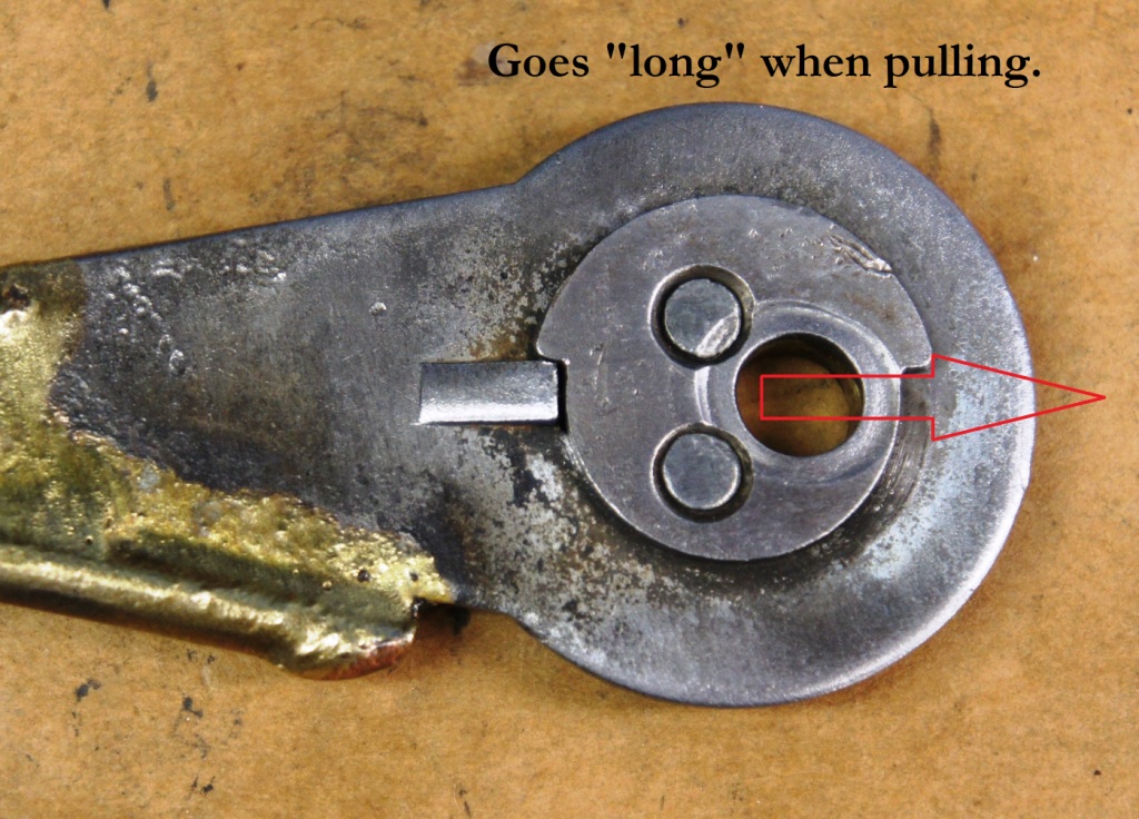

When pushing on the primary link, the eccentric adopts - initially - the path of least resistance, and the link goes "short" with an eye-to-eye of 275mm, and then when the effort goes to pulling on the link, the eccentric rotates to the other extreme and the link goes "long" to 284mm.
I've not mocked this up to examine closely what the consequences are, but it's fiendishly clever and is giving me headaches.
Something tells me it's to give the wipers a certain "pause" at TDC and BDC, as each time the eccentric rotates there will be a brief asynchronicity between the motor rotation and the wiper motion, maybe so they were easier to park ?
Edit : I'm wrong in this interpretation ; the fact that there is the conical spring maintaining a certain load on the eccentric, in fact it always adopts the same position when the motor is driving in one direction, and then adopts the other position only when the motor reverses to stop.

If you take the control rod /arm off the wiper motor you will find that it actually has an eccentric cam (i.e. the hole for the spindle is offset from the centre of the cam) built-in, with ‘stops’ that give it 2 possible positions.
When the motor turns clockwise the cam is forced against its’ stop in one direction, when it turns anti-clockwise the cam is forced against the other stop. Because it is eccentric, the effect is that the rod has a shorter overall length when the motor turns one way than the other.
The reason becomes clear when you realise that switching the wipers to OFF actually puts the motor into REVERSE. It is not until the limit switch gets to the end of its travel that the motor stops.
So this is the way it all works:
Wiper Blades are normally parked tight against the windscreen rubber surround so as to be out of the way.
Switch the wiper ON (slow or fast) and the motor turns one way, forcing the cam into a position which leaves the control rod at its ‘short’ length.
When the blades complete a sweep and come back down to the bottom of the screen this ‘short’ length means they stop well before the surround (to avoid hitting it) and continue the next sweep. The ‘finger’ of the limit switch never leaves the brass surface.
Now move the wiper switch to OFF and the blades will actually reverse their direction of sweep, back up to the vertical position. The cam is now thrown to its other stop, effectively lengthening the rod.
The extra length means that when the blades sweep towards the bottom of the screen this time they keep going until they touch the rubber surround. At this point the ‘finger’ runs off the edge of the brass plate and the motor stops.

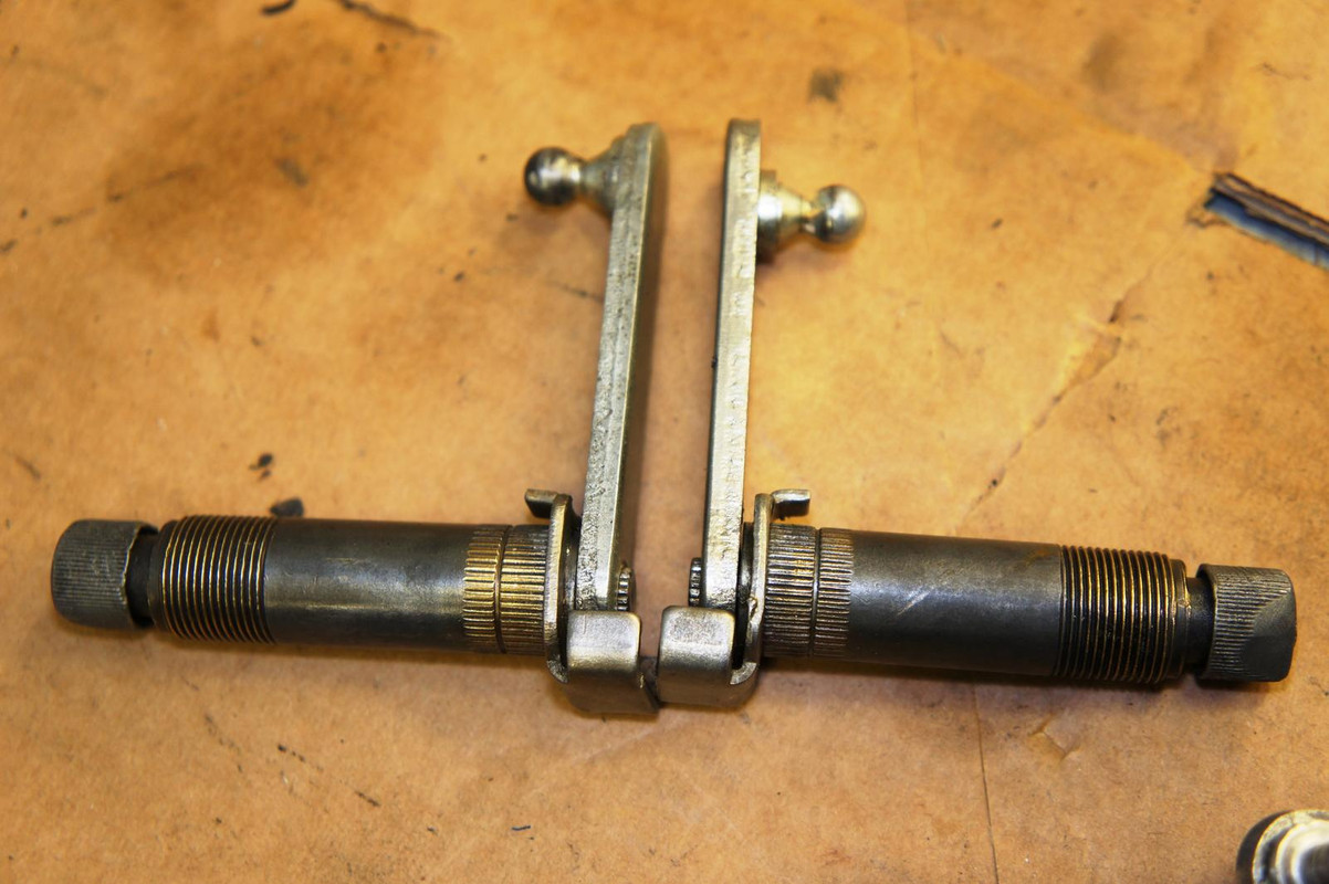

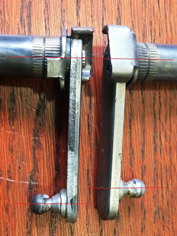

My next quandry is whether I have the correct outer wiper pivots - as the two I have have different lengths, which may well be some deliberate part of the sweep amplitudes but which is L and R escapes me, especially as it was me that stamped L and R on them.
Can anyone confirm that this is normal, and suggest which goes where ?
I also want to swap the splined turrets across to one worn wiper mechanism from another less-worn one. I'm aware that many have dismantled these in the past, if only for plating purposes (Chris Vine ?) but can't find any advice about how best to do it. I'm putting this question up as a separate post as it might facilitate others' searches when looking for the subject.

#12 Re: Wiper Drive Pimary Link, Eccentric, and Wiper Parking.
Post by 288gto » Sat Jan 04, 2020 8:01 pm
Hi Peter, Rory
The different lengths are for a reason and it depends if the rack is for LHD or RHD which end the odd one goes on. I know this from rebuilding and converting my rack. However I can’t for the life of me remember which end it goes. I THINK there is a reference to it in the Service Book.
It is to do with the far left or right?? wiper arm needing to perform a different arc.
Sorry Rory one of those answers that doesn’t give an answer! :roll:
Happy New Year by the way.

#14 Re: Wiper Drive Pimary Link, Eccentric, and Wiper Parking.
Post by johnetype » Sat Jan 04, 2020 9:11 pm
Simon, the service manual tells you what to do, it doesn't give you the reason why the longer crank has to be on the driver's side but as you suggest, it's to do with the arc traveled.
With the passenger side crank being shorter the wiper arm and blade will travel through a greater angle of sweep. The reason for the passenger side needing to go through a greater sweep angle is because it doesn't have another blade to it's left overlapping with it, so to ensure it clears as much of the LHS of the passenger windscreen it travels further.
On a three blade car, the driver's arm crank length and the centre crank should be the same, it's just the passenger one that's shorter.
If you do a LHD to RHD conversion and don't swap the outer wheelboxes over, it's not the end of the world you just get unnecessary overlap between the driver's wiper and the centre one and your passenger ends up short changed.

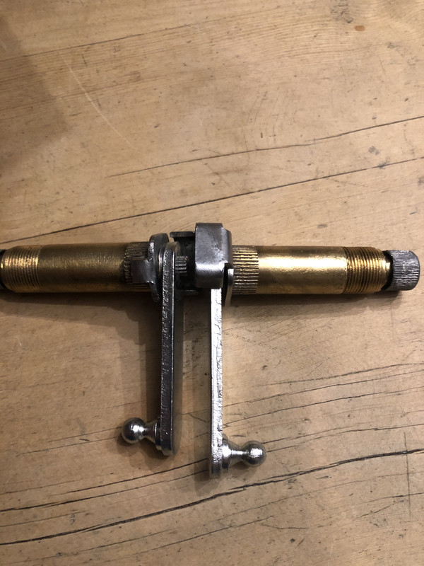

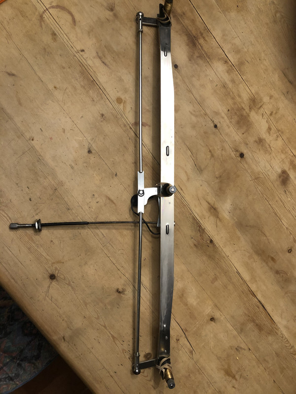

Post by Robbiee » Wed Jan 08, 2020 4:45 pm

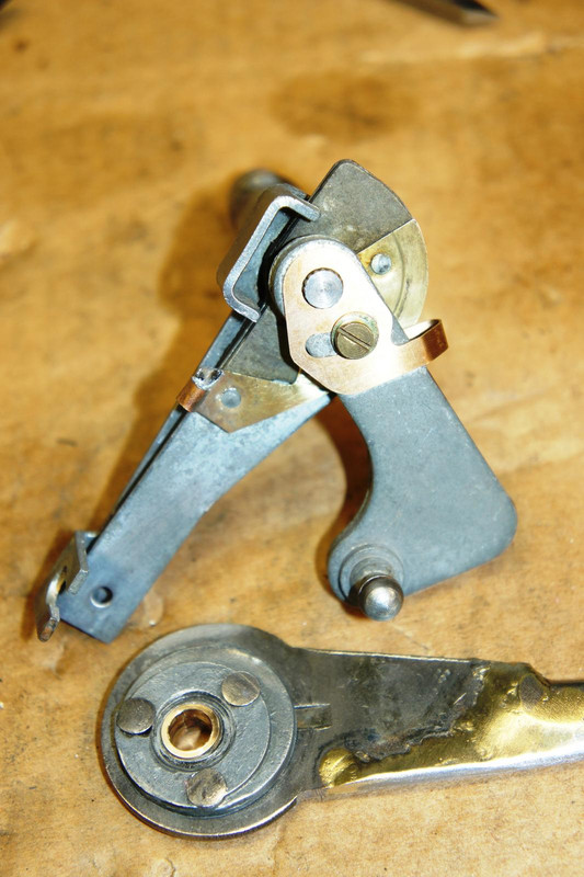

With respect to the spindle cranks...mine are different lengths for driver(longer) side and Passenger(shorter side) the ball joints being welded at the end of each, as opposed to some where the cranks are similar lengths put the effective shortening is achieved by the ball joint being welded nearer to the fulcrum.
See photos
