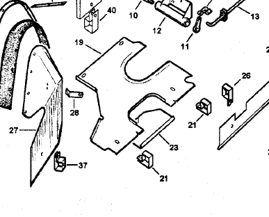

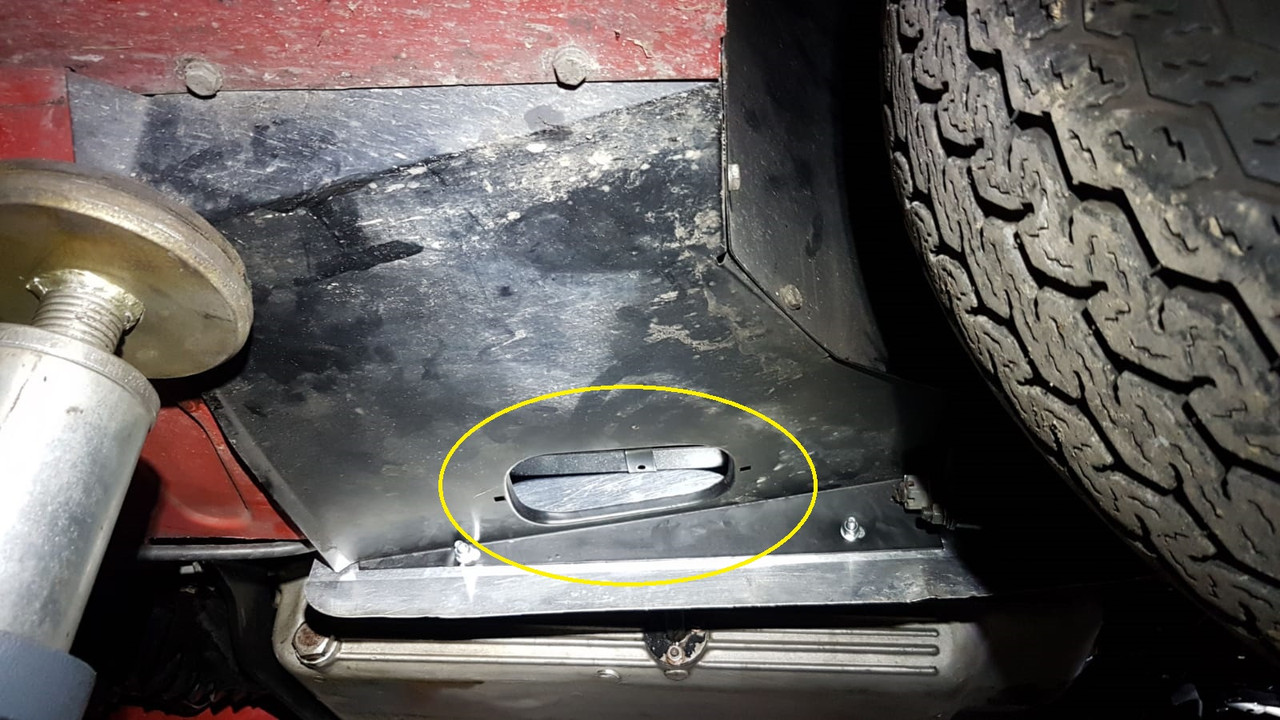

Could this panel on an e-type S1.5 be original?
The SPC for S2 (and S1) show the panel looking different:
Was the 1.5 special or this is home made?

Nothing but silence so I will give it a shot. Attachment bolts are non original. Cars before it and after it have a different type of shield. Therefore I would strongly suspect it is non original.

Same as in this thread....also fitted to my 69 2+2 viewtopic.php?t=14058

Could it be special to 2+2??
My friend's car is also a 2+2, late 1.5 car - 1E77309BW.
