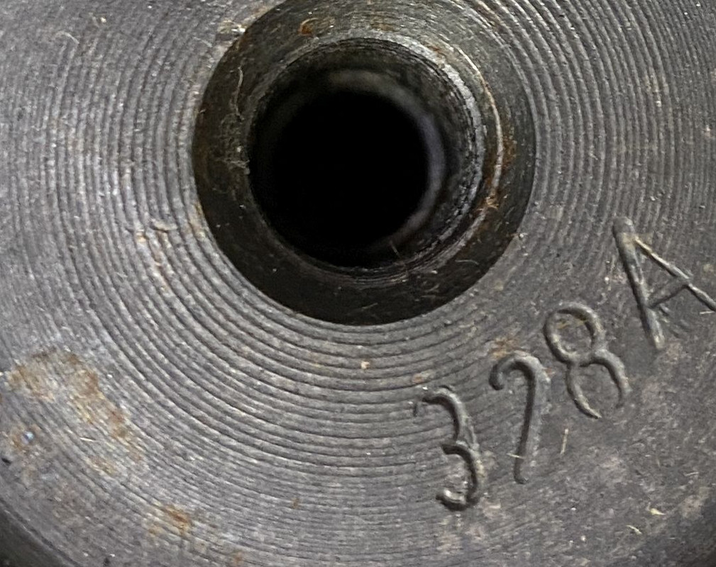

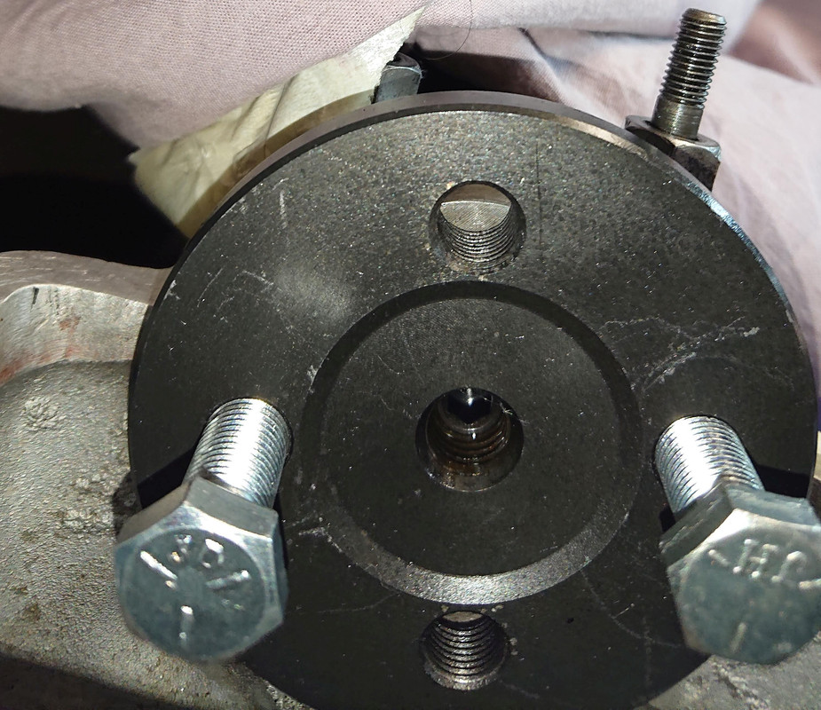

I am finally almost done assembling my head and am wondering if the plugs at the front of the camshaft should be installed.
The original ones do not have them, however the ones from Kent Cams do:
Kent Cams:
Original:

I've not seen plugs on the front of the cams. If Kent provide them though, I see no problem with fitting them as they can't fall out of they get loose.
I would however use the correct original bolts to fit the cam sprockets. They are a bolt with an unthreaded shoulder and so positively locate the sprocket. They are also drilled for lockwire.

Thanks Andrew,
The bolts are there just to turn the cam..
So, if the plug is not there, how was the system pressurized? Is the sprocket adjusting plate blocking the oil ??

Post by abowie » Sat Jan 04, 2020 12:47 am
I assume that the sprocket plate is tight enough, but I don't really know for sure. The other ends are plugged with either a bolt or the drive for the tacho generator.
I have 2 pairs of original S1 cams at home; they are not threaded. I don't have any later cams.
Here's a picture of two S1 car heads I did a while back; no plugs in cams.
I also have a pair of new billet cams, they are threaded and provided with a plug.
Hope this helps.
