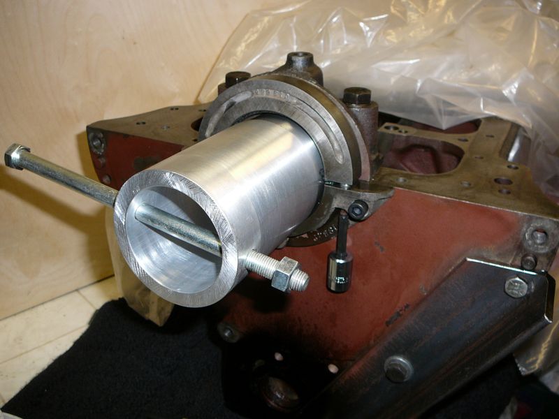

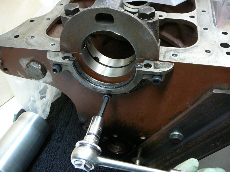

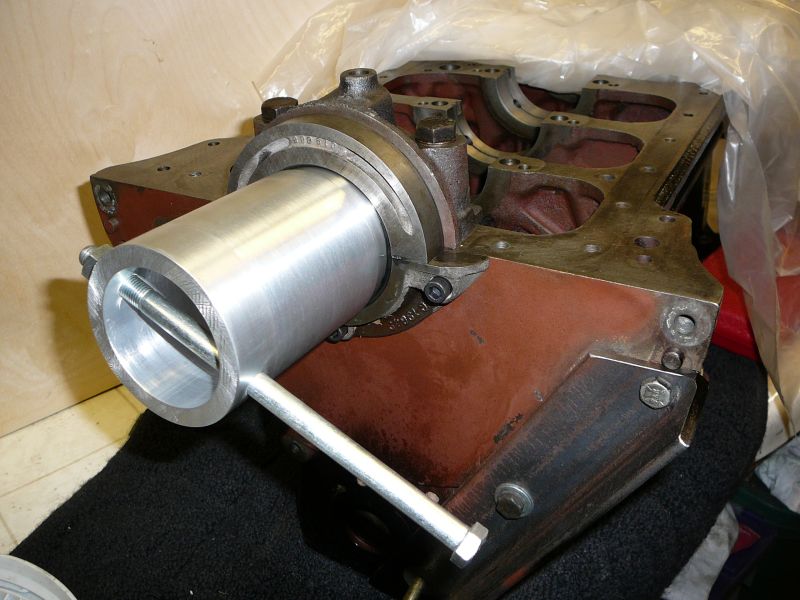

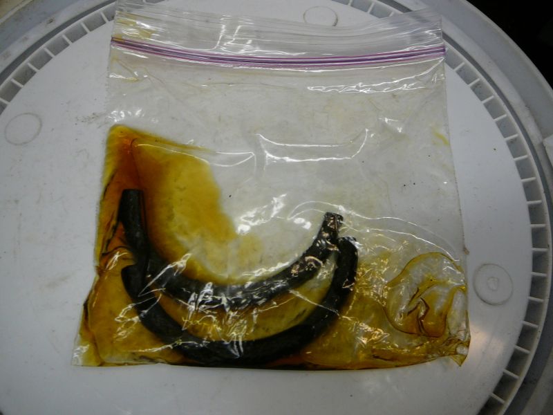

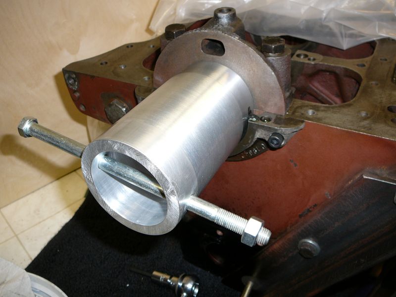

#6 Re: Rear rope crank seal
Hi Peter...180deg shaped...when rolled into each half of retainer approx 10mm protruding each end....My friend under advice from others rightly or wrongly cut them off with 3mm protruding each side....then sized them in(they were the white seal)......I searched quite a bit through the forum and there are other mentions of seals being too long but im not sure if this isnt just that thay havent rolled them in enough......I couldnt find much in the way of photo,s so found a few on line that might help others....Note on 4th photo down the seal retainer is just loose and tightened down a bit at a time........please feel free to ad more info to this thread re fitting a rear seal....Please note im not saying these photos show the correct way to proceed......but the service manual is a bit vague......Steve
