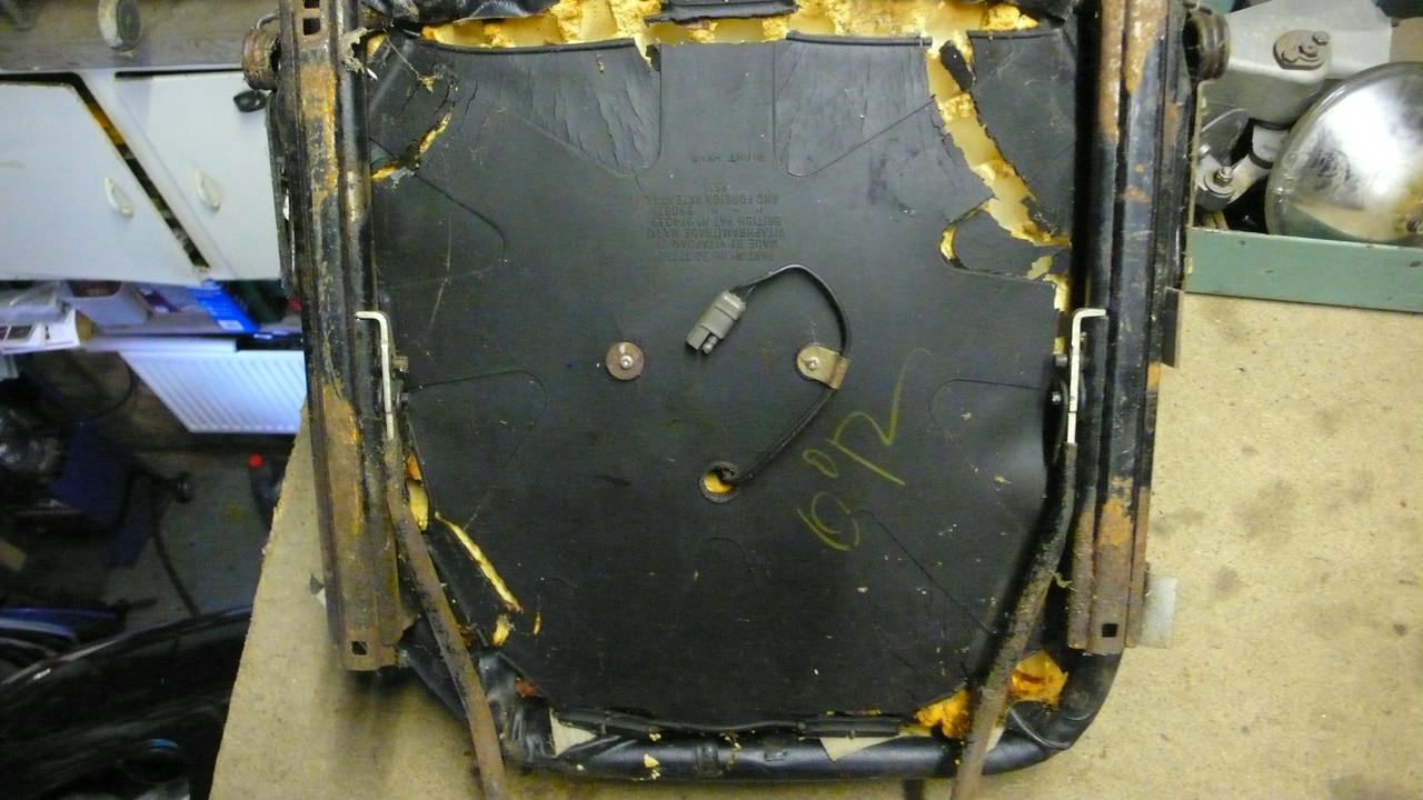

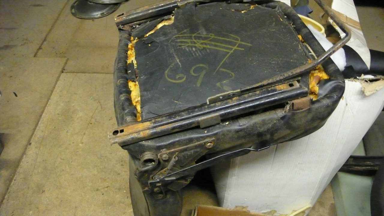

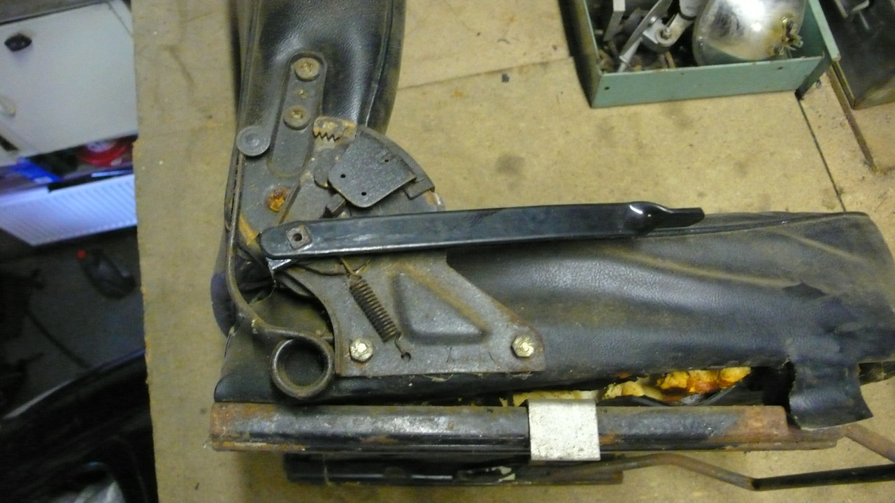

#10 Re: Mystery seats?
Post by dxke38 » Thu Jan 16, 2020 4:15 pm
I was hoping that someone would recognise the seats straight away and save me a lot of research, ideally that they were E seats and could have helped someone with their car resto. Many thanks for trying all. I thought I'd better take a closer look so I've just climbed up into the loft again. I'm not now so sure that they have been recovered in vinyl, they may be original. I've posted some more photos which show another surprise' When I checked the bottom of the righthand seat it seems to be fitted with an electrical connection, possibly for a heated seat. So it seem unlikely that that they were ever in an E type, unless somebody knows differently. Thanks again for comments.
Derek
Posts: 9128
#11 Re: Mystery seats?
Post by mgcjag » Thu Jan 16, 2020 4:21 pm
As i posted above....plus S3 seat diaphrams.....seat belt warning wireing
dxke38
Posts: 210
Location: norfolk
#12 Re: Mystery seats?
Post by dxke38 » Thu Jan 16, 2020 7:19 pm
Thankyou Steve, you're spot on. I had forgotten about the seat belt warning on later cars. With that and the strange recline levers and no facility for headrests due to the vinyl covers, it really baffled me. The annoying thing is that I have a Ser 3 but they looked completely different. Mystery solved.
Derek
