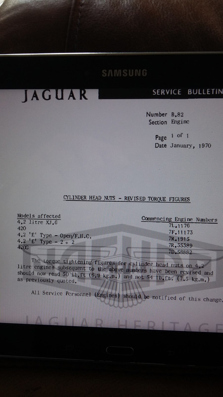

Hi Mich...service manual page B8 shows 54ftlb this was revised in a service bulletin...note engine numbers
